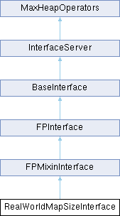

Inheritance diagram for RealWorldMapSizeInterface:
