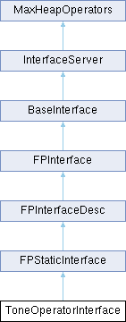

Inheritance diagram for ToneOperatorInterface:
