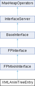

Inheritance diagram for XMLAnimTreeEntry:
