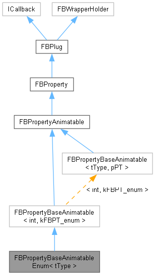

Public Member Functions inherited from FBPropertyBaseAnimatable< int, kFBPT_enum > | |

Public Member Functions inherited from FBPropertyAnimatable | |

Public Member Functions inherited from FBProperty | |

Public Member Functions inherited from FBWrapperHolder | |

Public Types inherited from FBPropertyBaseAnimatable< int, kFBPT_enum > | |

Protected Member Functions inherited from FBPlug | |

Static Protected Member Functions inherited from FBPlug | |
| static int | GetInternalClassId () |
| Internal class Id. | |
Protected Attributes inherited from FBProperty | |
| FBString | mName |
| void * | mParent |
Protected Attributes inherited from FBPlug | |
| bool | mAllocated |
| Contain the Allocation State of the Component. | |
| HIObject | mObject |
| Handle on the Plug. | |
| bool | mSDKComponent |
| bool Plug is an SDK component. | |
Static Protected Attributes inherited from FBPlug | |
| static const char * | ClassGroupName |
| ClassGroupName of the object. | |
| static int | TypeInfo |
| TypeInfo. | |
| static int | mGlobalTypeInfo |
| Represente the Type Index. | |
Definition at line 1787 of file fbproperties.h.
