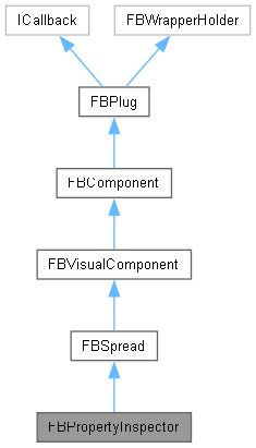

Property inspector class. More...
#include <fbuiutil.h>
Public Member Functions | |
| FBPropertyInspector () | |
| Constructor. | |
This class is used to inspect the properties of a component (including events) and display the information in a spreadsheet form.
Definition at line 67 of file fbuiutil.h.
