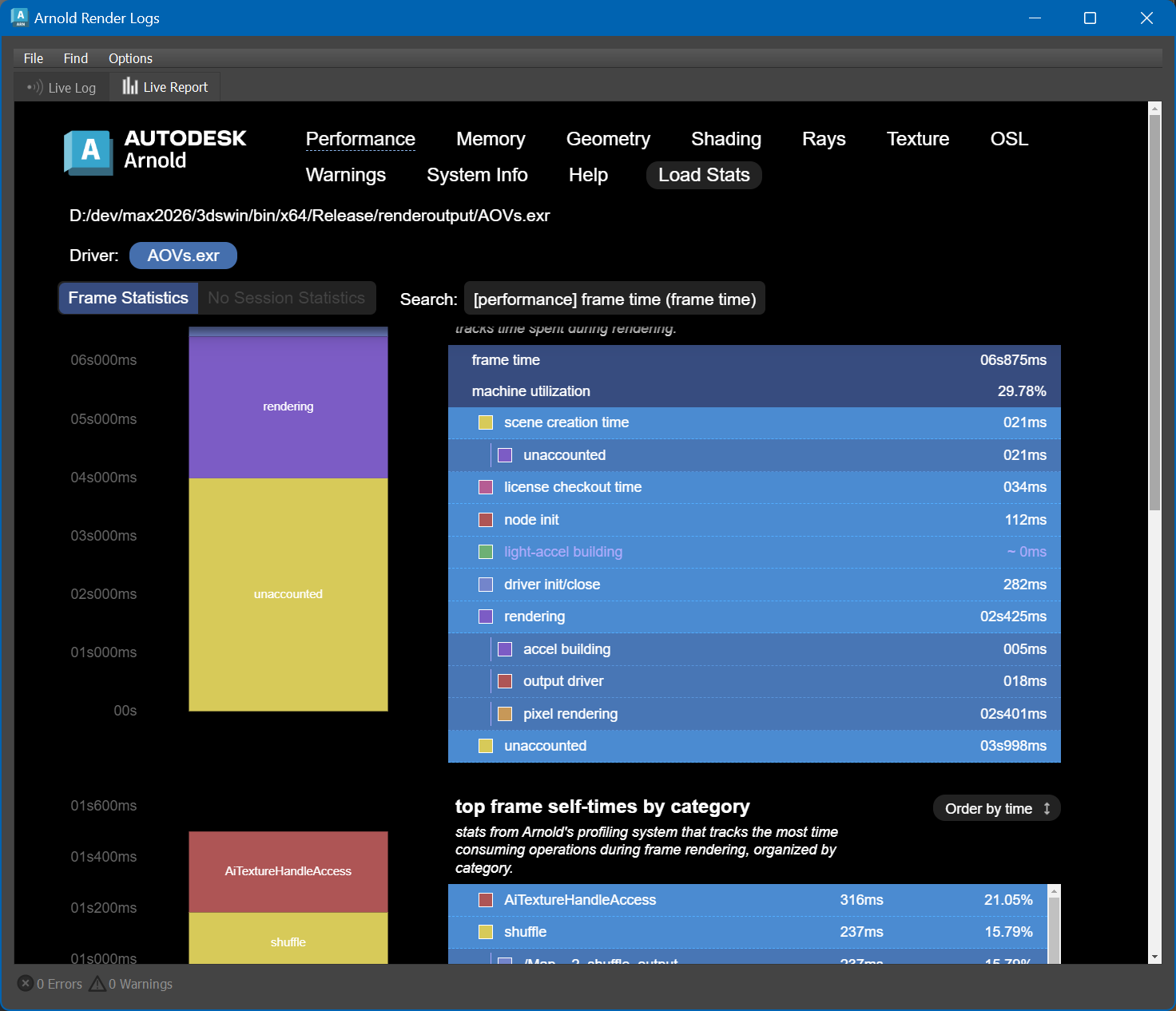

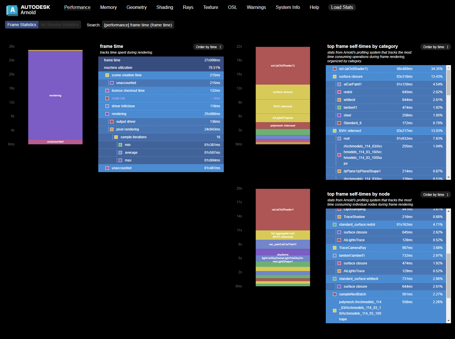

- Arnold for 3ds Max now includes live Render Reports in the Arnold Render View.

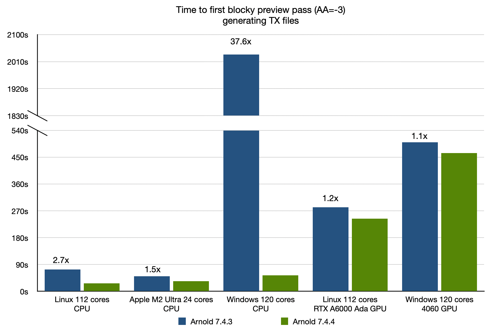

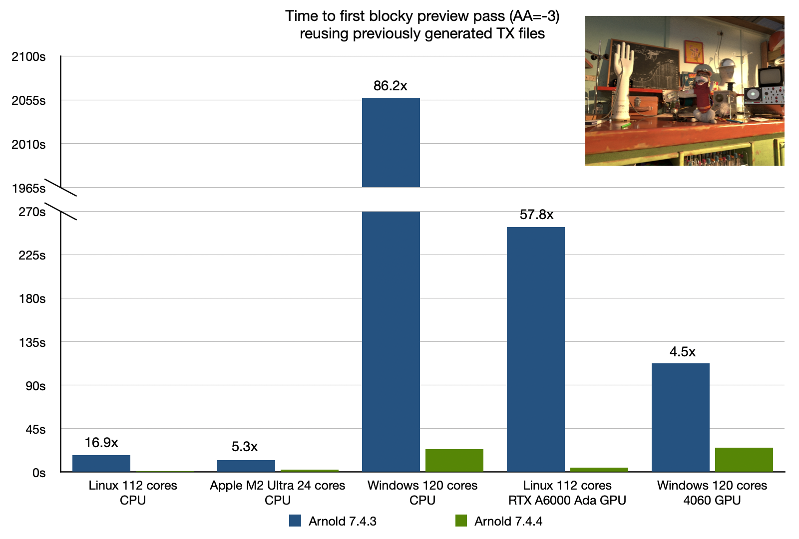

Improved performance when auto-generating or using existing TX files
Checking for existing TX files and auto-generating missing ones is now significantly faster, reducing time to first pixel when using texture_use_existing_tx or texture_auto_generate_tx. As the charts below show, speedups are most pronounced on many-core machines, particularly on Windows. (ARNOLD-13116)
| texture_auto_generate_tx speedup
| texture_use_existing_tx speedup

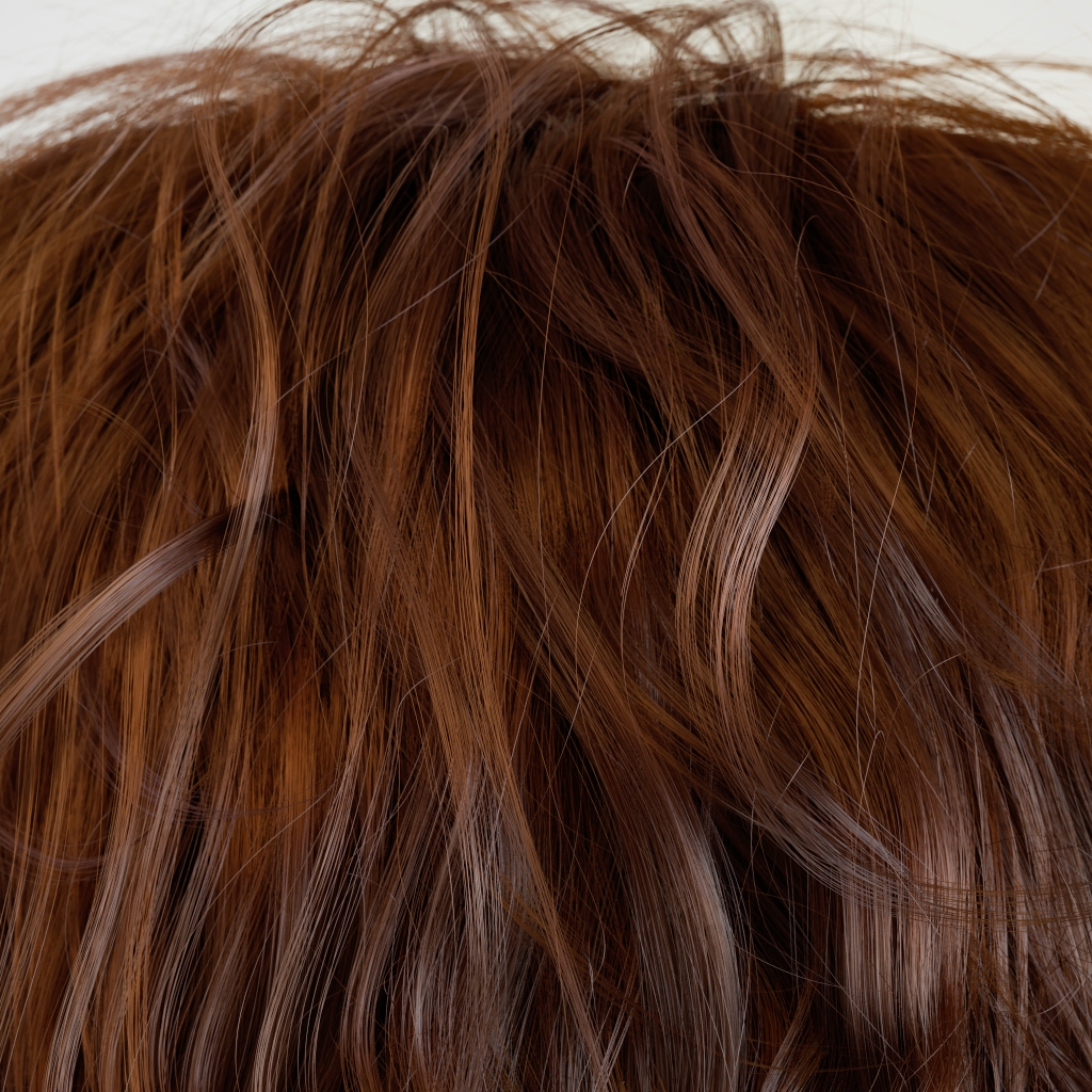

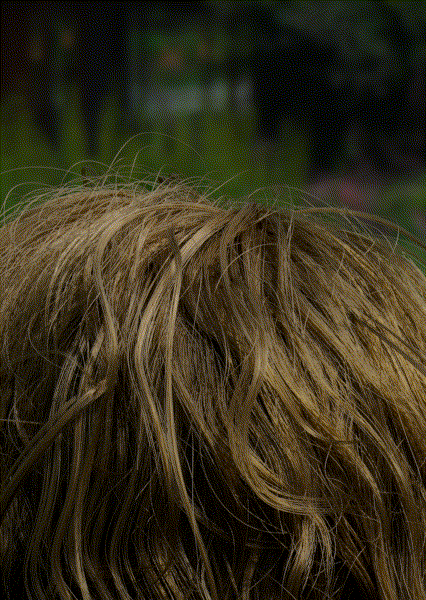

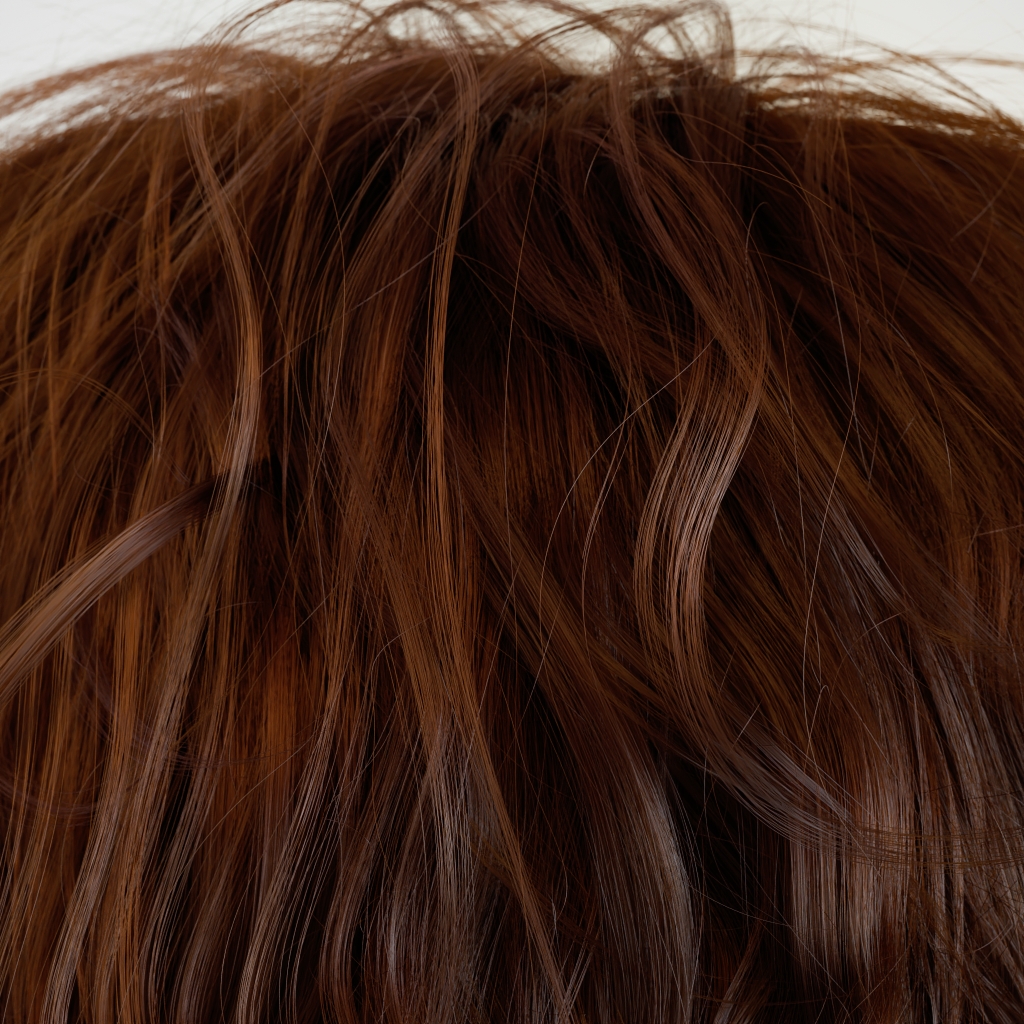

Scattering mode for standard hair
A scattering option scattering_mode has been added to the standard hair shader. Use the approximate mode to get the previous behavior. The accurate mode can be noisier, and so takes about 10 to 30% longer to render, but delivers more realistic results, especially in close-ups, by simulating each hair as a cylinder instead of flat surface. The adaptive mode uses the accurate mode for close-up hairs and the approximate for far-away hairs, automatically balancing quality and performance. (ARNOLD-16726, ARNOLD-16852)
| approximate
| accurate
| approximate (closeup)
| accurate (closeup)

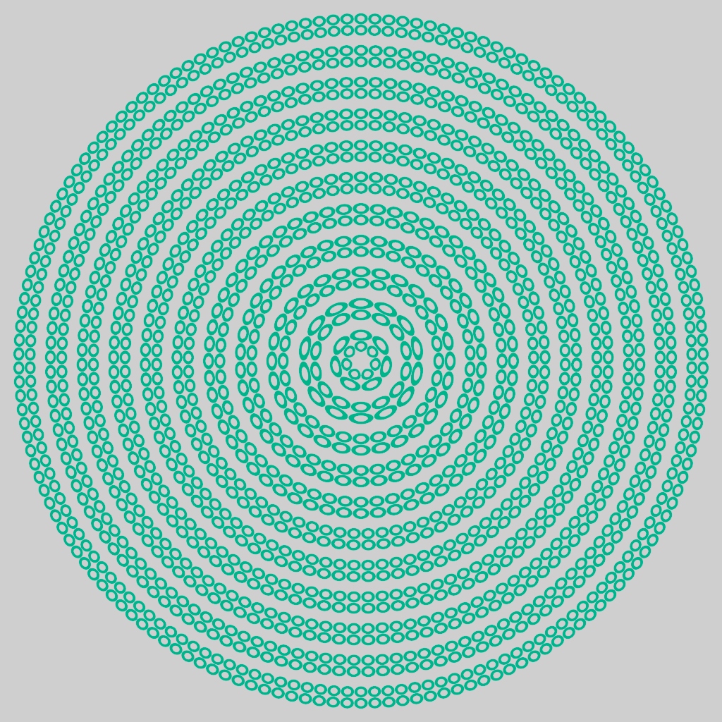

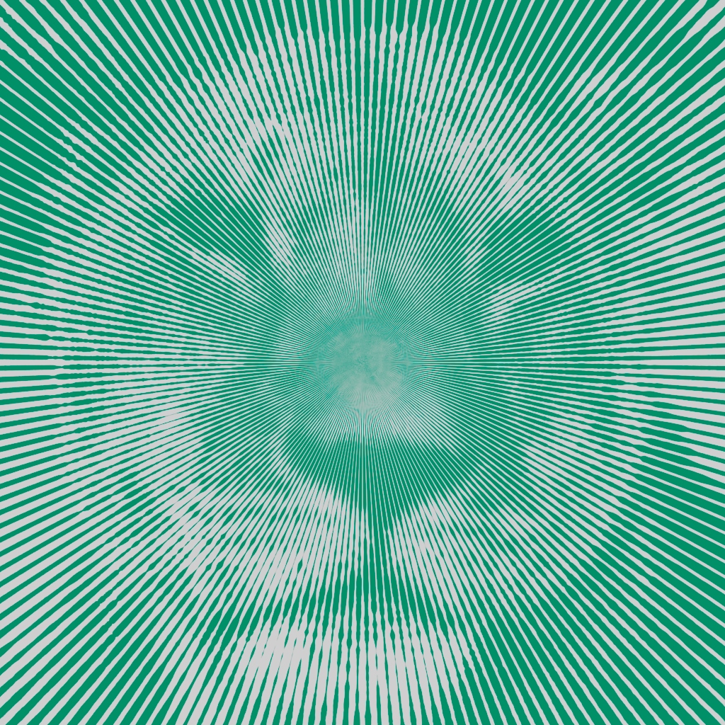

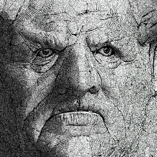

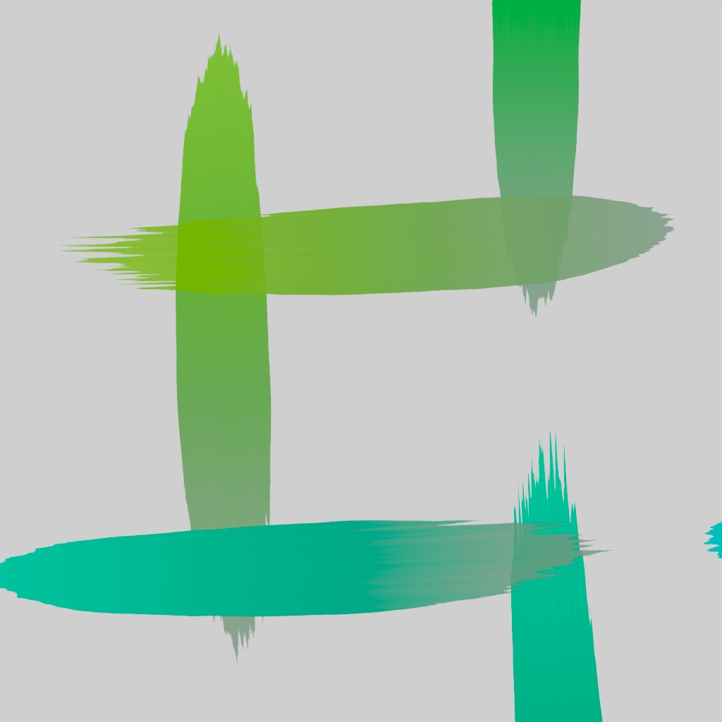

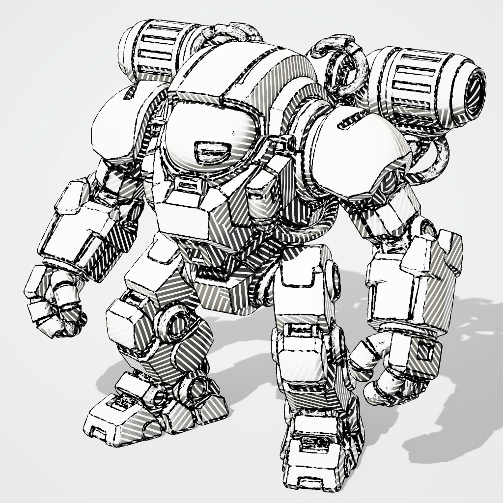

Line shader
| Line → UV Transform (screen space)
| Line → Triplanar
The new
line shader renders lines in various styles to create geometric patterns or brush-stroke-like textures when combined with noise and textures. You can generate complex hierarchical patterns by connecting line shaders together. We recommend using the line shader with
uv_transform. (ARNOLD-14976)

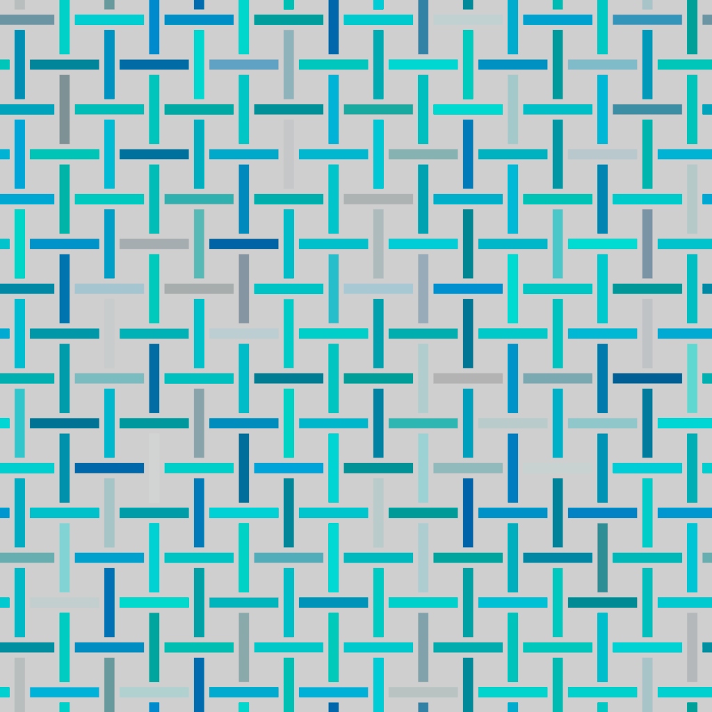

Space option in uv_transform
The
uv_transform node now includes a space parameter with texture (default) and screen options. The texture mode applies transforms to standard texture UVs as before, while the screen mode uses screen UV coordinates. (ARNOLD-14976)
| Texture (default)
| Screen

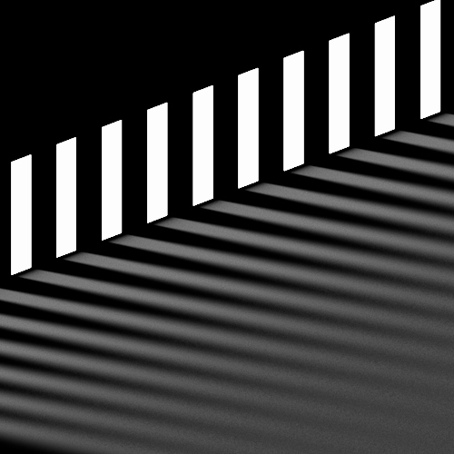

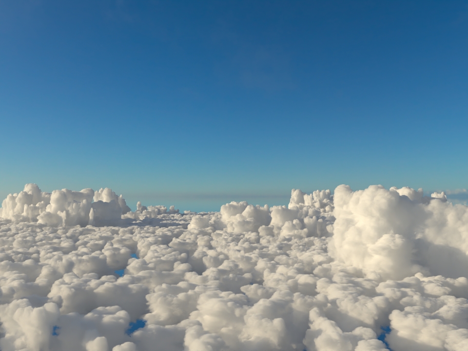

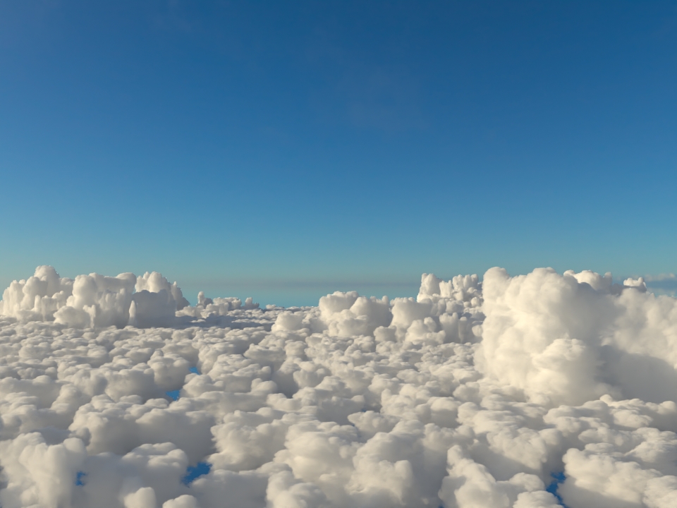

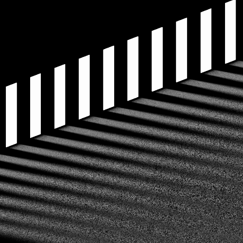

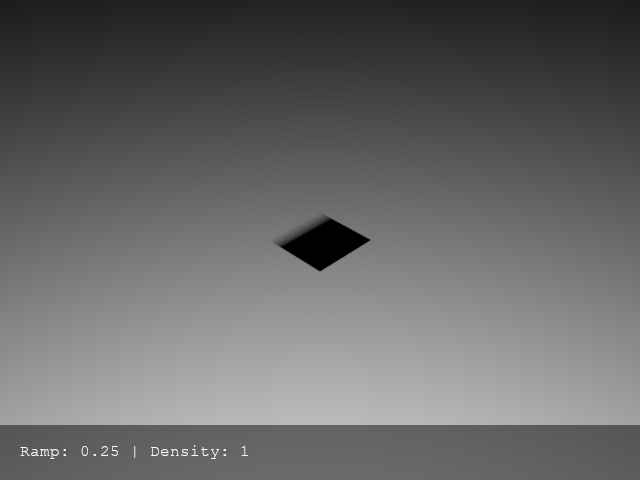

Light blockers with negative density
Light blockers with ramps and negative density values are now supported. (ARNOLD-16338)
| 7.4.3
| 7.4.4

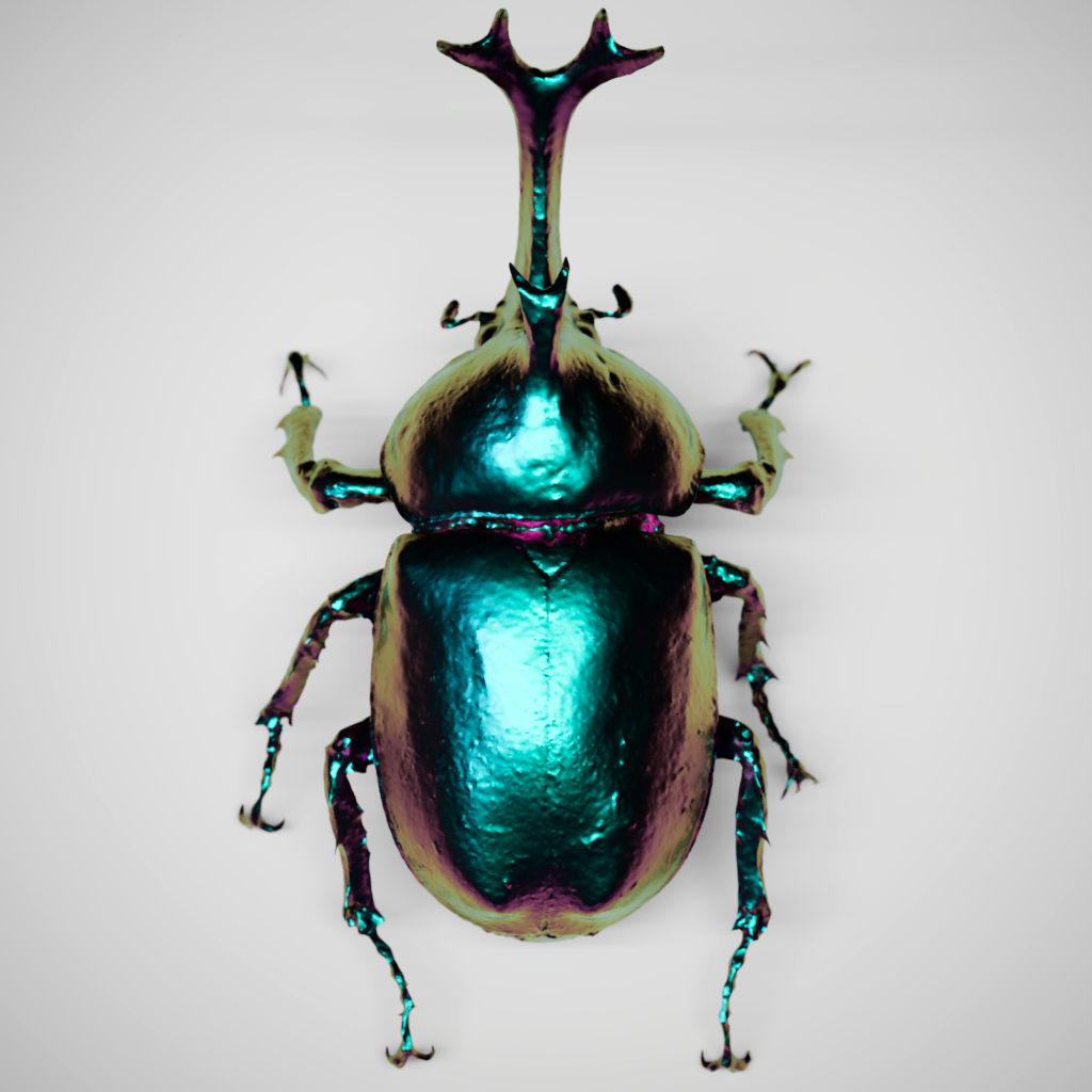

Bloom color dispersion
The
imager_lens_effect node has a new aperture_dispersion parameter, which controls the amount of color dispersion when in bloom_mode aperture. Increasing the dispersion value spreads the warmer colors further apart; decreasing it makes the colors progressively cooler. The default value of 1 gives realistic dispersion. (ARNOLD-16912)

- Arnold RenderView now has a Live Report tab: The Live Report is a graphical, interactive view of the Arnold log and render statistics. The Live Report updates as your interactive rendering updates. Click the Log icon in the Arnold RenderView toolbar to open the Arnold Render Logs window, and go to the Live Report tab. (MAXTOA-2017)

Render Reports
- Options node included in JSON statistics: The options node parameters are now written to the JSON statistics file, making it easier to understand what render settings were used when you analyze performance data. (ARNOLD-8558)
- Consistent unit rounding in Render Report: The Arnold Render Report now rounds values to a consistent unit, improving readability and comparability. Previously, different statistics could be displayed in mixed units (for example, sometimes in milliseconds and others in seconds), which made comparisons difficult. (ARNOLD-17036)
- Separate statistics for frame and session data: During interactive renders, Arnold now tracks two types of statistics: per-frame for individual frame renders and per-session for accumulated values normalized across the entire render session. The log outputs statistics for each frame in addition to the session statistics, while statistics JSON files contain the final frame statistics and session statistics. This separation helps a user analyze both the performance of individual frames and the overall render session. (ARNOLD-16735)
- Render Report: enhanced statistics visualization: The Arnold Render Report now displays both per-frame and session statistics during interactive renders. Additional improvements include stacked bar graphs for better visualization of these statistics and other user experience enhancements. (ARNOLD-16736)
