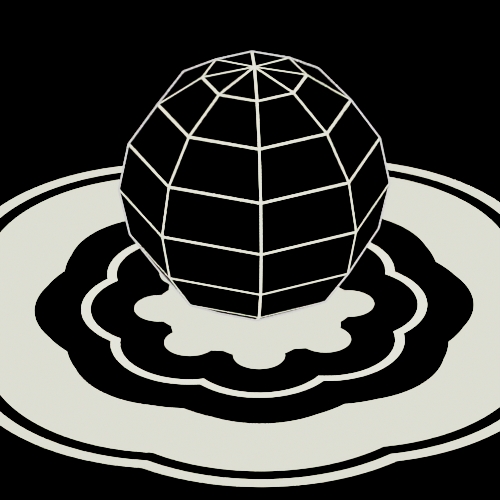

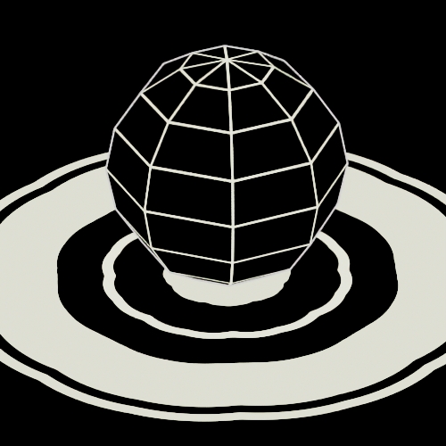

| Nearest Points distance -> RampRGB (custom) | Nearest Points distance -> Line -> Standard Volume transparent |

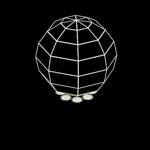

Max Points
Maximum number of points to find.
| 1 (default) | 5 | 20 |

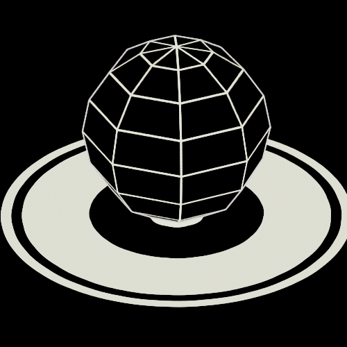

Search Radius
The maximum distance to look for the nearest points in the point cloud.
| 3 | 5 | 10 |
