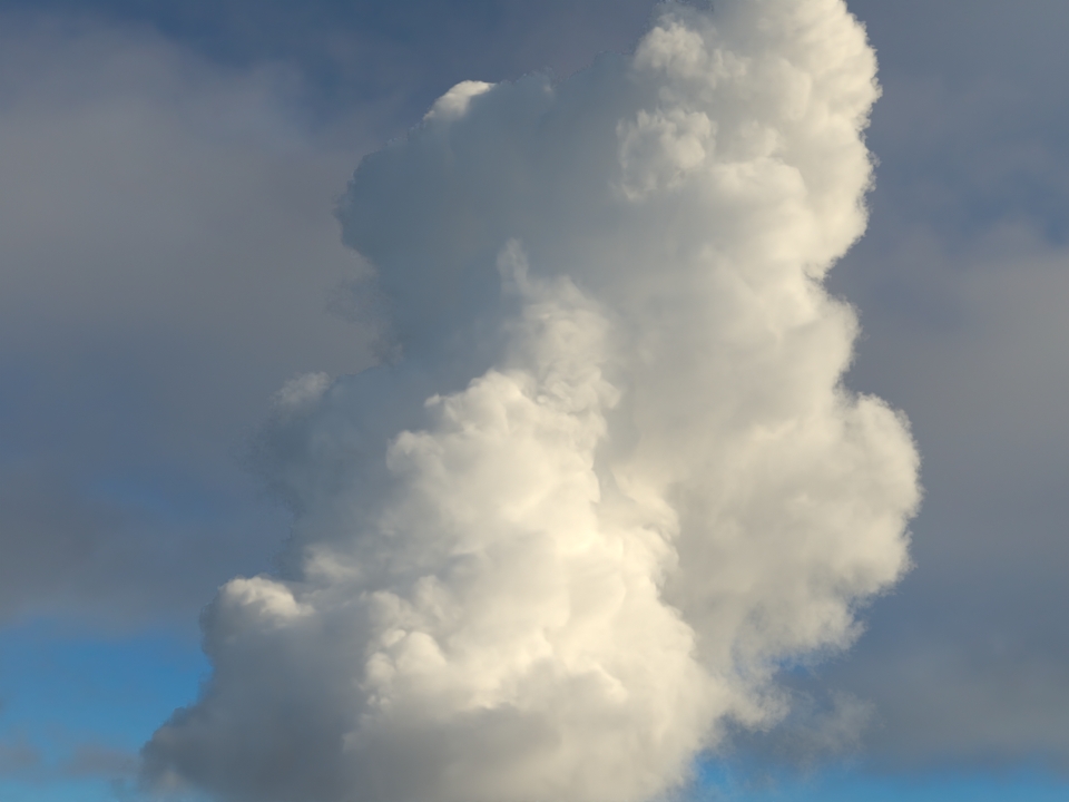

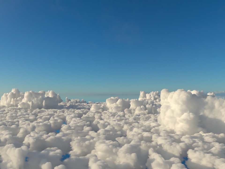

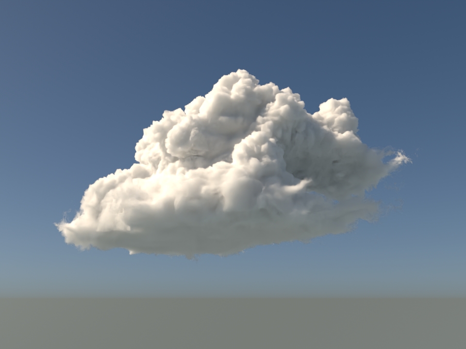

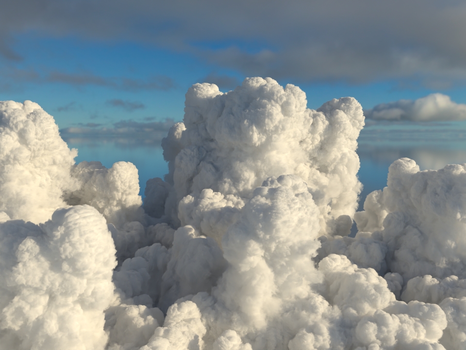

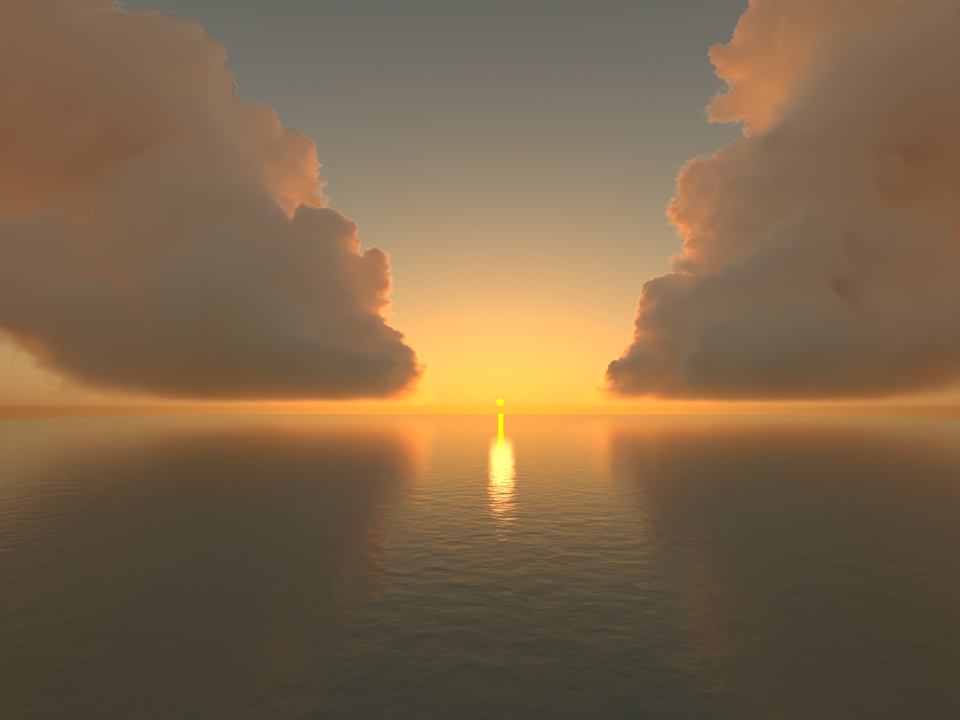

The volume node now accepts OpenVDB files with mip-mapped grids. The different mip-map levels are distinguished by _level_N suffixes, where N is the mip-map level. Arnold then automatically chooses the appropriate mip-map level during rendering, which gives substantial speedups in volumes with a lot of scattering (for example, clouds) in exchange for mostly small differences in look. Volumes with more mip-map levels can have larger differences in look. Users can also specify mipmap_bias on a volume node or on its instance (by declaring user data of the same name), which adjusts the automatic mipmap selection by that amount. (ARNOLD-14453, ARNOLD-15056)
You can generate mip-mapped volumes either with the Arnold API, or with kick. The Arnold API includes a new AiVolumeFileMakeLODs function. kick has a new -makevolumelods command-line flag. Both the API and the kick flag take three arguments: the input file, the output file, and the maximum number of levels to generate. The actual number of levels generated maybe lower than the number requested. (ARNOLD-16921)
| wdascloud | byc-cloud | composition 1 | composition 2 | sunset clouds | |
| original volume | ![]() |
| mip-mapped volume (3 levels) | ![]() |
| Speedup | 1.5x | 1.9x | 2.6x | 2.1x | 1.8x |
| mip-mapped volume (6 levels) | ![]() |
| Speedup | 2.0x | 2.8x | 5.2x | 3.2x | 2.7x |
GPU rendering of volumes is up to 3.5x faster. (ARNOLD-8936)
| Speedup | 2x | 1.12x | 3.7x | 3.5x | 1.31x |

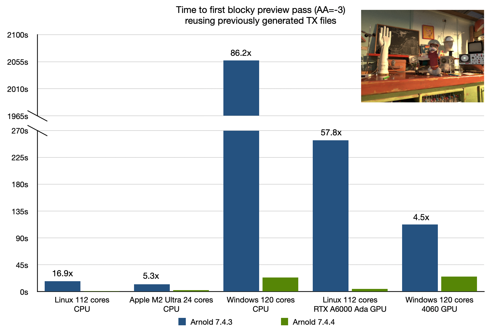

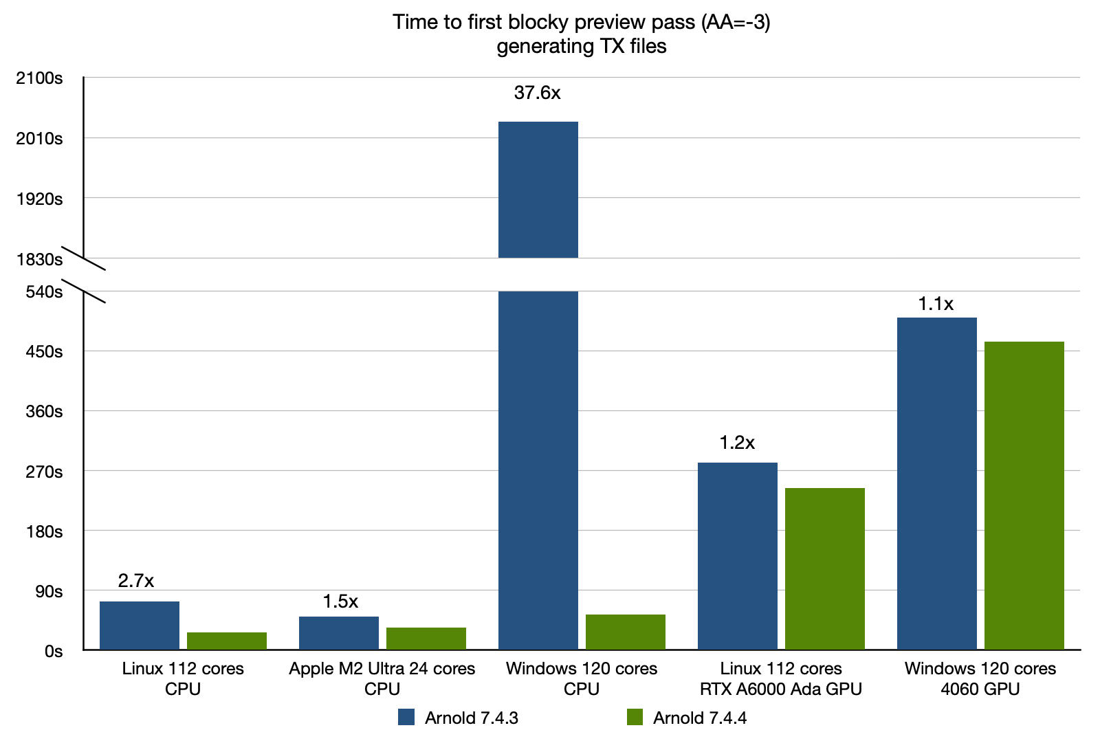

Checking for existing TX files and auto-generating missing ones is now significantly faster, reducing time to first pixel when using texture_use_existing_tx or texture_auto_generate_tx. As the charts below show, speedups are most pronounced on many-core machines, particularly on Windows. (ARNOLD-13116)
| texture_auto_generate_tx speedup | texture_use_existing_tx speedup |

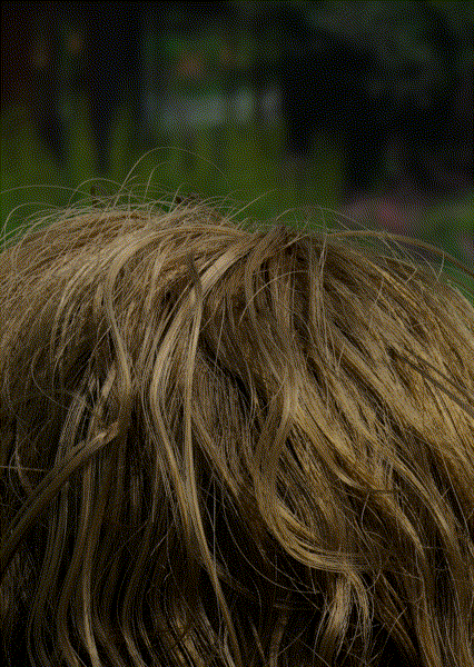

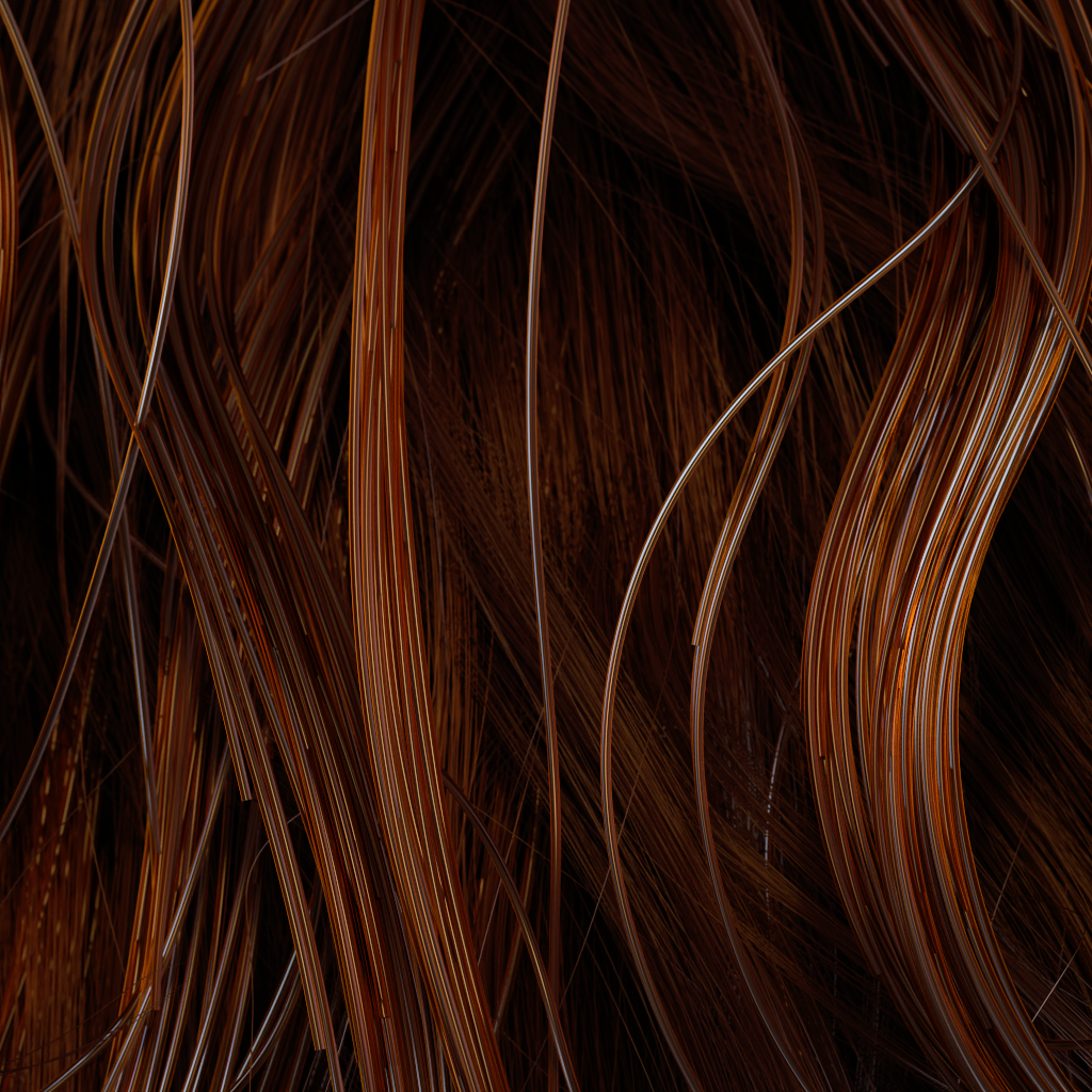

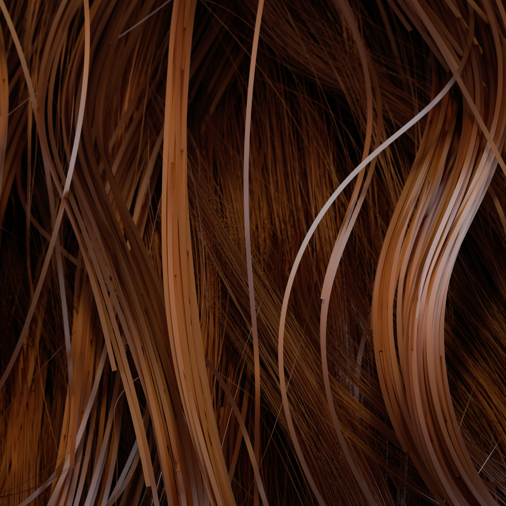

A scattering option scattering_mode has been added to the standard hair shader. Use the approximate mode to get the previous behavior. The accurate mode can be noisier, and so takes about 10 to 30% longer to render, but delivers more realistic results, especially in close-ups, by simulating each hair as a cylinder instead of flat surface. The adaptive mode uses the accurate mode for close-up hairs and the approximate for far-away hairs, automatically balancing quality and performance. (ARNOLD-16726, ARNOLD-16852)
| approximate | accurate | approximate (closeup) | accurate (closeup) |
| adaptive |

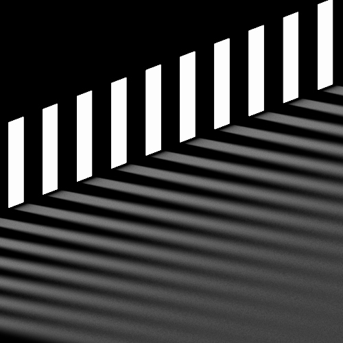

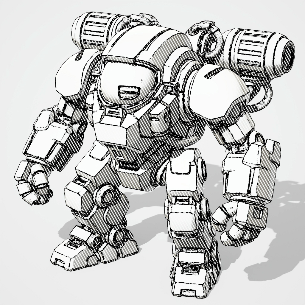

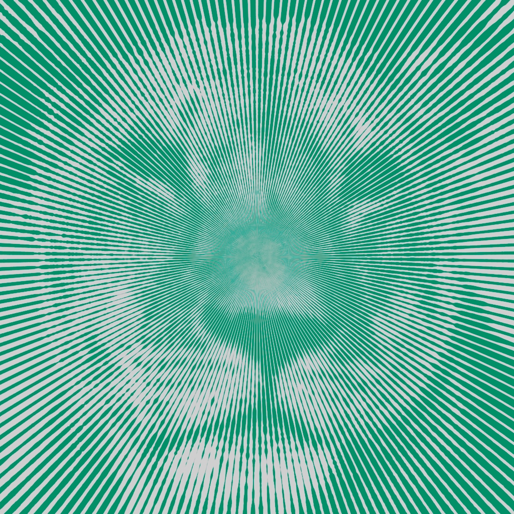

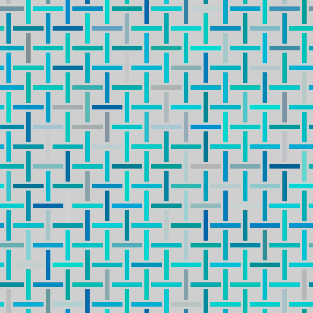

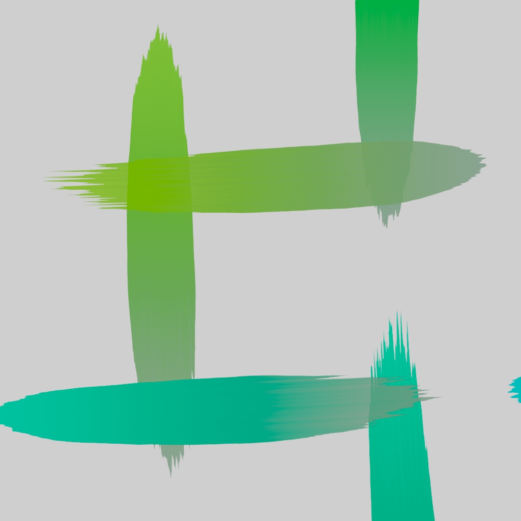

The new line shader renders lines in various styles to create geometric patterns or brush-stroke-like textures when combined with noise and textures. You can generate complex hierarchical patterns by connecting line shaders together. We recommend using the line shader with uv_transform. (ARNOLD-14976)
The uv_transform node now includes a space parameter with texture (default) and screen options. The texture mode applies transforms to standard texture UVs as before, while the screen mode uses screen UV coordinates. (ARNOLD-14976)
| Texture (default) | Screen |

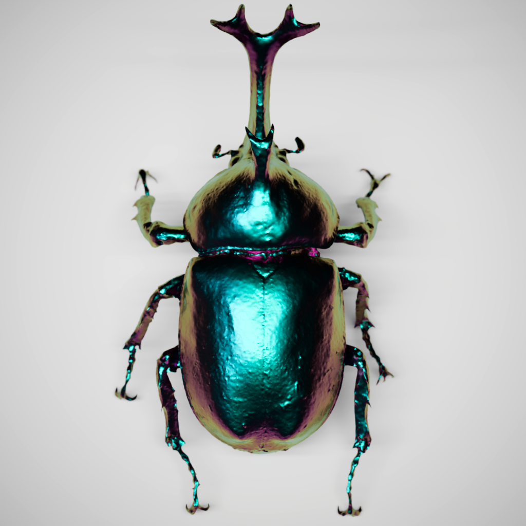

Thin film is now more physically correct, with improved energy conservation. Note that this may produce a significant change in hue in existing assets. Note also that this change has not been applied to the Standard Surface shader, for backwards compatibility. (ARNOLD-15981)
| 7.4.3 | 7.4.4 |

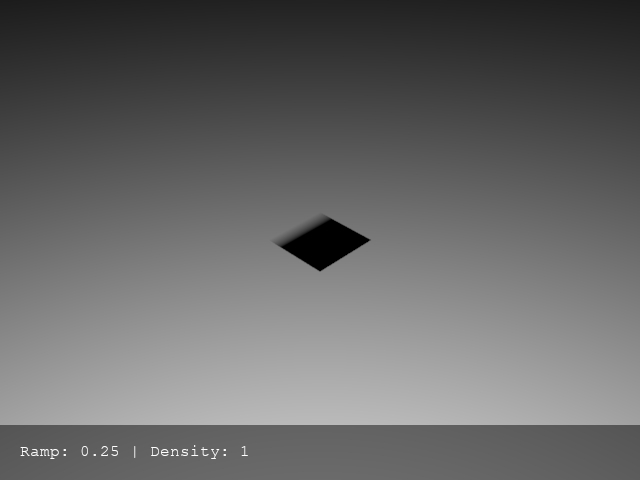

Light blockers with ramps and negative density values are now supported. (ARNOLD-16338)
| 7.4.3 | 7.4.4 |

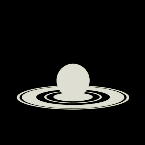

You can now make mesh lights invisible to shadow rays so that they do not cast shadows. This makes mesh lights behave like other light types, which also do not cast shadows. You use the polymesh visibility flag to control mesh light shadows. (ARNOLD-15560, ARNOLD-16803)

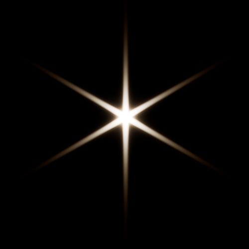

The lens effects imager has improved bloom modes that can run in a fraction of a second and produce more interesting bloom effects. The new aperture bloom mode is the default mode, and procedurally mimics the bloom defined by a physical camera and you can control the size with bloom_strength, and the shape and number of spikes with aperture_blades and aperture_curvature. The other new mode, shape_file allows you to load a bloom kernel from disk. (ARNOLD-10882, ARNOLD-16614)
The simple bloom mode and its bloom_radius parameter are now deprecated. Instead, use the new aperture mode with a curvature of 1 to get a round bloom, and bloom_strength instead of bloom_radius to adjust size of bloom.
The imager_lens_effect node has a new aperture_dispersion parameter, which controls the amount of color dispersion when in bloom_mode aperture. Increasing the dispersion value spreads the warmer colors further apart; decreasing it makes the colors progressively cooler. The default value of 1 gives realistic dispersion. (ARNOLD-16912)
| -4 | -1 | 0 | 1 | 4 |

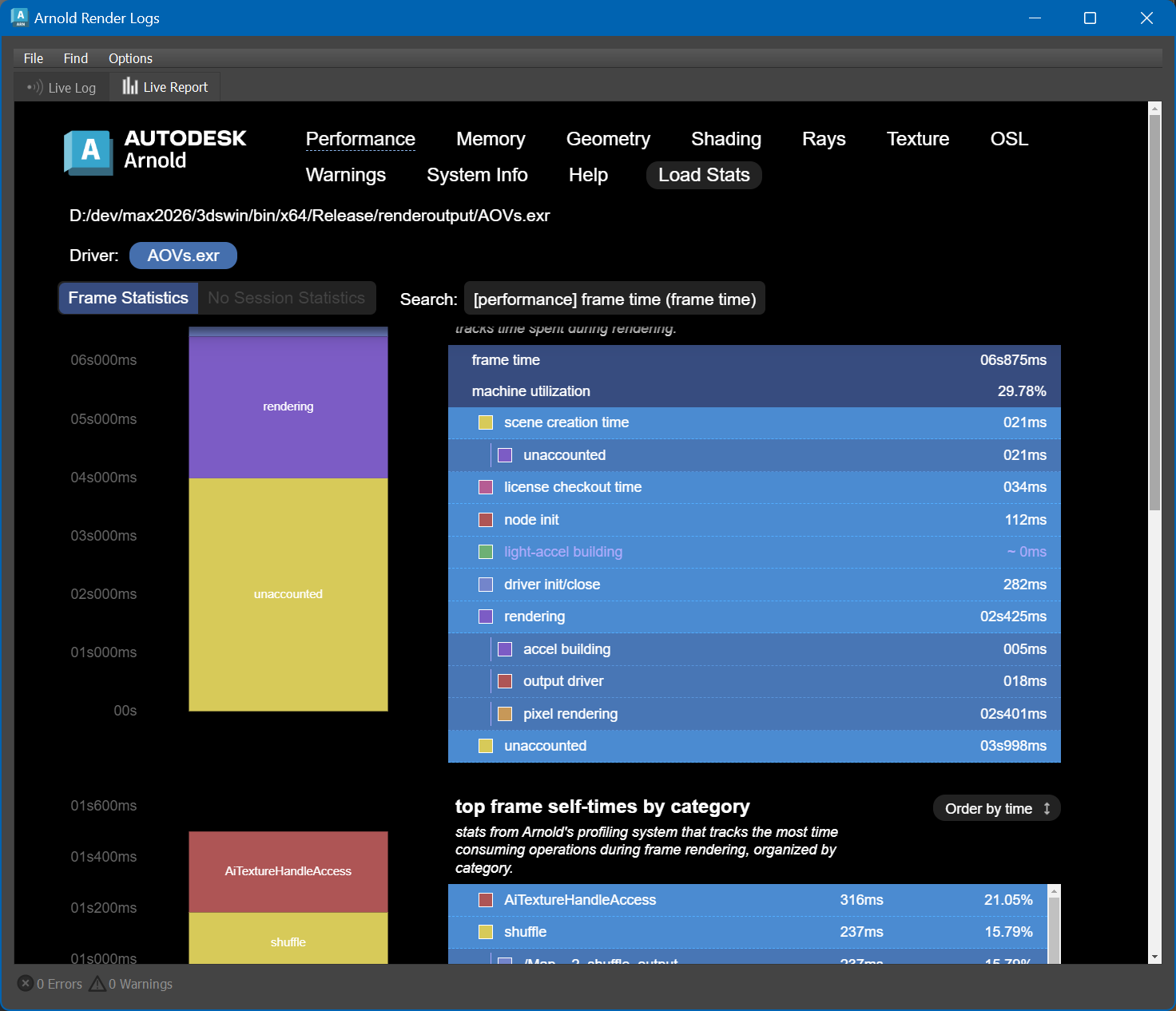

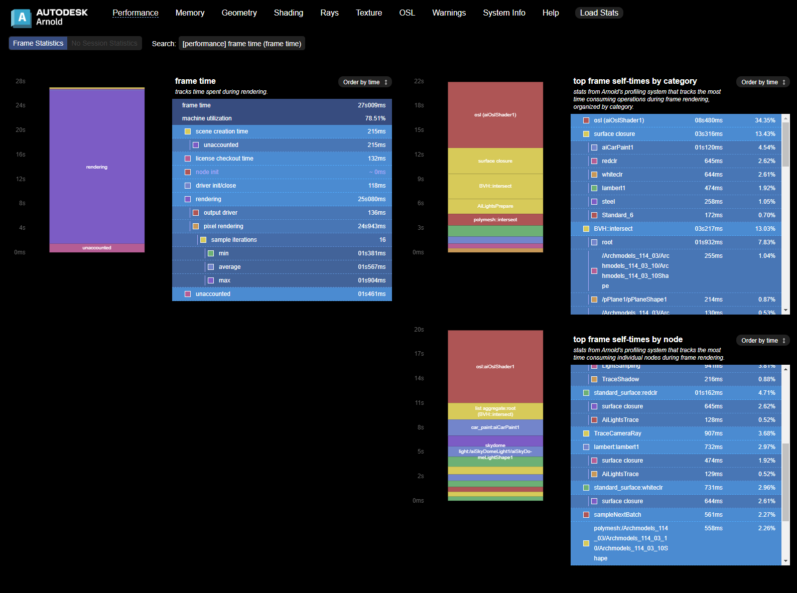

Arnold RenderView now has a Live Report tab: The Live Report is a graphical, interactive view of the Arnold log and render statistics. The Live Report updates as your interactive rendering updates. Click the Log icon in the Arnold RenderView toolbar to open the Arnold Render Logs window, and go to the Live Report tab. (MAXTOA-2017)

Consistent unit rounding in Render Report: The Arnold Render Report now rounds values to a consistent unit, improving readability and comparability. Previously, different statistics could be displayed in mixed units (for example, sometimes in milliseconds and others in seconds), which made comparisons difficult. (ARNOLD-17036)
Separate statistics for frame and session data: During interactive renders, Arnold now tracks two types of statistics: per-frame for individual frame renders and per-session for accumulated values normalized across the entire render session. The log outputs statistics for each frame in addition to the session statistics, while statistics JSON files contain the final frame statistics and session statistics. This separation helps a user analyze both the performance of individual frames and the overall render session. (ARNOLD-16735)
Render Report: enhanced statistics visualization: The Arnold Render Report now displays both per-frame and session statistics during interactive renders. Additional improvements include stacked bar graphs for better visualization of these statistics and other user experience enhancements. (ARNOLD-16736)

Mesh lights do not cast shadows when shadow visibility is disabled: In previous versions of Arnold, mesh lights cast shadows. You can now control this using the source polymesh visibility flag, so mesh lights will cast shadows only if the polymesh is visible to shadow rays. (ARNOLD-15560)
