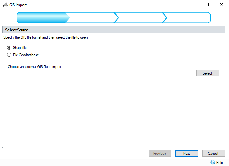

You can use the Tree View to start the wizard. Right-Click on the type of object that is to be imported and select 'Import from GIS'.
This step allows you to specify the type of GIS file being loaded, and to locate the file/folder by pressing the Select button.

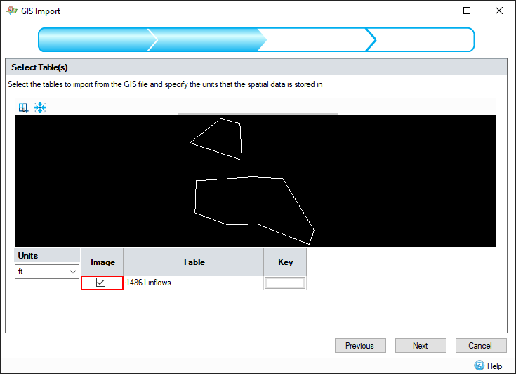

The GIS data source may contain a number of tables. This step displays a preview of the data in the tables and other options. Features with more than 1000 vertices will not be imported.
Units – Select the units that the GIS data being loaded is in so that it can be converted for use with the current Unit Selection within the software.
Tables Spreadsheet
Image – The preview pane displays data from the currently selected tables. Tick the box to toggle the selection of the table's data. At least one table must be selected, so if the data source contains only one table, the tick box will be disabled.
Table – Displays the name of the table.
Key – Click the button to change the colour of the table’s data in the preview pane.

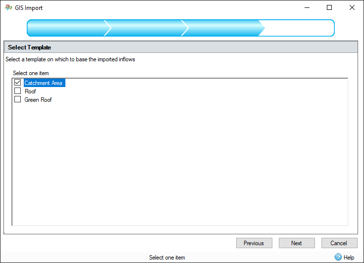

This step displays a list of Object Templates that can be used to build objects from the imported data. These templates can be the predefined types or user created. The selected template will be used to build the objects for the imported features.
This step is performed twice when importing connections. The first time to select the default connection type, and the second time to select a junction type to be created at connection endpoints where objects do not currently exist in the current stage design. The connection or junction type to create may be overruled depending on attribute values that are imported from the GIS data tables, see info below.
This step is not performed for Soil Types. Soil types do not have object templates.

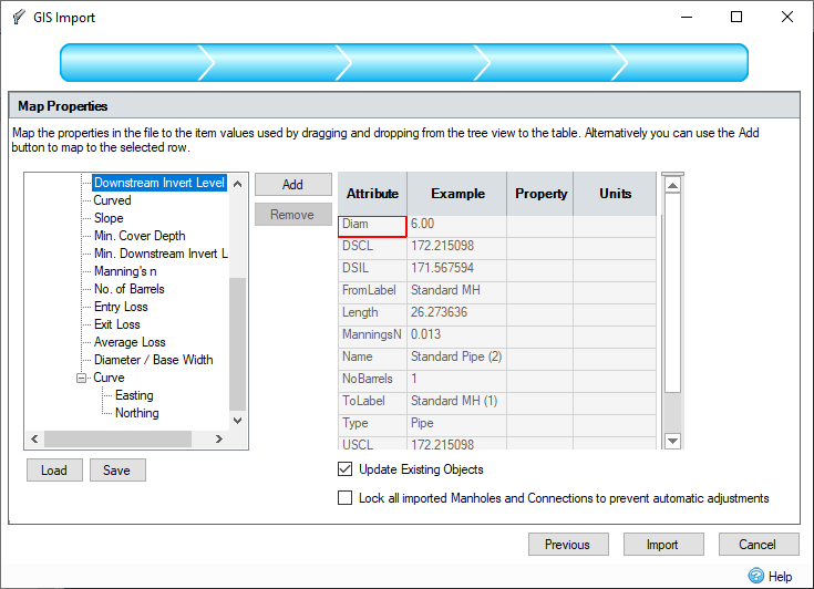

The geographic features imported may have associated non-spatial information called attributes. These attributes can be imported with the feature and assigned to properties of the created object. For example, a collection of manholes may be imported with their names and depth assigned from the attribute table.
This step shows a control that allows the attributes in the selected GIS tables to be mapped or assigned to properties in the object created from the selected template. The left-hand side of the control shows a tree view of the properties in the object that will be created. The right-hand side of the control shows a table of attributes in the GIS tables, with an example of the data that would be imported.
To make an association, a property can be dragged from the properties tree view and dropped in the property column of the attribute grid. Alternatively, highlight the required row and tree node and press the 'Add' button. To remove an association, highlight the attribute row and press the 'Remove' button.
When an association has been made, if the property selected has Unit Selection, the units column in the attribute table will be populated with a combo box, containing possible units for the attribute values. On import, the attribute values will be converted from this unit to the currently selected unit in the software.
The current association configuration can be saved by pressing the 'Save' button and a previously saved configuration can be loaded by pressing the 'Load' button.
If the Update Existing Objects option is ticked, the import will check for items with the same names and types to update rather than create. All internal information on the duplicated objects will be updated to match the selected imported attributes. If no suitable item to update can be found, it will be created as usual.
If the Lock all imported Manholes and Connections to prevent automatic adjustments option is ticked, the import will set each manhole and connection to have their levels locked using the Lock state.

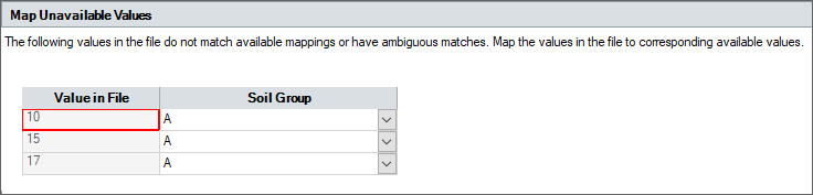

If any of the following attributes have been assigned, additional pages may be displayed in the wizard:
Land Uses: Land Use, Cover Type, Condition
Soil Types: Soil Group
InfoDrainage will attempt to assign the attribute values read from the GIS file to the available InfoDrainage property options for the imported features. If no suitable mapping is discovered for one or more of the GIS attribute values, a further mapping page will be displayed that will allow an association to be made.
