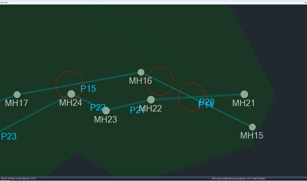

The results of a clash detection analysis will be displayed on the plan view as red circles highlighting the areas where a clash detection has occurred.
This setting can be configured in the Display Settings.
