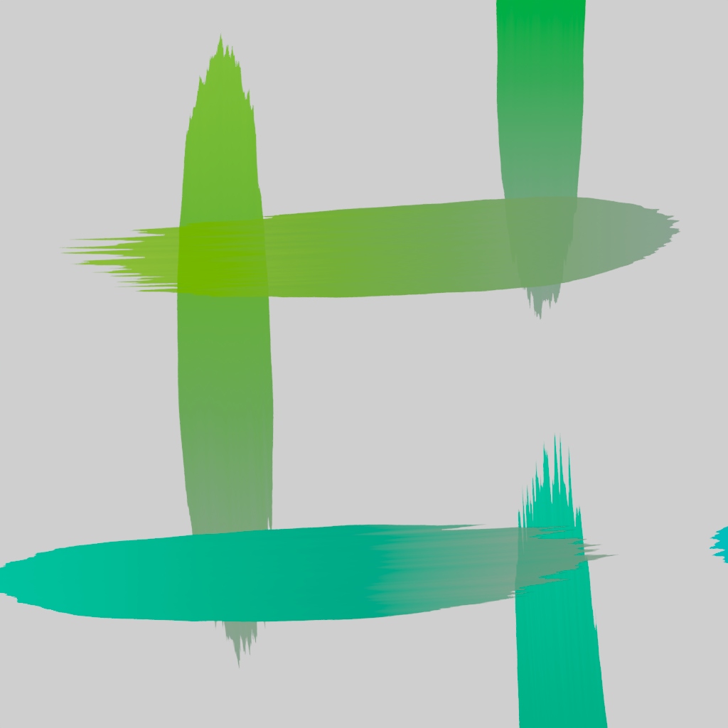

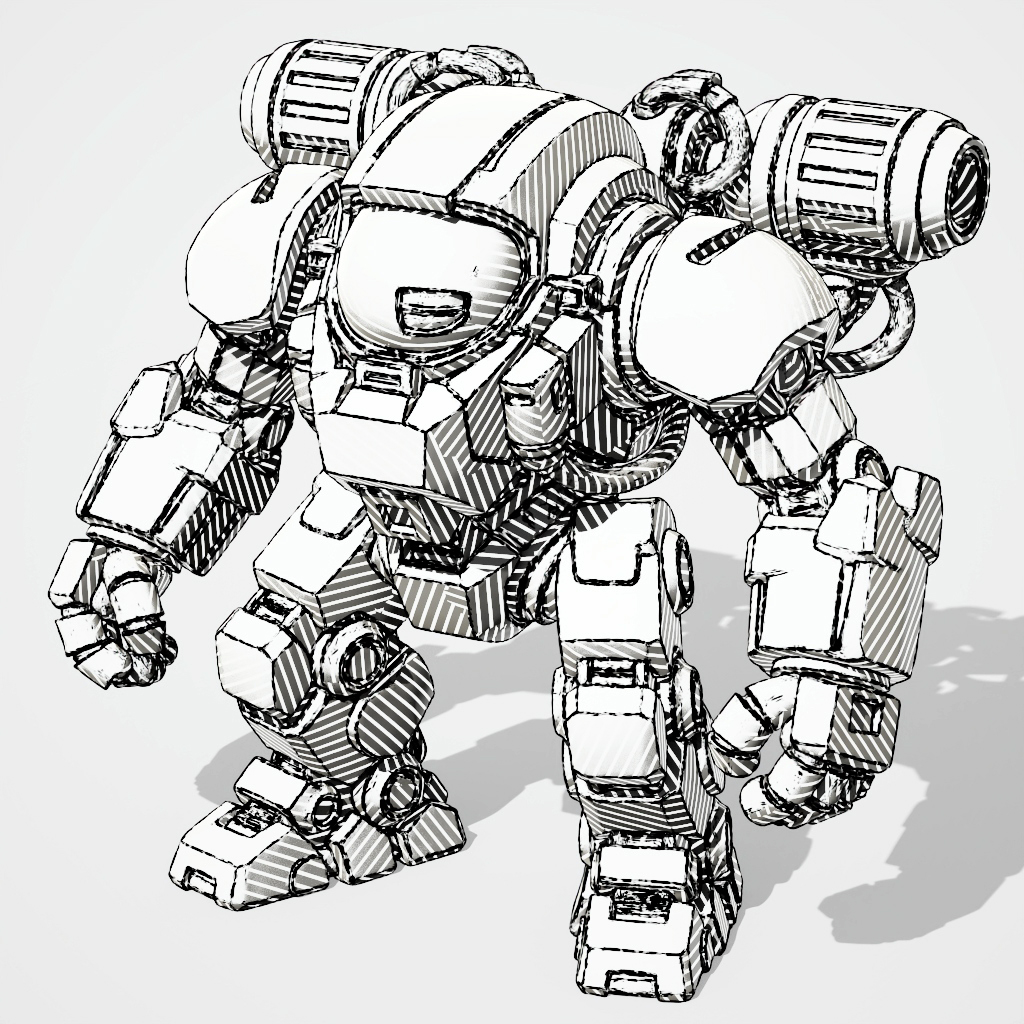

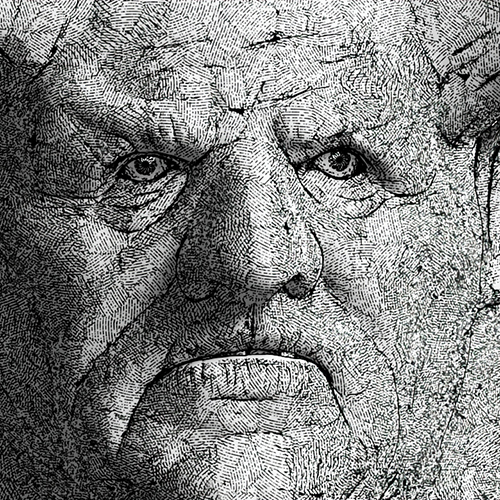

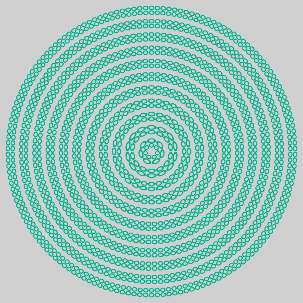

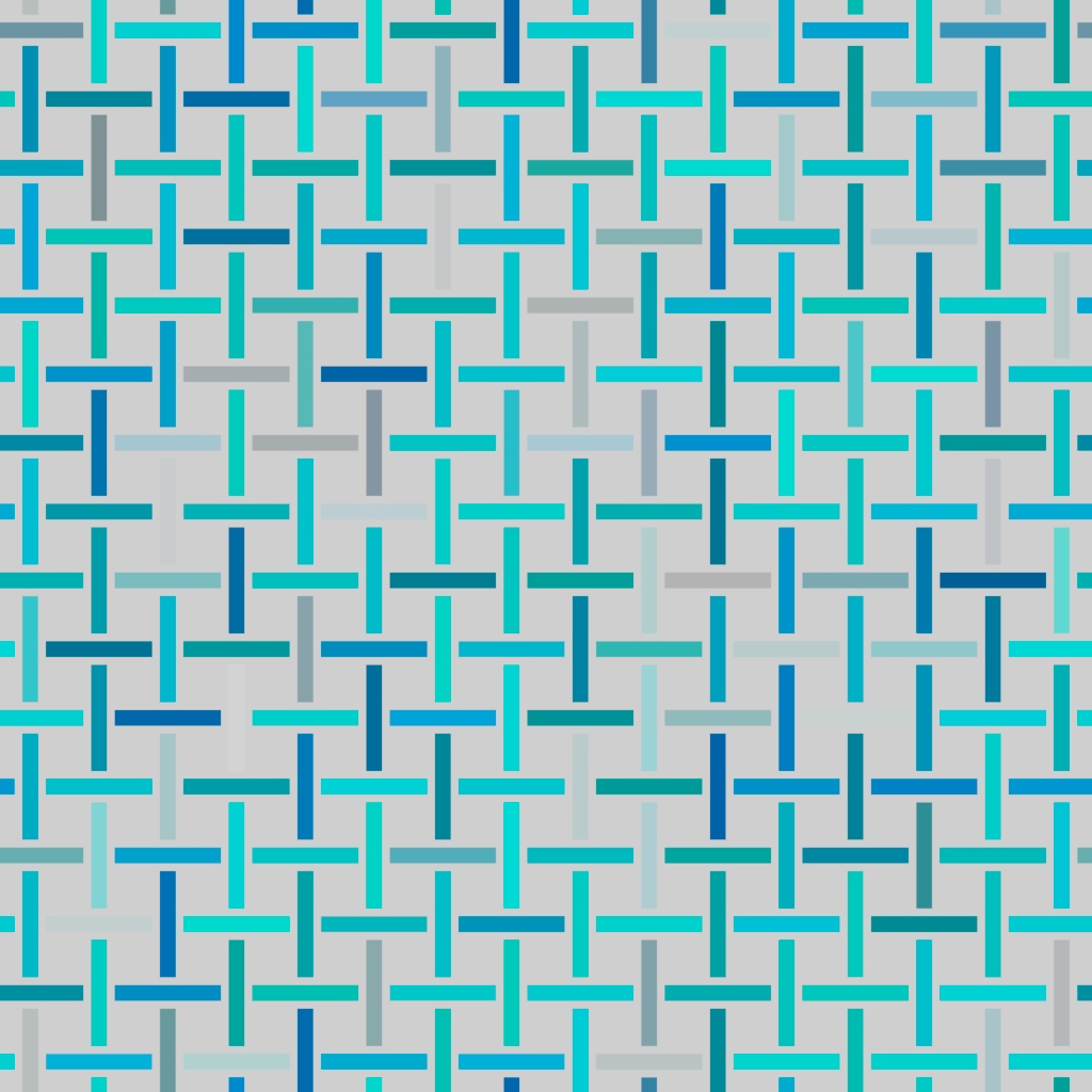

| Line → UV Transform (screen space) | Line → UV Transform (screen space) | Line → Triplanar |

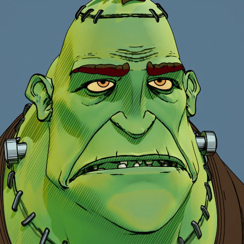

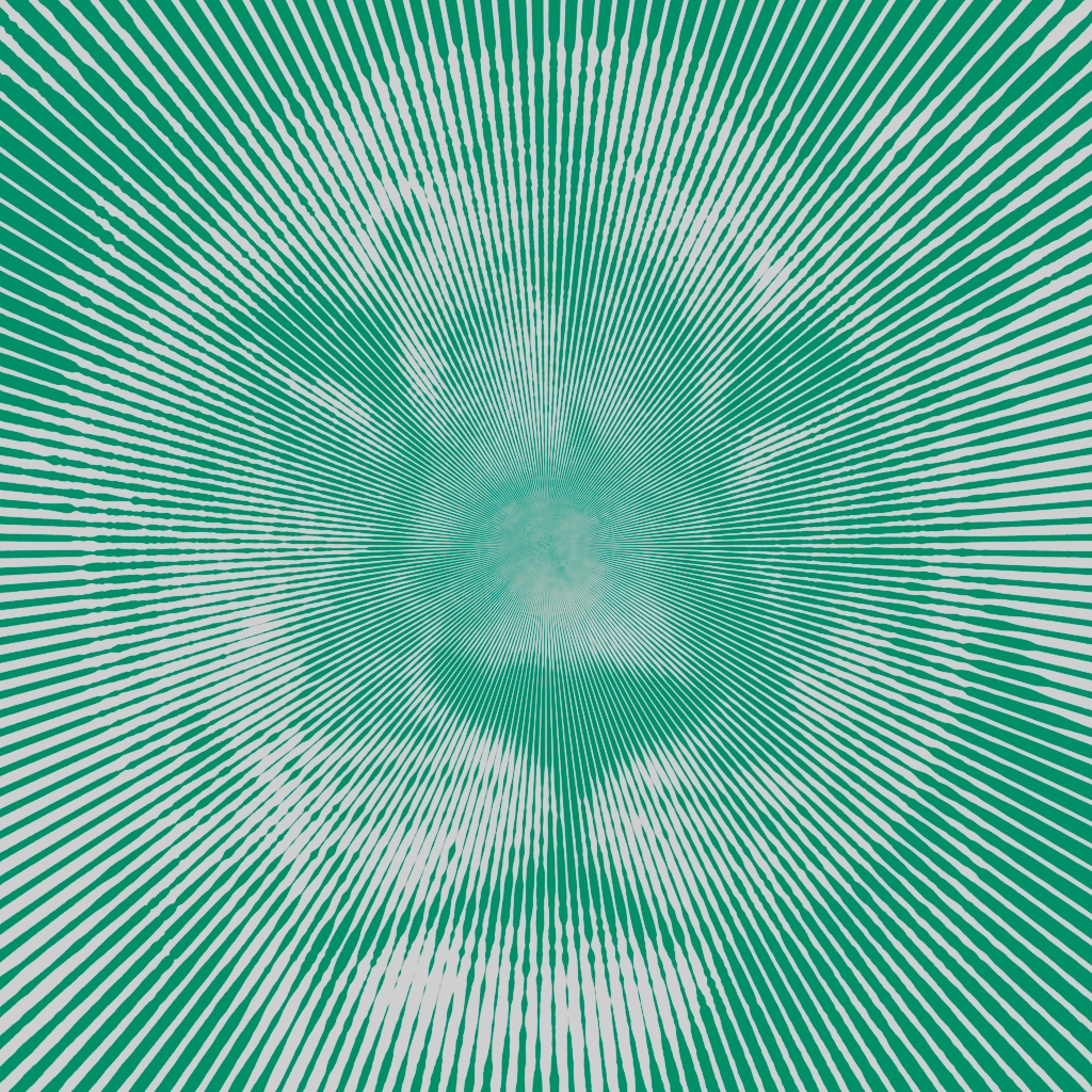

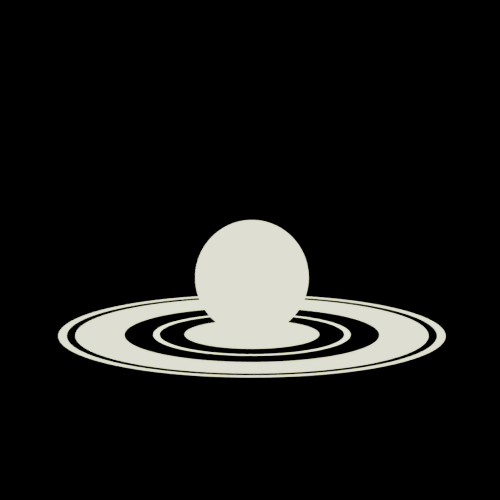

The new line shader renders lines in various styles to create geometric patterns or brush-stroke-like textures when combined with noise and textures. You can generate complex hierarchical patterns by connecting line shaders together. We recommend using the line shader with uv_transform. (ARNOLD-14976)

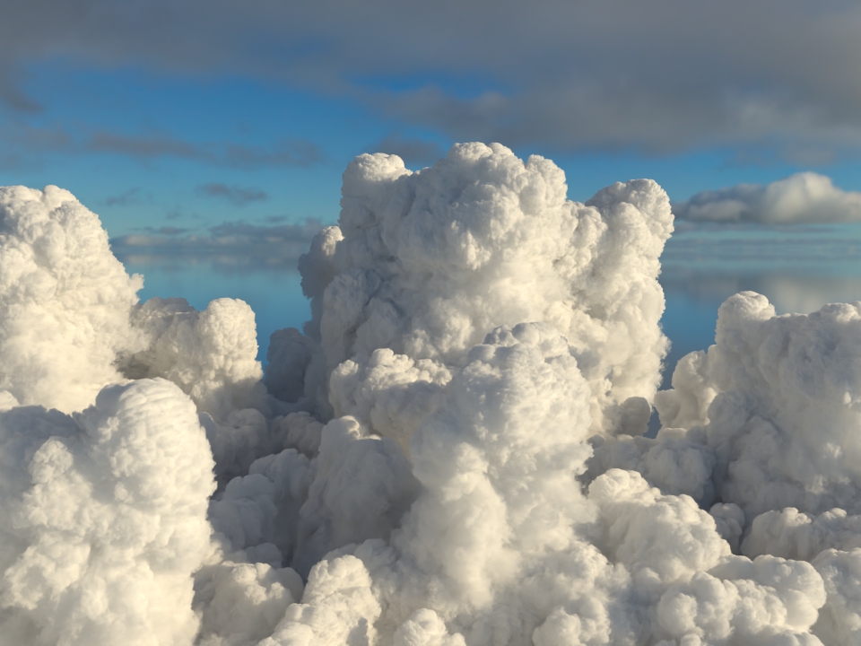

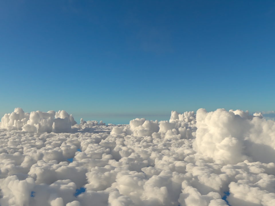

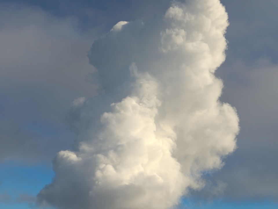

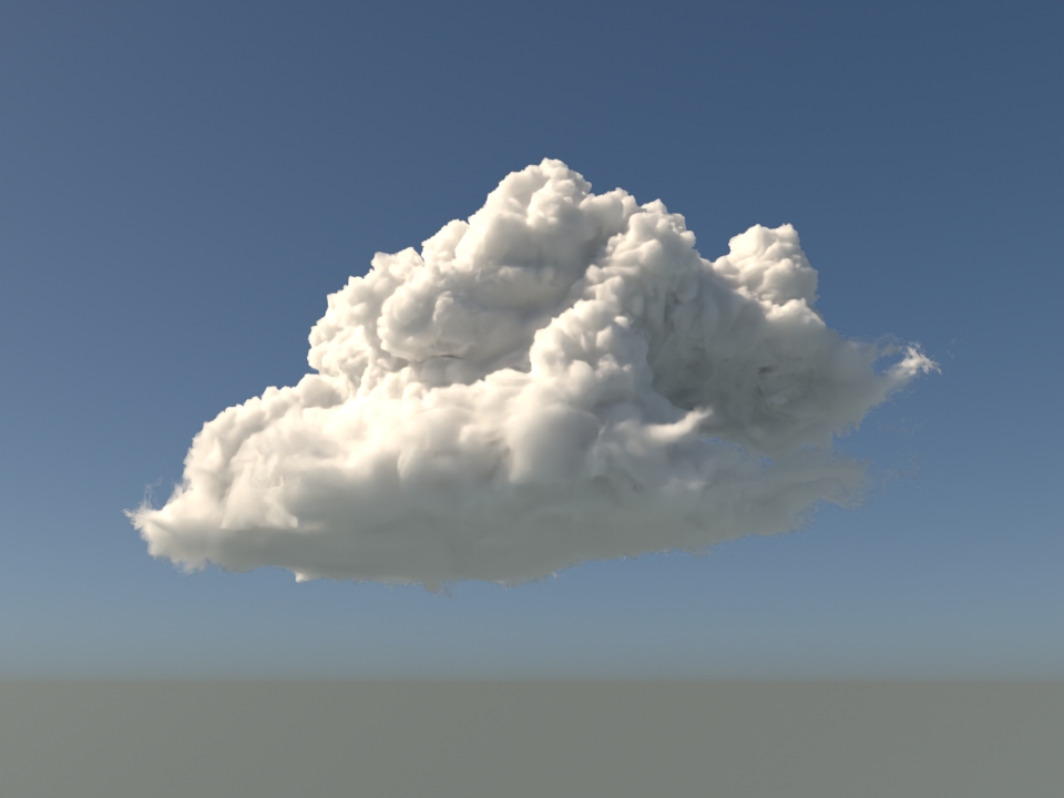

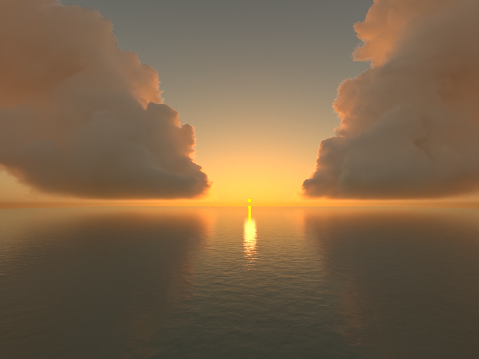

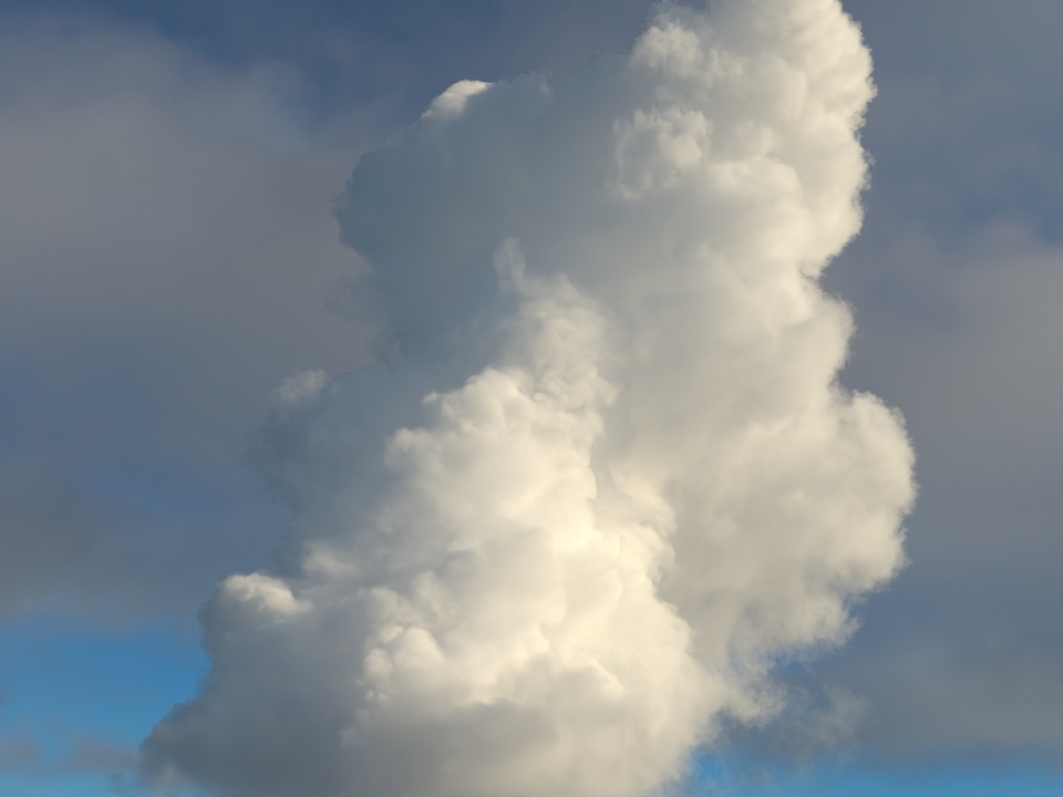

Support for mip-mapped OpenVDB files on CPU: The volume node now accepts OpenVDB files with mip-mapped grids. You can generate volume mip maps with the Arnold API or with kick (see API Changes below). The different mip-map levels are distinguished by _level_N suffixes, where N is the mip-map level. Arnold then automatically chooses the appropriate mip-map level during rendering, which gives substantial speedups in volumes with a lot of scattering (for example, clouds) in exchange for mostly small differences in look. Volumes with more mip-map levels can have larger differences in look. Users can also specify mipmap_bias on a volume node or on its instance (by declaring user data of the same name), which adjusts the automatic mipmap selection by that amount. (ARNOLD-14453, ARNOLD-15056)
| wdascloud | byc-cloud | composition 1 | composition 2 | sunset clouds | |
| original volume | ![]() |
| mip-mapped volume (3 levels) | ![]() |
| Speedup | 1.5x | 1.9x | 2.6x | 2.1x | 1.8x |
| mip-mapped volume (6 levels) | ![]() |
| Speedup | 2.0x | 2.8x | 5.2x | 3.2x | 2.7x |

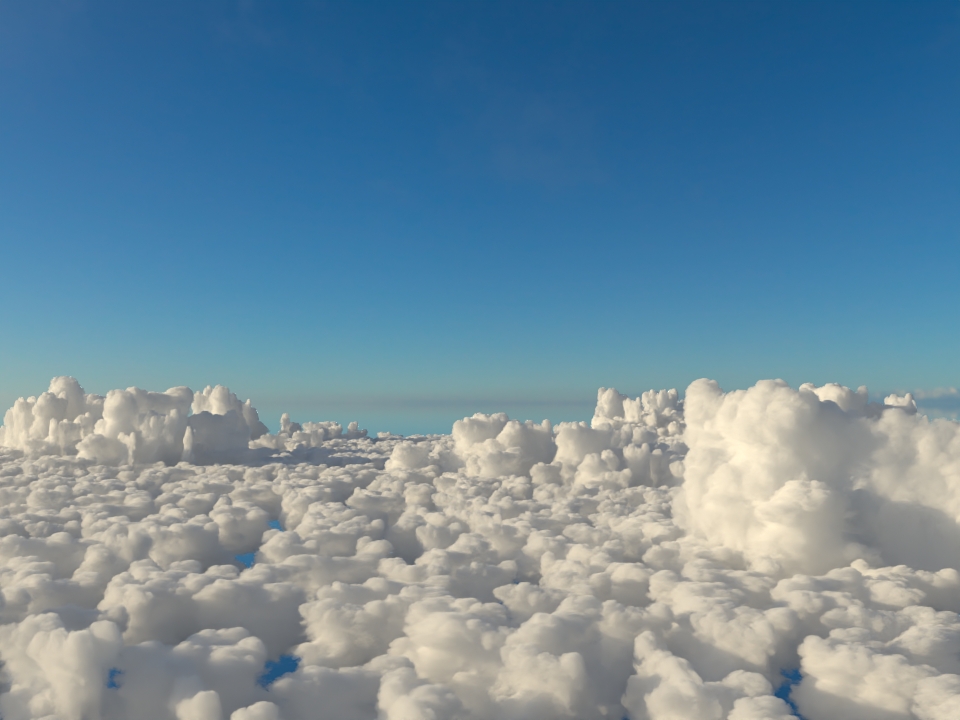

Improved GPU volume rendering performance: GPU rendering of volumes is up to 3.5x faster. (ARNOLD-8936)
| Speedup | 2x | 1.12x | 3.7x | 3.5x | 1.31x |

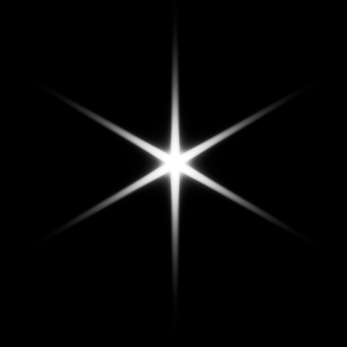

pointcloud_search and pointcloud_get OSL built-in functions. To specify a points, curves, or polymesh node, use the node name for the point cloud name. To specify an OpenVDB file, use the format filename:grid for the point cloud name. Note: These functions are not yet available on GPU. (ARNOLD-15550)aperture_dispersion parameter, which controls the amount of color
dispersion when in bloom_mode aperture. Increasing the dispersion
value spreads the warmer colors further apart; decreasing it makes the colors progressively cooler. A value of 1 gives realistic dispersion. (ARNOLD-16912)
