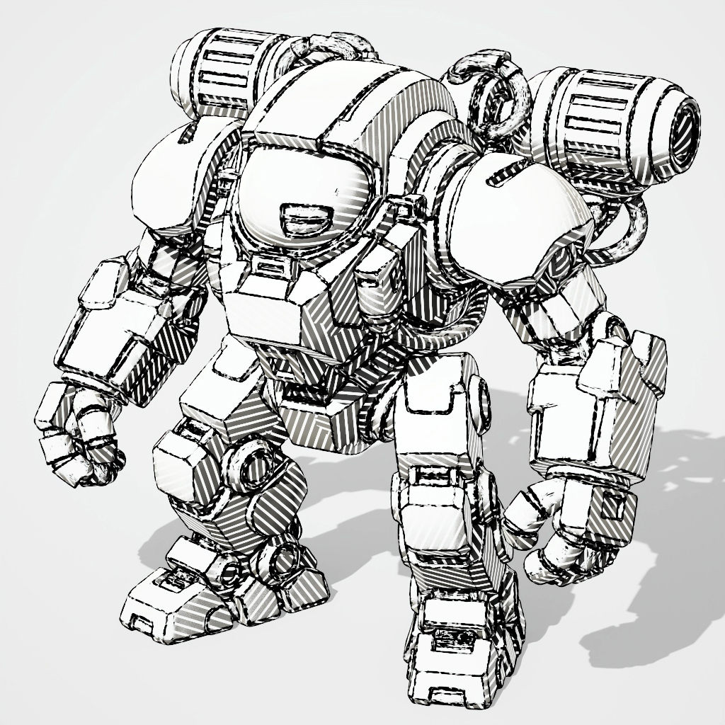

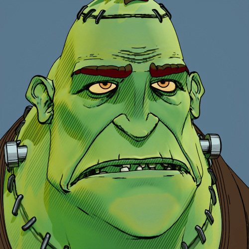

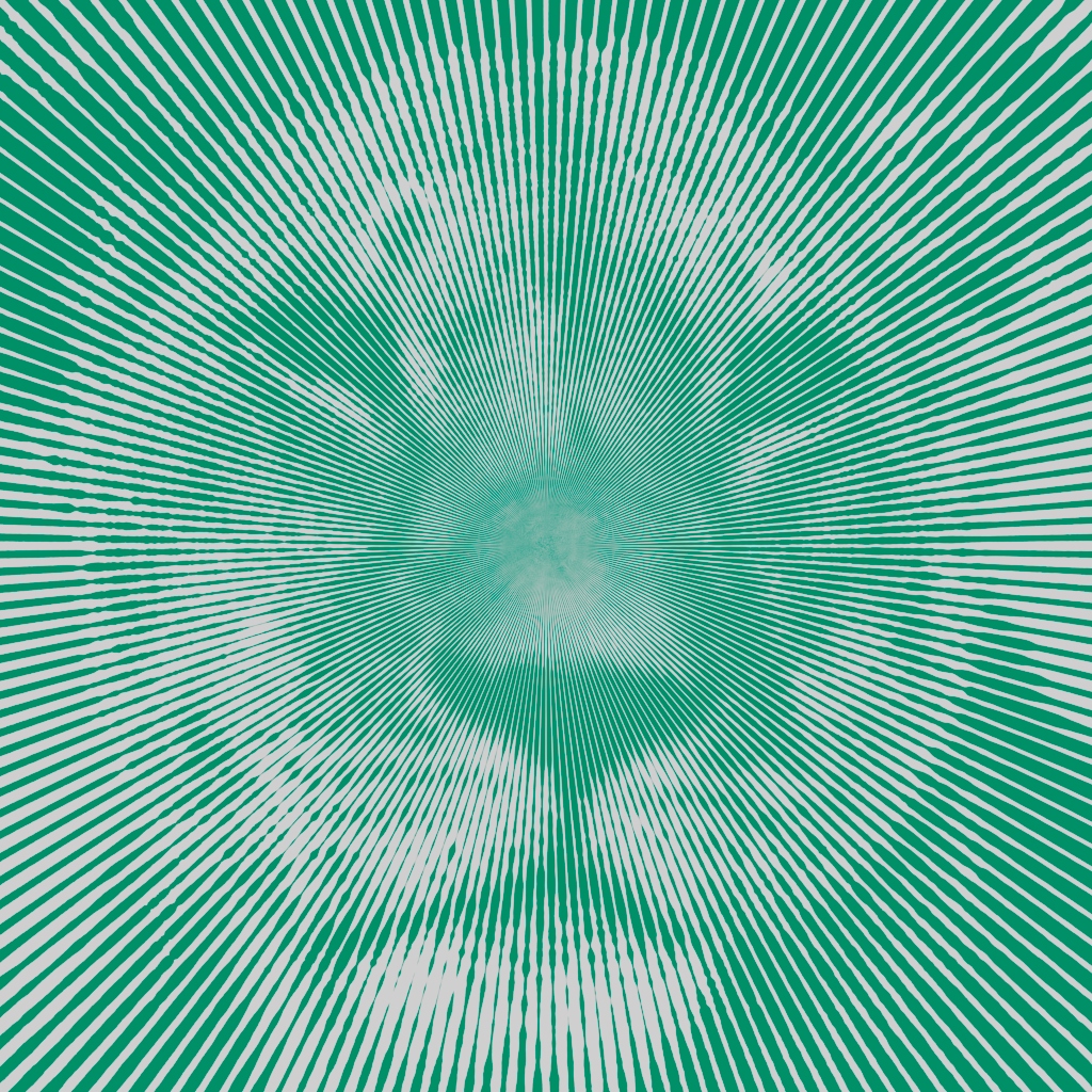

| Line → UV Transform (screen space) | Line → UV Transform (screen space) | Line → Triplanar |
The new line shader renders lines in various styles to create geometric patterns or brush-stroke-like textures when combined with noise and textures. You can generate complex hierarchical patterns by connecting line shaders together. We recommend using the line shader with uv_transform. (ARNOLD-14976)

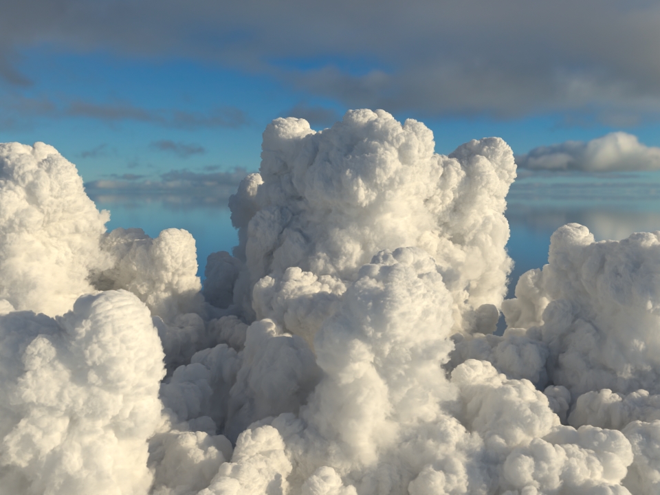

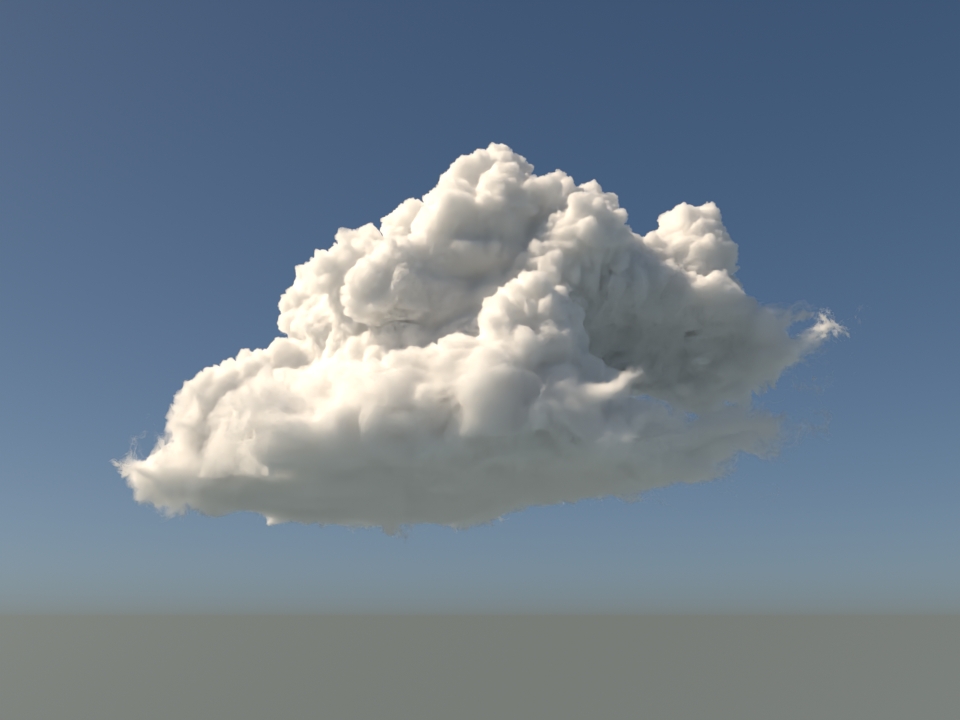

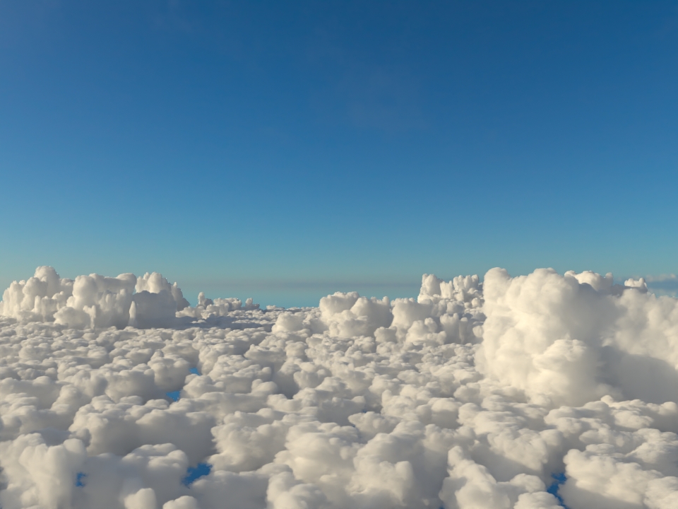

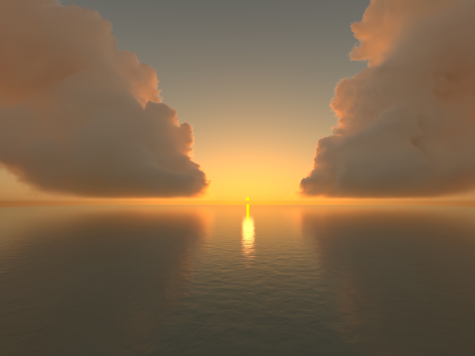

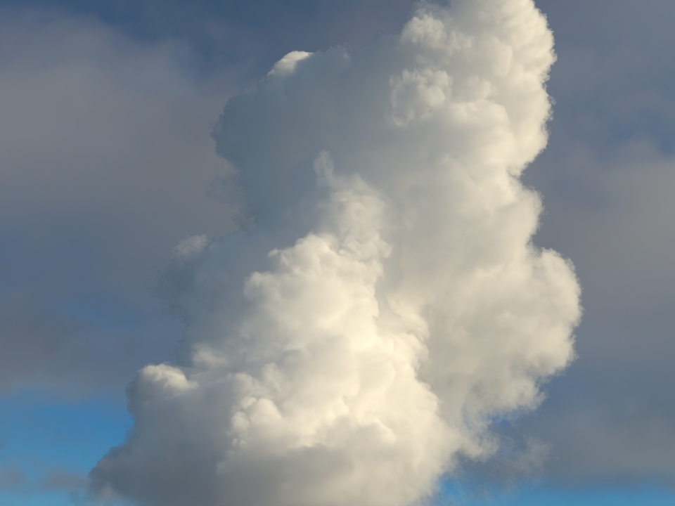

Support for mip-mapped OpenVDB files on CPU: The volume node now accepts OpenVDB files with mip-mapped grids. You can generate volume mip maps with the Arnold API or with kick (see API Changes below). The different mip-map levels are distinguished by _level_N suffixes, where N is the mip-map level. Arnold then automatically chooses the appropriate mip-map level during rendering, which gives substantial speedups in volumes with a lot of scattering (for example, clouds) in exchange for mostly small differences in look. Volumes with more mip-map levels can have larger differences in look. Users can also specify mipmap_bias on a volume node or on its instance (by declaring user data of the same name), which adjusts the automatic mipmap selection by that amount. (ARNOLD-14453, ARNOLD-15056)
| wdascloud | byc-cloud | composition 1 | composition 2 | sunset clouds | |
| original volume | ![]() |
| mip-mapped volume (3 levels) | ![]() |
| Speedup | 1.5x | 1.9x | 2.6x | 2.1x | 1.8x |
| mip-mapped volume (6 levels) | ![]() |
| Speedup | 2.0x | 2.8x | 5.2x | 3.2x | 2.7x |

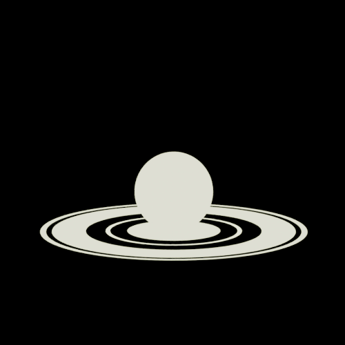

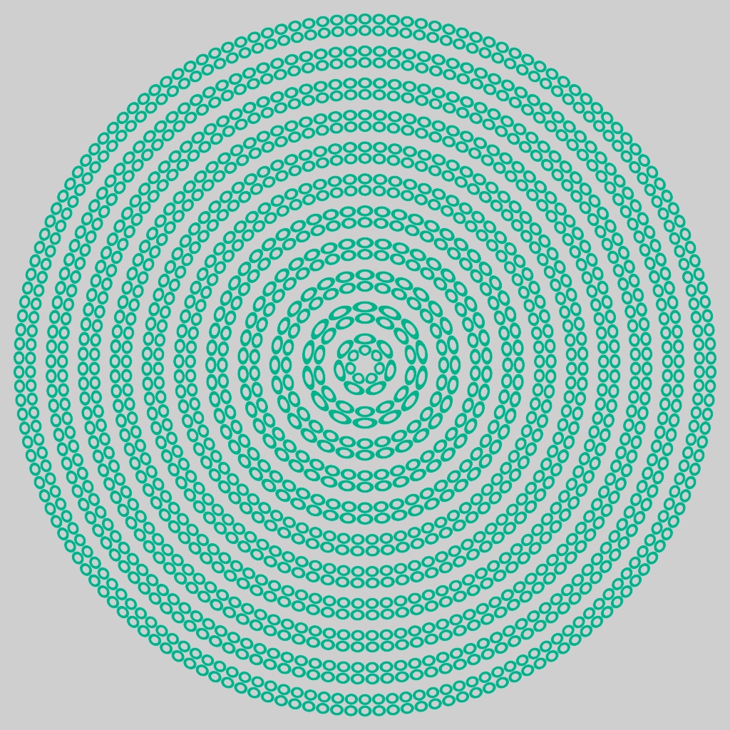

Nearest points shader: The new nearest_points shader samples point clouds from OpenVDB points files, or alternatively, the vertices from points, curves, and polymesh nodes. The shader can output the number of points found, average distance, or an average of a custom user-data attribute from the points. (ARNOLD-15550)
| Nearest Points distance → RampRGB (custom) | Nearest Points distance → Line → Standard Volume transparent |
