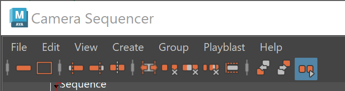

Sequencer menu bar
Note: Some settings for Sequencer are located in the Playblast Options.
