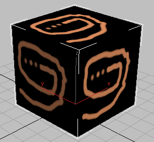

    The composite or Paint branch that you create in Combustion appears on the object in 3ds Max viewports, as well as in the sample slot for the material with the Combustion map. The workspace name and path are assigned to the material, and appear on the Project button in the material’s Combustion Parameters rollout.
For example, you can use the Paint operator in Combustion. When you release the mouse, the stroke appears on the 3ds Max object.
Painted object in 3ds Max

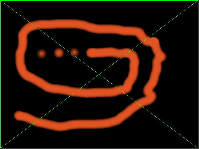

  2. In the 3ds Max Material Editor, enable Unwrap Selected in the Live Edit group.
    In Combustion, a mesh appears. This is an "unwrapped" projection of the 3D object.
    3D object in 3ds Max
    Corresponding mesh in Combustion

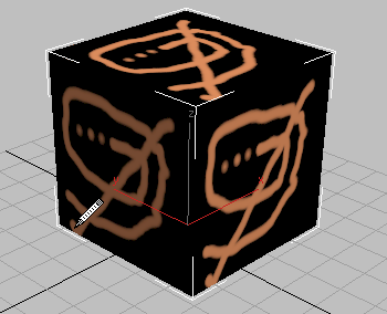

  3. In the 3ds Max Material Editor, enable Paint in the Live Edit group of the Combustion Parameters rollout.
    In the 3ds Max viewport, a pen cursor appears. Drag the cursor over the object to paint on it.
    When you release the cursor, the Paint object also appears in Combustion.

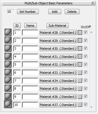

    Use a Multi/Sub-Object material to control the location of your painting. Any sub-material can have a Combustion map, so you can use Combustion to affect only the selected faces.
  1. In 3ds Max, select the object you want to paint.
  2. In the Modify panel, apply an Edit Mesh modifier to the object. (Choose Edit Mesh from the Modifier drop-down list.)
    If you are working with an editable mesh object, or a patch or NURBS surface, skip step 2. For geometry primitives, an option is to convert the object to a mesh, patch, or NURBS surface before step 3. However, you then lose the ability to adjust object parameters (for example, the radius of a sphere, the height of a box).
  3. Choose Face as the sub-object selection level. Select the faces on which you want to paint.
  4. Drag a material from a sample slot in the Material Editor onto the selected faces.
  5. In the modifier stack display, choose the object again, to disable sub-object selection.
  6. In the Material Editor, use (Pick Material From Object) to grab the material from the geometry.
    You now have a new Multi/Sub-Object material. The original material appears as a sub-material applied to the selected faces.
  7. In the Multi/Sub-Object material, go to the material assigned to the faces you want to paint.
    A Multi/Sub-Object material is simply a container for multiple sub-materials assigned to different faces of the same object. Click a Sub-Material button to go to a sub-material.
  8. Assign a Combustion map to the Diffuse component of the sub-material applied to the selected faces.
  9. Click Edit to launch Combustion.
  10. Use the tools in Combustion to modify the material.

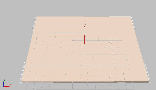

To create a displacement map:
    In 3ds Max, the Displace modifier acts as a force field to push and reshape an object's geometry. You can apply its variable force directly from the modifier gizmo, from a bitmap image, or from a Combustion workspace.
    The grayscale component of the image is used to generate the displacement. Lighter colors in the image push outward more strongly than darker colors, resulting in a 3D displacement of the geometry.
  1. In 3ds Max, select the object to which you want to apply the displacement map.
    In this example, the displacement is applied to a box primitive.
    In the object's Parameters rollout, increase the number of Length and Width Segments. The closer the number of segments approaches the resolution of the displacement map, the more accurate is the result.
    In the example, 150 by 150 gives good results.

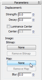

  2. Apply a Displace modifier: In the Modify panel, choose Displace from the Modifier drop-down list.
  3. In the Parameters rollout, Image group, click the Map button.
  4. The Material/Map Browser appears. Select Combustion and click OK.
    The Map button now reads Map #1 (Combustion).
  5. Open the Material Editor, and then click and drag the Map #1 (Combustion) button to an unused sample slot in the Material Editor.
    An Instance (Copy) Map dialog is displayed.
  6. Select Instance and click OK.

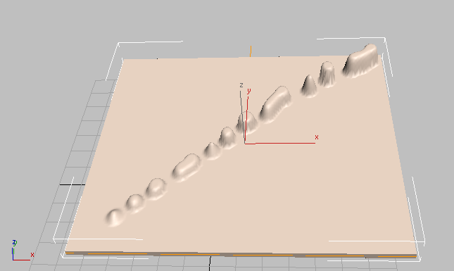

  7. In the Material Editor, Combustion Parameters rollout, click Edit.

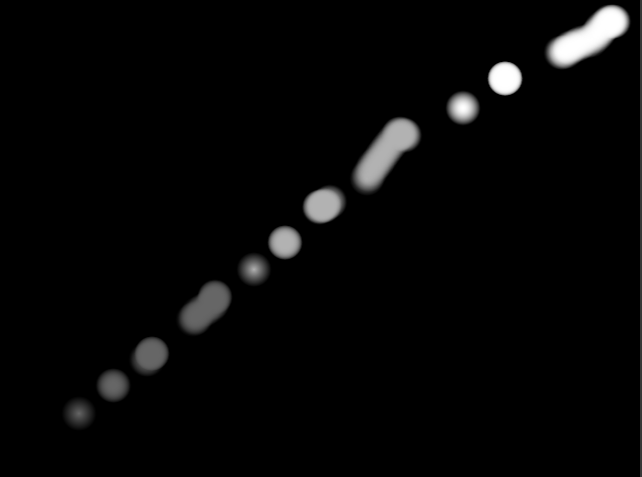

    This launches Combustion. In the New dialog, set the Type To Paint, and create a grayscale image to use as a displacement map. For more information, see the Combustion User's Guide.
  8. In 3ds Max, increase the Displacement strength in the modifier Parameters rollout.
    As you increase the strength, you can see the result of the displacement map on the selected object.
  9. In Combustion, save your project, then in 3ds Max, disable Edit in the Combustion Parameters rollout to exit Edit mode.

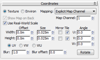

2D Mapping Coordinates
Like any 2D map in 3ds Max, mapping coordinates control how a Combustion map is positioned on objects.
For geometric primitives, mapping coordinates are usually provided automatically. For some kinds of geometry, such as meshes, patches, and NURBS surfaces, you must apply a UVW Map modifier to provide mapping coordinates.
Controls in a 2D map's Coordinates rollout affect how the map is positioned.
When you work with a Combustion map, these are the important points to remember:
  • When you apply a Combustion map to an object, leave mapping set to the default values of Texture and Explicit Map Channel.
  • When you use a Combustion map as an environment map, set mapping to Environ and then choose the mapping shape from the Mapping drop-down list.
  • The offset, tiling, mirror, and angle controls are useful especially when the size of the projected Combustion map is smaller than the geometry.
  • You can choose between UV, VW, and WU projections. (You can also do this from the Combustion Parameters rollout, as described below.) UV projects onto the surface of geometry like a slide projector. VW and WU project the map at right angles to the geometry. With a Combustion map, UV is almost always the most useful choice.

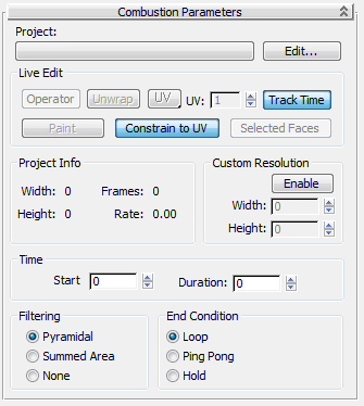

The Combustion Parameters rollout appears when you assign a Combustion map to a material.
Project
Loads the file to use in Combustion. You can load only file types supported by Autodesk Combustion, such as Combustion workspace files (cws), or footage and image file formats supported by Combustion (see the Combustion User's Guide for information on supported footage formats).
Edit
Launches Combustion from the 3ds Max Material Editor. If a project is loaded, it is opened in Combustion. If no project is loaded, Combustion displays the New dialog. This dialog lets you specify a project type, name, video format, duration, and background color.
Live Edit group
These controls affect how you use Combustion with 3ds Max.
Operator
Switches control to Combustion, where you can select an operator. The results of the operator appear as the image in the Combustion map. The operator does not have to be the last operator in the pipe.
While Combustion is active, you can also adjust the operator. The Combustion map updates to show the results.
Unwrap Selected
Takes the current UVW mapping coordinates of the currently selected 3D object (or the current Face sub-object selection), and displays them in Combustion. This can help you coordinate the map and the mesh as you paint. The Unwrap display is only an overlay. It is displayed in Combustion but is not a part of the composite or the map.
UV List
Changes the mapping coordinate system (the direction in which the map is projected) from UV to VW or UW. UV projects onto the surface of geometry like a slide projector. VW and WU project the map at right angles to the geometry. With a Combustion map, UV is almost always the most useful choice.
UV
Specifies which mapping channel to unwrap and paint. Range=1 to 99.
Track Time
Links the Timeline in Combustion to the time slider in 3ds Max. When Track Time is enabled, you can use the time slider in 3ds Max to navigate between frames in Combustion.
Note: This control is not bidirectional; changing the frame in Combustion does not change the frame in 3ds Max.
Paint
When enabled, displays a paint cursor in 3ds Max viewports. You can then paint directly on the 3D geometry. Dragging the cursor in the viewport over the geometry in 3ds Max creates paint strokes inside Combustion.
Constrain To UV
When enabled, constrains paint strokes to remain within the edges of the UV mapping coordinates. When paint strokes are unconstrained on an object such as a box, they can jump to the other side of the map when you cross a map’s edge. This can give erratic results. To prevent this, enable Constrain To UV.
In general, use the Constrain To UV option when you paint on boxes and other objects with planar maps. Disable this option when you want to paint on spherical maps or anywhere else the mapping has a singularity (where the edges of the map converge to a single point).
Selected Faces
Constrains the Combustion image to only the faces selected. This gives additional control or masking based on faces rather than UV mapping.
Project Info group
These readouts display the format of the Combustion Paint or composite operator. They are active when a Combustion workspace is loaded or Edit mode is active.
Width
Sets horizontal resolution of the frame in pixels.
Height
Sets vertical resolution of the frame in pixels.
Frames
Sets number of frames in the Combustion workspace.
Rate
Sets playback speed in frames per second.
Custom Resolution group
With these controls, you can customize the resolution of the Combustion map.
Enable
Enables the Width and Height controls.
Width and Height
Width changes the horizontal resolution of the map. Height changes the vertical resolution of the map.
Time group
These controls relate frames in the Combustion workspace to frames in the Combustion map. See the controls under "End Condition Group" for how to handle the map when it contains fewer frames than the 3ds Max scene.
Start Frame
Determines which frame of the Combustion sequence is used as the first frame of the Combustion map in 3ds Max.
Duration
Sets how many frames of the Combustion file sequence are used by the Combustion map in 3ds Max.
Filtering group
These controls determine the method for calculating antialiasing:
  • Pyramidal (The default.) This method is faster than Summed Area filtering.
  • Summed Area Implements a better method of antialiasing. Summed Area filtering uses more memory than Pyramidal. If it has to use virtual memory, it can dramatically increase rendering time.
  • None Performs no antialiasing. This option takes the least time to render, but yields the lowest quality results.
End Condition group
These controls define what the 3ds Max renderer should do when the duration of the Combustion project (or the range of frames used in the Combustion map) is shorter than the rendering sequence in 3ds Max.
  • Loop Plays the Combustion project animation repeatedly until the rendering sequence ends.
  • Ping Pong Plays the animation forward, then backward, and repeatedly plays forward and backward until the rendering sequence is completed.
  • Hold Plays the animation once, then repeatedly displays the last frame of the project until the rendering sequence is completed.
