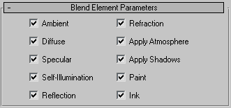

Blend Element Parameters Rollout
The Blend element is a custom combination of several other elements.
  • Main toolbar > (Render Setup) > Render Setup dialog > Render Elements panel > Render Elements rollout > Add button > Render Elements dialog > Add Blend element to the elements list (or select an existing Blend element in the list).
  • Rendering menu > Render Setup > Render Setup dialog > Render Elements panel > Render Elements rollout > Add button > Render Elements dialog > Add Blend element to the elements list (or select an existing Blend element in the list).
By default, all elements are turned on in this rollout, and the Blend rendering is identical to the full, normal rendering, except for the scene background. Use the checkboxes to choose your own combination of elements to appear in the Blend rendering.
Ambient
When on, include the ambient color component. Default=on.
Diffuse
When on, include the diffuse color component. Default=on.
Specular
When on, include the specular color component. Default=on.
Self-Illumination
When on, include self-illumination. Default=on.
Reflection
When on, include reflections. Default=on.
Refraction
When on, include refractions. Default=on.
Apply Atmosphere
When on, include atmospheric effects. Default=on.
Apply Shadows
When on, include shadows. Default=on.
Paint
When on, include the Paint component of Ink 'n Paint materials. Default=on.
Ink
When on, include the Ink component of Ink 'n Paint materials. Default=on.
