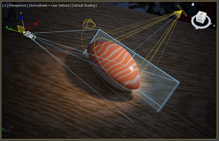

To use ActiveShade, you must use Nitrous drivers as legacy drivers are not supported. ActiveShade can only be displayed in one window or viewport at a time.
To display ActiveShade in a viewport:
- In the Render Setup dialog, make sure the Target is set to ActiveShade and the Renderer is set to either the Arnold or ART renderer.
- Click or right-click the Shading viewport label, and choose ActiveShade.
Scanline rendering is not supported in the viewport. To render in Scanline, you must use the free-floating ActiveShade window.
