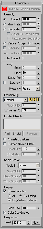

Parameters rollout
This rollout is available on the Modify panel when you select the Birth Texture icon or click Initialization Parameters (see preceding).
[concentric color box]
The color of this icon indicates the calculation status of particle seeds. When blue-green, the operator has generated particle seeds according to the current set of parameters, and is up to date. When red, parameters have been changed since the last initialization, and you must update the particle seeds by clicking Initialize Particle Emission.
Click to calculate particle seed timing, placement and scaling according to the current set of parameters. If the emitters geometry or textures are complex, the initialization process can be lengthy. The overall progress of calculation is indicated as a percentage in the status bar. When calculation is complete, the Green/Red concentric color box turns green.
This option is available only after you have picked at least one emitter in the Emitter Objects group.
Quantity group
The Birth Texture operator offers several methods for determining the quantity and placement of particle seeds. In general, each of these methods covers the emitter with the maximum number of particle seeds allowed for the chosen method, then the texture's coloring or brightness defines if and when a seed is converted to a particle.
Note: These parameters control particle seeds, not the particles themselves. A particle seed is converted to a particle based on the parameters in other rollouts, and on the color and brightness of the texture itself.
Choose one option in this group:
  • Amount Randomly covers the emitter surface with the specified number of particle seeds. Then the animated texture is used to define if and when a seed generates a particle. This option can be used when you don’t want particles to be generated in the same place multiple times when the texture is animated.
  • Max. Rate Sets the maximum number of particles that can be generated per frame over the entire surface, when the texture color exceeds the Whiteness value. The rate is expressed in particles per frame. First, the emitter surface is randomly covered with seeds at the Max. Rate, starting with the Start frame. Then the texture for the current frame defines at that frame whether each seed generates a particle. The unused seeds are not used. At the next frame, a new set of particle seeds is generated. This option generates particle seeds in this manner from the Start frame to the Stop frame. This option can be used when it doesn't matter whether particles are generated in the same place multiple times.
  • Separate Sets the distance by which particle seeds are separated, in units. The emitters surface is evenly covered with particle seeds, and the seeds are placed in such a way that they are separated by the Separate value. Then the animated texture is used to define if and when a seed generates a particle. The Separate option guarantees the absence of dense clusters and overlapping particles. This option guarantees that particles will not be generated in the same place multiple times.

Timing group
These aparameters determine the time interval over which particles are generated. The operator analyzes the emitter texture over the time interval, using the data to define the precise birth moment for each particle. The timing for each particle is stored as a floating-point value ranging from 0.0 to 1.0. This indicates its timing relative to the start (0.0) or end (1.0) of the interval and makes it possible to adjust the overall timing of the particle emission without recalculation.
You can also adjust particle timing in Particle View by changing the Emit Start and Emit Stop values.

Emission By group
Particle seeds are converted to particles when the particle seeds are located on an area of the texture that exceeds the Whiteness value. The parameters in this group define how Particle Flow interprets the texture information to see if it exceeds the Whiteness value.
The Emission By choices are as follows:
Use these controls to assign objects to be used as particle emitters.

Scale Factor group
The operator can initialize particle scaling according to the characteristics of the texture the particles are generated from. So, for example, you can vary the sizes of particles emitted from different parts of the surface with a gradient map. The scale value calculation uses the texture's state at the current frame, disregarding any animation the texture has. Since a color has three floating-point values, each value defines a different component of the scale vector. To have a uniform scale factor, use textures with no hue (black/gray/white gradients).

Display group
The operator is able to show the particles in interactive, non-history-dependent mode. Usually, if you want to see particle animation, you have to place the operator into an event that is wired to an active PF Source event. However, this might require heavy calculation for history-dependent particle animation. The parameters in the Display group give you the ability to see how particles will be created without the overhead of generating a particle system.

Uniqueness group
The Uniqueness settings enable you to change the randomization of the particle generation where appropriate.
Seed
Specifies a randomization value.
