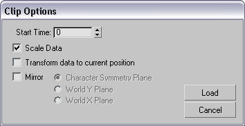

Clip Options dialog
This dialog opens when loading a saved clip.
- Start Time
The frame at which the clip will start.
- Scale Data
When on, the size of the saved data is adjusted to the CATUnits Ratio setting of the current rig. See Understanding CATUnits.
- Transform data to current position
When on, the animation is offset to start at the current position of the rig.
- Mirror
When on, the animation data is mirrored across the chosen coordinate plane:
- Character Symmetry Plane The character is mirrored left to right across itself.
- World Y Plane The character is mirrored across the World YZ plane.
- World X Plane The character is mirrored across the World XZ plane.
