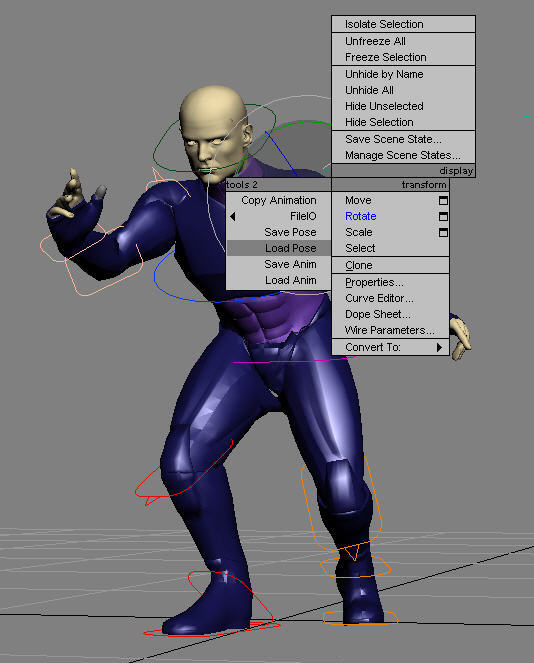

To save a full-rig pose:
    With a hub selected, you can save a pose for an entire rig.
  1. With Animation mode active, select a hub in your rig, such as a pelvis, ribcage or head object.
  2. Right-click the selected hub object or its gizmo, and choose Save Pose from the bottom-left quadrant.
    This opens the Save Hub Pose dialog.
  3. On the Save Hub Pose dialog, turn on Save Whole Rig. Change the name if you like, and then click OK.

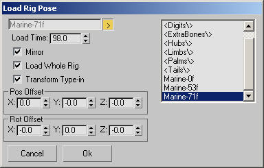

To load a full-rig pose:
    With a hub selected, you can load a pose for an entire rig.
  2. Right-click the selected hub object or its gizmo, and choose Load Pose from the bottom-left quadrant.
    This opens the Load Hub Pose dialog.
    The default pose-file name is that of the rig you saved most recently.
  3. Turn on Load Whole Rig, if necessary.
  4. To change the pose to load, click the button to the right of the pose name and then choose a different pose from the list.
  5. On the Save Hub Pose dialog, turn on Save Whole Rig. Change the name if you like, and then click OK.
  6. A ghost is displayed for the ghost at the time is it being loaded. Options include mirroring the pose, and you can use the Load Time setting to specify the time at which the pose is loaded. Also, if you turn on Transform Type-in, you can change any of the transformation options for the loaded file.
  7. Click Ok to load the pose.

Load Pose dialog
Load Pose, like all dialogs in this feature, is non-modal. This means that you can rotate the viewport, scrub the time slider, and validate your results as you edit the parameters of the loaded pose. The only exception is that deselecting the selected bone cancels the load operation.
[name field]
The name of the pose file to load.
By default, this is the most recently saved file, but you can choose a different one by clicking the button.
Expands the dialog and opens a list that shows all saved poses in the default location. Choose a different pose from the list or navigate to another location by double-clicking the <..> entry at the top of the list.
Load Time
The time at which the pose will be loaded. You can edit this value interactively to change the time the animation is loaded.
Mirror
Toggles whether the pose is mirrored when loaded.
Mirroring is not available when loading limb, palm, or digit poses.
Load Whole Rig
Toggles whether you are loading a rig or a body-part pose. Available only when loading a hub pose.
Transform Type-in
Lets you apply a transformation to the loaded pose. Use the Pos(ition) and Rot(ation) Offset fields to enter values for the transformation of the pose data from the saved version. You can, for example, ensure that the pose is loaded in its exact original location for creating looped motions, or with a specific translation and rotation offset.
Cancel
Cancels the load operation and closes the window.
If you deselect the selected CATBone, the load is automatically canceled.
OK
Loads the pose using the current settings.

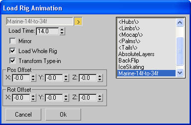

Animation
Saving and loading animation is similar to saving and loading poses.
Save Animation dialog
The Save Pose dialog defines a file name and path. When using the copy and paste anim system, CAT saves clip files.
[name field]
The name of the animation file to save. The name of the file is generated from the name of the bodypart you are saving and the frame at which you save the file.
To change the name, edit the field, or to change the name and/or location, click the “b” button.
b
Click to browse for a different save path, and optionally change the file name.
Save Whole Rig
Available only when saving an animation from a hub. When on, the animation is saved for the entire rig rather than just the hub.
Start Time
The first frame of the range to save.
End Time
The last frame of the range to save.
Load Animation
The Load Animation settings are the same as those for Load Pose.
