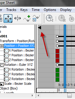

Toggling the Controller Window
Available in the Key window of the Track View dialog (in both Curve Editor and Dope Sheet modes) is a control for toggling the Controller window. The control takes the form of a black triangle that points to the left when the Controller window is visible and to the right when it is hidden, as shown in the preceding illustration. To toggle the Controller window, click the triangle. By using this feature to hide the Controller window, you can maximize the available space for editing keys.

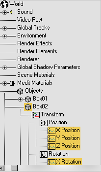

- Open the Track View - Curve Editor and press Ctrl+A (Select All).
In the Track View Controller window, locate the box and sphere objects. Notice that both their icons are highlighted as well as the sphere's XYZ position tracks. The box’s tracks aren’t highlighted because they don’t contain any animation.
Interface
Scene Hierarchy
World-
World is the root of the scene hierarchy. This track collects all keys in your scene as a single range for quick global operations.
To make the World subtracks visible, open the Filters dialog and turn on Global Tracks in the Show group. These include Sound, Environment, Medit Materials, and Scene Materials. Modify Subtree in Edit Ranges mode causes the World track to include the range of all tracks in the Objects branch as well.
