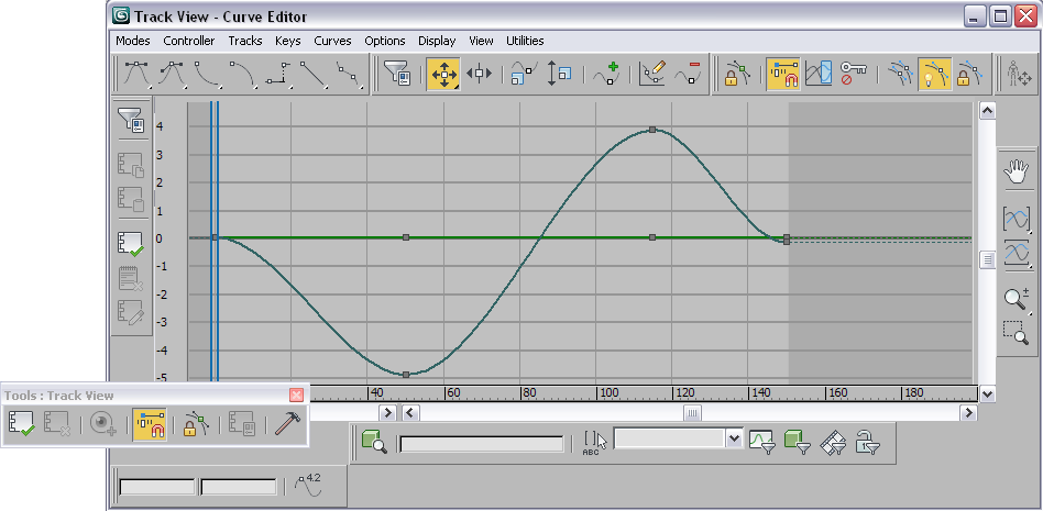

The Track View user interface is fully customizable. There are many ways you can change the UI to suit your needs.
A customized Track View user interface:
• Controllers toolbar docked left
• Controller window (Hierarchy) hidden
• Tools toolbar floating
• Navigation toolbar docked right
You can hide or display UI elements as you need to use them. Customization tools are available from the Track View menu bar or from several Track View toolbars. You can float or dock the toolbars to the top, bottom, left, or right of the application window, for example, floating a toolbar so it is closer to where you are working.
To customize the Track View UI, right-click the menu bar or the blank space to the right of the Track View toolbars. A right-click menu opens with customization tools.
