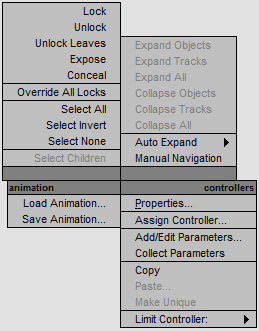

Controller window quad menu

In the Controller window, if you hold down Alt+right-click you can display an alternate quad menu, which is also integrated with the main quad menu.
Alt+right-click for alternate quad menu for Controller window
