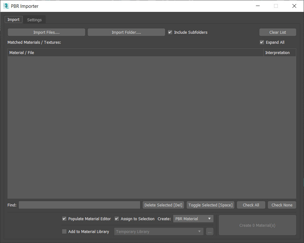

PBR Importer-Import tab
Import Files
Navigate to and select specific files to import.
Note: You can also drag and drop files directly into the Matched Materials/Textures list.
Import Folder
Navigate to and select a folder containing PBR material files to import.
Note: You can also drag and drop a folder directly into the Matched Material/Textures list.
Include Subfolders
Adds files contained in subfolders.
Clear List
Removes all files from the Matched Materials/Textures list.
Expand All
Shows all the material's sub-components in the list.
Lists the files/folders. Select the ones you want to use.
Find
Searches the Matched Materials/Textures list for a file you specify.
Delete Selected
Removes the selected file/folder from the Matched Materials/Textures list.
Note: You can also press Delete.
Toggle Selected
Selects or clears the file/folder in the Matched Materials/Textures list.
Note: You can also press the Spacebar.
Check All
Selects all the files and folders in the Matched Materials/Textures list.
Check None
Clears all selected files and folders in the Matched Materials/Textures list.
Populate Material Editor
If you are using the Compact Material Editor, each imported material is written to a material sample slot. This overwrites materials already in the material editor.
If you are using the Slate Material Editor, a view named PBR Importer is created and populated with the materials.
Assign to Selection
Adds the imported materials to the current selection. If multiple materials are selected they are assigned to objects in a round-robin fashion. If there are more materials than selected objects, teapot placeholders are created to show the materials.
Create
Options include PBR Material and Physical Material. Default=PBR Material.
Add to Material Library
Adds the materials to a material library file you specify.
Create Material(s)
Creates the materials based on your selections and settings.
Note: Be sure to check the settings tab before clicking Create Material(s).

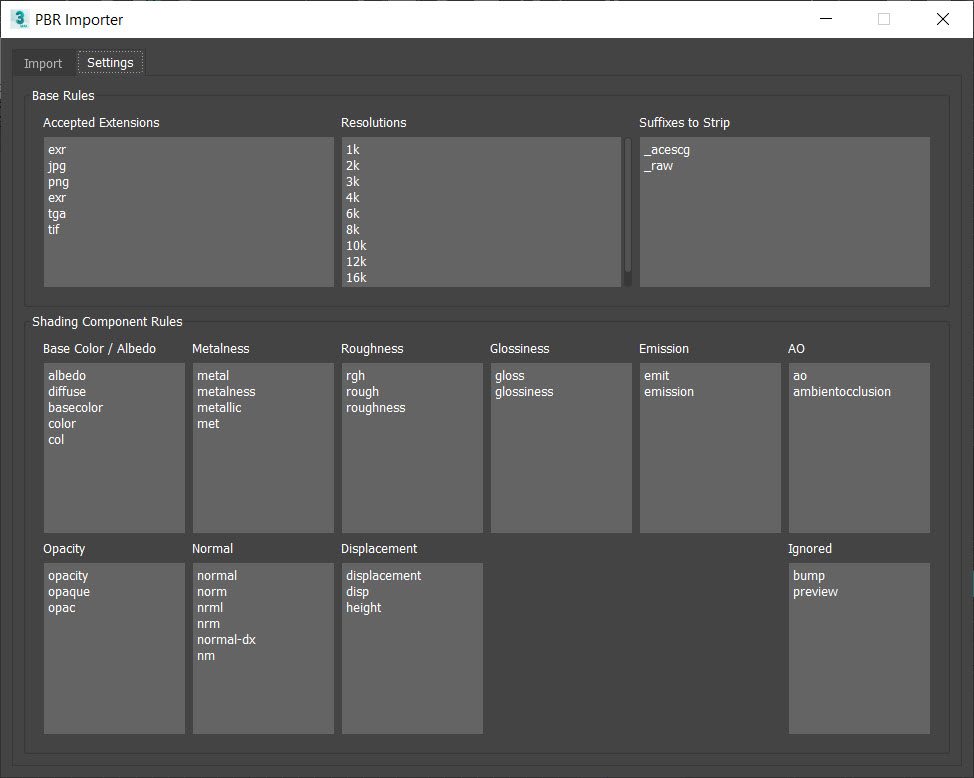

PBR Importer - Settings tab
Add or remove items from these settings.
Base Rules
Accepted Extensions
Only files with these extensions are used, all others are ignored.
Resolutions
Only files with these resolutions are used. If multiple textures are found with resolution being the only difference, separate materials are created.
Suffixes to Strip
These file suffixes are removed before matching with the various shading components. This is for when there are additional suffixes not related to the shading component, such as color space name.
Shading Component Rules
Base Color/Albedo
If the suffix matches what is listed (after any suffixes are stripped), it is treated as a diffuse/base color component.
Metalness
If the suffix matches what is listed (after any suffixes are stripped), it is treated as a metalness component.
Roughness
If the suffix matches what is listed (after any suffixes are stripped), it is treated as a roughness component.
Glossiness
If the suffix matches what is listed (after any suffixes are stripped), it is treated as a glossiness component.
Emission
If the suffix matches what is listed (after any suffixes are stripped), it is treated as a emission component.
AO
If the suffix matches what is listed (after any suffixes are stripped), it is treated as ambient occlusion.
Opacity
If the suffix matches what is listed (after any suffixes are stripped), it is treated as a opacity.
Normal
If the suffix matches what is listed (after any suffixes are stripped), it is treated as a normal map.
Displacement
If the suffix matches what is listed (after any suffixes are stripped), it is treated as a displacement map.
Ignored
If the suffix matches what is listed (after any suffixes are stripped), the file is ignored.
