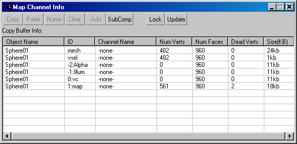

The utility's Map Channel Info dialog shows all the channel data for selected objects. It displays the number of channels, the number of vertices per channel, and how much memory the channel uses. It also lets you name channels, as well as clear (or delete), copy, and paste channels. Each of these actions except renaming puts a modifier on the stack to achieve the results.

The primary user interface of the Channel Info utility is the Map Channel Info dialog, which you open by clicking the utility's Channel Info button on the command panel. This modeless dialog shows information about all map channels belonging to the current selection, at the object level. If you change the selection, the dialog automatically updates to reflect the selection.
The dialog consists of two parts: a button toolbar at the top, and a tabular display of map channels belonging to each object in the current selection.

Channel Info table
The table functions similarly to a spreadsheet. If not all rows or columns are visible, you can scroll the table using standard methods, including rolling the mouse wheel for vertical scrolling. To highlight a row, click anywhere in the row. You can highlight only one row at a time. To resize a column, drag the vertical divider at the right of the column heading. To automatically set a column's width to the size of the longest entry, double-click the vertical divider to the right of the column heading.
Following is a brief explanation of each of the columns in the table:
- Object Name
The name of the object. If you change the name in the Modify panel, click the dialog's Update button to display the new name in the dialog.
- ID
The type of channel. The available channel types are:
- mesh/poly The object's mesh or poly data, depending on whether it's a mesh or poly object: vertices and faces. You can copy this channel and paste it to any other three-component channel.
This channel is not available for patch objects.
- vsel The vertex selection. You can copy this channel and paste it to other channels' subcomponents.
- -2:Alpha The vertex alpha channel. You can transfer all vertex alpha values between objects with the same topology by copying and pasting this channel.
You can apply vertex alpha information to objects with the VertexPaint modifier, and to editable surfaces with the Vertex Properties settings (editable poly) and Surface Properties (editable mesh and editable patch).
- -1:Illum The vertex illumination channel. You can transfer all vertex illumination values between objects with the same topology by copying and pasting this channel.
You can apply vertex illumination information to objects with the VertexPaint modifier, and to editable surfaces with the Vertex Properties settings (editable poly) and Surface Properties (editable mesh and editable patch).
- 0:vc The vertex color (vc) channel. You can transfer all vertex color values between objects with the same topology by copying and pasting this channel.
You can apply vertex color information to objects with the VertexPaint modifier, and to editable surfaces with the Vertex Properties settings (editable poly) and Surface Properties (editable mesh and editable patch).
- 1:map The default mapping channel. You can transfer all UVW mapping information between objects with the same topology by copying and pasting this channel.
You can create additional mapping channels by various means, including with the Channel Info utility.
- Channel Name
The name of the channel. By default, a channel has no name, as indicated by the entry “-none-”. To name or rename the channel, click the channel to highlight it and then click the Name button at the top of the dialog, or right-click the channel and choose Name from the right-click menu.
Note: Most channels can be split into subcomponents. You can name the subcomponents separately from the channel itself. - Num Verts
The number of vertices in the channel. To paste one channel to another, they must have the same number of vertices.
Some channels have faces but no vertices. This is typically the case with Alpha, Illumination, and vertex color channels in newly created non-poly objects. In such cases, these channels function as placeholders for the corresponding data should you add it later. They do consume a small amount of memory, so if you have no intention of using a channel, you can save some memory by converting the object to Editable Poly.
- Num Faces
The number of faces in the channel.
If a channel has faces but not vertices, that means it's a placeholder. See Num Verts, preceding, for more information.
- Dead Verts
The number of unused map vertices in the channel. Such vertices can be left over from sub-object editing.
- Size(KB)
The approximate amount of memory consumed by the channel. Use this figure to check for unused channels that are using up memory.
