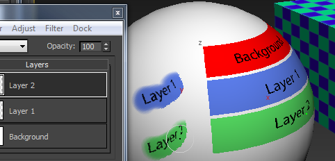

- Open the Paint Behavior rollout and note that Clone Source is set to Current Layer.
- Click
(Clone) and choose the material’s Diffuse map.
The Layers dialog opens, showing the bitmap’s layers.
- Choose a layer to clone from by clicking it in the Layers list. In the preceding illustration, Layer 1 is active.
You’re now ready to pick the texture to clone.
- Position the mouse cursor over the texture to clone in the active viewport, press and hold
Alt, click the left mouse button, then release
Alt.
A green dot appears on the texture where you clicked, showing the center of the area to be cloned.
You’re now ready to paint using the cloned image.
- Move the mouse around over the selected object.
The area of the cloned texture that fits inside the brush circle moves with the brush as a preview, while the green dot remains stationary.
Cloning from Layer 1 after Alt+clicking the "a"
- Click once on the surface of the selected object, then release the mouse button.
The cloned image is copied to the selected object.
Note: In regular usage it’s not necessary to click once to start cloning a texture; you can drag instead, as with other painting tools. We suggest clicking first in this procedure in order to show how the Clone tool works.All subsequent painting with the Clone brush, before exiting the tool or changing a setting, copies the texture relative to this point.
- Move the mouse around near the point you just clicked.
The brush now appears to be sliding over the cloned texture as the green dot also moves, previewing exactly which portions of the texture will be cloned when start painting again.
Note: When the mouse cursor is not over the selected object, the green dot turns red to indicate that painting isn't possible here.
The green dot turns red when away from the sphere.
- Drag to paint some more of the cloned texture.
Continuing to clone Layer 1
Only the contents of the current layer are cloned.
- On the Layers dialog, choose a different layer.
The green dot disappears because you've changed a setting. The Clone brush is still active, but if you tried to paint now, no paint would be deposited because the clone point has been lost. However, at any time you can specify a new clone point in the current layer by Alt+clicking again.
Cloning from Layer 2
- On the Paint Behavior rollout, set Clone Source to All Layers and again Alt+click the area to clone from.
- Paint with the Clone brush.
Now you’re cloning from every layer, not just the active one.
Cloning from all layers
Tip: The Clone tool copies the texture exactly as it appears in the viewport, complete with curvature, foreshortening, and so on. To paint with an undistorted texture, set it up that way in the viewport. For example, use a viewport background image, or map the texture to a plane parallel to the viewing plane in an orthographic viewport. - On the Paint Behavior rollout, set Clone Source to Screen and Alt+click the second object from step 1.
- Paint on the selected object with the Clone brush.
Now you’re cloning from the entire screen.
Cloning from the screen
Note: When Clone Source is set to Current Layer or All Layers, cloning a texture does not incorporate viewport shading, but when set to Screen, it does. - Continue painting. To finish using Clone, right-click in the viewport or click the
(Clone) button again to toggle it off.
Because Save Texture is off, your painting is discarded.

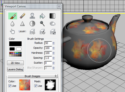

Paint - Starts the Paint tool for adding color to an object surface. You can paint with solid colors, or with a bitmap in the form of a
brush image.
You can paint anywhere on the model, changing the color, opacity, brush image and other settings and navigating the viewport as you go.

Brush Settings group
- Radius
- The radius of the brush sphere in pixels. To change the radius interactively in the viewport, hold
Ctrl+Shift while dragging vertically.
Note: As noted, the Viewport Canvas brush is spherical in shape, so when painting thin sections of 3D objects you might find that the brush penetrates the object and applies paint to two or more surfaces simultaneously. If this situation occurs, try reducing the Radius setting or using 2D View.
- Opacity
- Sets the opacity for the for all tools except Erase. When Erase is active, this field sets the value for the Erase tool only. A value of 100 is fully opaque.
To change the opacity interactively in the viewport, hold Alt+Shift while dragging vertically.
- Hardness
- The falloff at the brush edges. A high Hardness value yields a sharp-edged brush; the lower the value, the softer the edge.
To change the hardness interactively in the viewport, hold Ctrl+Alt while dragging vertically.
- Spacing
- When painting a continuous stroke by dragging, the distance relative to the brush radius between each copy of the brush deposited along the stroke. The default value, 0.25, means the copies are deposited one-fourth of the radius apart. To deposit copies edge-to-edge, set Spacing to 2.0.
- Scatter
- Randomizes the placement of each copy of the brush during a stroke. The higher the Scatter value, the greater the randomization.
- Blur/Sharpen
- The amount of blurring or sharpening applied by the Blur or Sharpen tool. Available only for those tools.
- 2D View
- Toggles the 2D Paint window for painting on a rectangular canvas.
- Layers Dialog
- Toggles the Layers dialog for managing bitmap layers.
