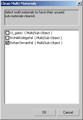

    The Clean Multi-Materials dialog opens, displaying the following:
    The dialog displays a list of all Multi/Sub-Object materials that contain unassigned sub-materials. All the Multi/Sub-Object materials are automatically turned on, and thus subject to cleaning.

The Clean dialog presents you with a list of all Multi/Sub-Object materials in the scene that contain unassigned sub-materials. You can then select materials from which to remove unassigned sub-materials.
The dialog consists of two parts: a status field at the top and a list of Multi/Sub-Object materials.
[status field]
The Status Field is not interactive. It displays prompts about the unused materials.
[materials list]
This list displays Multi/Sub-Object materials that have sub-materials that are not currently being used in the scene. When the Clean MultiMaterial utility opens, it lists all Multi/Sub-Object materials with unused sub-materials and turns them on to be cleaned. Click the checkbox next to a material name to turn it off and prevent the utility from cleaning it.
