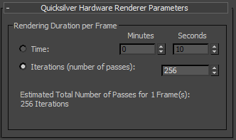

Quicksilver Hardware Renderer Parameters Rollout
The main rollout for the Quicksilver hardware renderer lets you adjust render quality by setting either the time to spend on rendering, or the number of iterations to perform.
  • Main toolbar > (Render Setup) > Render Setup dialog > Common panel > Assign Renderer rollout > Choose Quicksilver Hardware Renderer as the active production renderer. > Renderer panel > Quicksilver Hardware Renderer Parameters rollout.
Rendering Duration per Frame
Lets you specify how to control the process of rendering.
  • Time Set the duration of the rendering in Minutes and Seconds. Default = 10 seconds.
    Note: The number of iterations in a particular time interval depends on CPU/GPU speed and on available memory.
  • Iterations (number of passes) (The default.) Set the number of iterations to run. Default=256.
