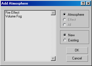

The Add Atmosphere dialog lets you associate an atmosphere with the Atmospheric Apparatus.
  • Select Atmospheric Apparatus object. > Modify panel > Atmospheres & Effects rollout > Add button
Interface
[list of atmospheres]
Displays the atmospheres that you can associate with the apparatus.
[display group]
Always set to Atmosphere.
[new or existing group]
These radio buttons choose between new or existing atmospheres.
  • New Lists only new atmospheres.
  • Existing Lists only atmospheres that have been already assigned to other apparatuses in the scene.
    Adding an existing atmosphere creates a new atmosphere whose settings are initially identical to the previous one.
