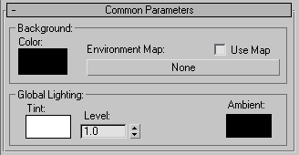

Common Parameters rollout
Background group
Color
Sets the color for the scene background. Click the color swatch, then select the color you want in the Color Selector. You can animate the color effect by changing the background color at a nonzero frame with the Auto Key button on.
Environment Map
The Environment Map button displays the name of the current environment map, or “None” if none has been assigned. The map must use Environmental mapping coordinates (spherical, cylindrical, shrink wrap, or screen).
To assign an environment map, click the button and use the Material/Map Browser to choose a map
You can also drag and drop a map from a Material Editor sample slot. If the Slate Material Editor is open, you can drag from a map node's output socket, then drop onto this button. You can also drag and drop from a map button in the Material Editor or anywhere else in the 3ds Max interface. When you drop a map onto the Environment Map button, a dialog asks if you want the environment map to be a copy (independent) or an instance of the source map.
The default Mapping mode for an environment map is Spherical Environment.
To adjust the environment map's parameters (for example, to assign a bitmap or change the coordinate settings), drag the Environment Map button to the Material Editor, and be sure to drop it as an instance. In the Compact Material Editor, drop the map over an unused sample slot. In the Slate Material Editor, drop it over the active View.
Note: If your scene includes animated bitmaps, including materials, projector lights, environments, and so on, the animation file is reloaded once per frame. Rendering performance slows down when your scene uses multiple animations, or the animations are themselves large files.
Use Map
Uses a map for the background rather than the background color. Assigning a map turns on this checkbox. You can turn it off to revert to using the background color.
Global Lighting group
Tint
Tints all lights in the scene (except for ambient light) if this color is anything other than white. Click the color swatch to display the Color Selector, on which you can choose the tint color. You can animate the tint color by changing it at a nonzero frame with the Auto Key button on.
Level
Multiplies all lights in the scene. A Level of 1.0 preserves the original, individual light settings. Increasing the Level raises the lighting for the overall scene, and decreasing the Level lowers the overall lighting. This parameter is animatable. Default=1.0.
Ambient
Sets the color for the ambient light. Click the color swatch, and choose the color you want in the Color Selector. You can animate the light effect by changing the ambient light color at a nonzero frame with the Auto Key button on.

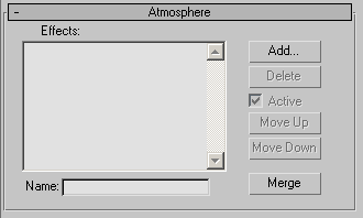

Atmosphere rollout
Effects list
Shows the queue of effects that were added. The effects are evaluated in linear order within the scene during rendering. Depending on the selected effect, the Environment dialog adds the appropriate rollout for the effect's parameters.
Name field
Gives a custom name to effects in the list.
For example, you might have different custom settings for different kinds of fire, that you could name Spark and Fireball.
Add
Displays the Add Atmospheric Effect dialog (all currently installed atmospheric effects). Select an effect and click OK to assign an effect to the list.
Delete
Deletes a selected atmospheric effect from the list.
Active
Sets the on/off state for the individual effects in the list. This is a convenient way to isolate effects within a list of complicated atmospheric functions.
Move Up / Move Down
Moves the selected item in the list up or down to change the order in which the atmospheric effects are applied.
Merge
Merges effects from other 3ds Max scene files.
When you click Merge, the Merge Atmospheric Effects dialog appears. Choose a 3ds Max scene, and then click Open. The Merge Atmospheric Effects dialog then lists the effects in the scene that can be merged. Select one or more of the effects, and then click OK to merge them into the scene.
The list shows the names of the atmospheric effects only, but when you merge an effect, the lights or gizmos bound to that effect are merged as well. If one of these objects you’re merging has the same name as one already in the scene, an alert appears giving you the following choices:
  • You can rename the incoming object by changing its name in the editable field.
  • You can Merge the incoming object without renaming, resulting in two objects in the scene with the same name.
  • You can delete the existing object in the scene by selecting the Delete Old button.
  • You can select Apply To All Duplicates, which performs the same action to all subsequent matching objects.
