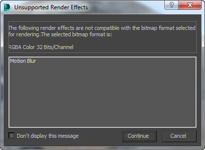

Rendered Image Effects and 32-Bit Floating-Point Output
Most rendered image effects in 3ds Max are not compatible with 32-bit floating-point output. If you render using one or more unsupported effects, the following dialog appears:
You can choose to continue rendering without the unsupported effects, or cancel the render.
These render effects support 32-bit floating-point output:
- Hair And Fur
- File Output
- Color Balance
These render effects do not support 32-bit floating-point output:
- Blur
- Brightness and Contrast
- Depth of Field
- Film Grain
- Lens Effects
- Motion Blur
