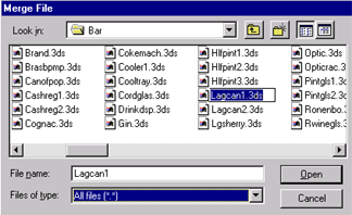

Merging Scenes Together
Use Merge to combine multiple 3ds Max scenes into a single large scene. When you merge a file, you can select which objects to merge. If objects being merged have the same name as objects in your scene, you have the option to rename or skip over the merged objects.
