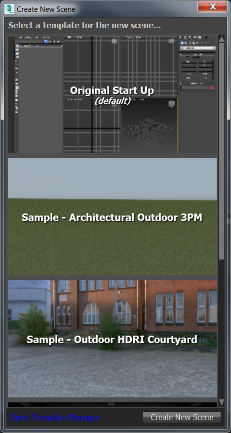

Templates help you quickly begin work on the kind of scene you want to create.
  • Default menu: > Menu bar > File > New > New from Template > Open Template Manager
  • Alt menu: > Menu bar > Scene > Tools (Scene Set) > Manage Templates
The template manager lets you choose from a variety of scene setups, to help you get started with work on a new scene.
The information saved in a template can include:
  • Display Units and System Units
  • Renderer and rendering resolution
  • Scene geometry, which can be animated
  • The active Workspace
  • The order of rollouts in the interface
  • ViewCube settings
  • Viewport layout and settings
  • User paths.
