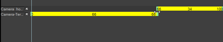

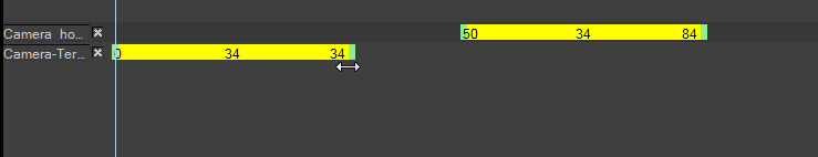

When multiple tracks are selected, you can do these operations:
  • Ctrl+dragging one track slides the whole selection.
  • Ctrl+dragging an endpoint of one track resizes all tracks.

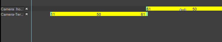

  • If the endpoint and startpoint of two tracks overlap, Alt+dragging one point changes the frame for the transition. Dragging one of the selected tracks has the same effect.
