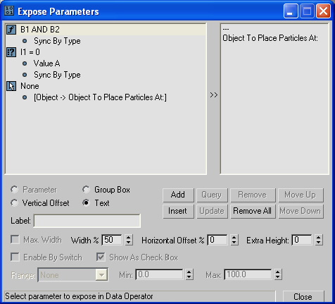

The standard procedure when exposing parameters is to highlight a parameter in the left-hand column, set the parameters in the lower part of the dialog, and then click Add.

The radio buttons above the Label field let you define explicitly the type of control to be exposed. The available radio buttons in this set depend on the type of control highlighted in the list. The choices are:
  • Parameter
  • Group Box
  • Vertical Offset
  • Text
Label
The name the exposed parameter will have in the operator UI in Particle View.

Add
Exposes the parameter. Click Add to place the parameter highlighted in the left-hand column at the end of the list in the right-hand column and on the Parameters panel, using the specified settings.
Note: After you add the first parameter, a "---" entry automatically appears at the beginning of the list. This represents a blank line above the topmost parameter.
Query
Updates the dialog settings with the values from the highlighted parameter in the right-hand column.
Remove
Deletes the highlighted parameter in the right-hand column.
Move Up
Moves the highlighted parameter in the right-hand column one position higher.
Insert
Adds the parameter above the highlighted position in the list, rather than at the end.
Update
Revises the highlighted parameter in the right-hand list, using the current settings. To use this, highlight a parameter, click Query if necessary to get the current settings, change the settings, and then click Update.
Remove All
Clears the right-hand column and deletes the Parameters rollout.
Move Down
Moves the highlighted parameter in the right-hand column one position lower.
