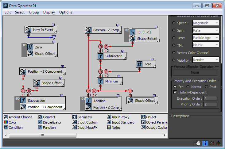

Also, the Execution And Priority Order group also has Pre/Normal/Post radio buttons. This option defines the processing order on a higher level. If it set to Pre then this output is done before any operators in the current event are executed. If it is set to Normal, then the output suboperator is executed in the regular order, in-between the other operators in the same event. If it is set to Post then the output is processed after all operators and all tests in this particle system have finished their jobs for this integration step.
For an example that illustrates Pre/Normal/Post usage, open the included file CollisionAsBody.max.
This example uses the Data operator to produce "cheap and quick" full-body collision. As you probably know, particle systems in 3ds Max treat particles as point entities with regard to collisions and deflectors. Therefore, if a particle has a shape with visible size, the shape penetrates the deflector surfaces, which can ruin the overall visual effect. The example shows how to wire particle data to offset the particle position by the amount of the inter-penetration.
First, we create a custom data channel to store real values, as the position offset needed to avoid the penetration. For all new particles we initiate this value to zero—see data block 01.
After all the other operators and tests have done their job, we calculate the amount of penetration, and offset particle position in Post phase. This way particle positions are adjusted to avoid penetration and the particles are ready for rendering. The Output operators on the right side do their jobs in the Post phase.
Then, in Pre phase, we need to move particles back, to their no-offset positions, for the collision tests to continue their job as if nothing has happened.
