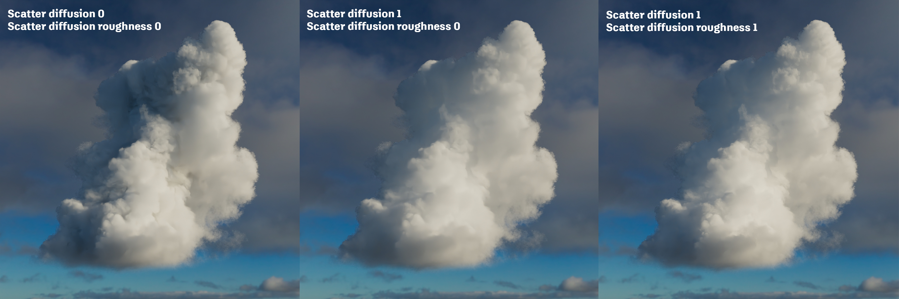

Scattering diffusion in volumes
Two new parameters in standard_volume improve how light is scattered in volumes. Using those parameters can help achieve high-scattering looks with fewer volume bounces and without adding energy. (ARNOLD-14482)
  • scatter_diffusion accelerates scattering in volumes
  • scatter_diffusion_roughness accelerates scattering further on anisotropic volumes and can help achieve realistic looking clouds with fewer bounces
  • gain and bias curves can further tweak the effect of both parameters

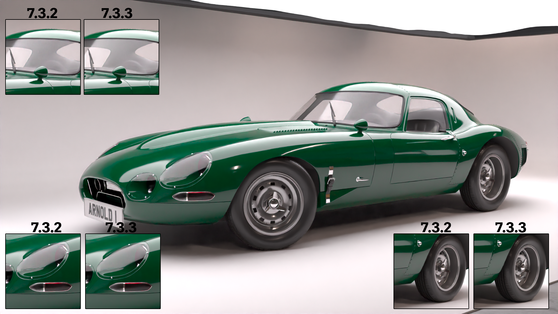

Improved quality with Intel Open Image Denoise 2.3.0
The updated Intel Denoiser improves denoising quality and can produce sharper results with less artifacts on scenes with specular reflections and transmission. For more information about changes in this version, see the OIDN release notes (ARNOLD-15059).

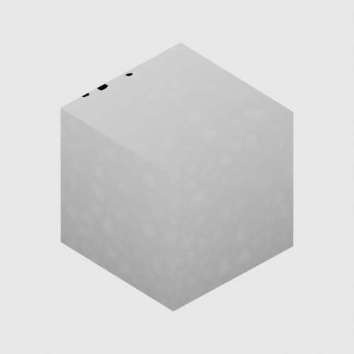

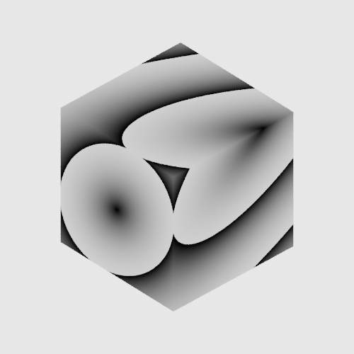

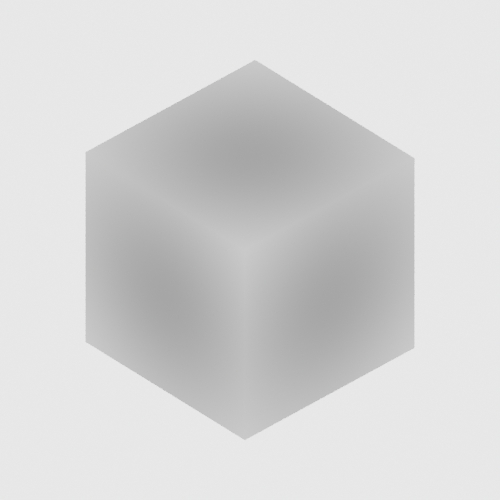

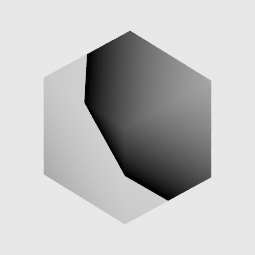

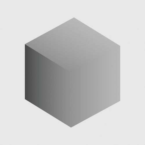

Improved ramp shaders
  • 3D ramp modes: Ramp shaders have three new modes: 3d_linear, 3d_spherical, and 3d_cylindrical. These modes calculate the ramp input from the distance between the shading point and a user-defined reference point or line. (ARNOLD-15051, ARNOLD-15196)
    3d_linear 3d_spherical 3d_cylindrical

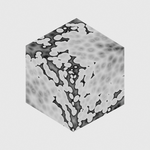

  • Ramp offset: Ramp shaders can now offset the input value, which allows you to add noise to the ramp. (ARNOLD-15052, ARNOLD-15197)
    worley noise (3d_spherical) cell_noise (u) alligator noise (v)

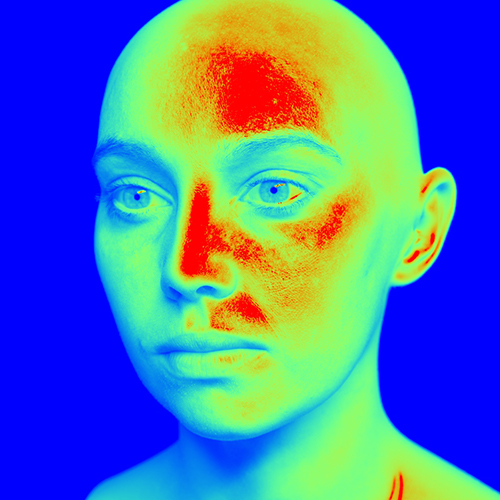

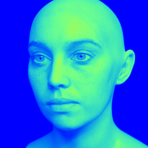

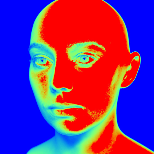

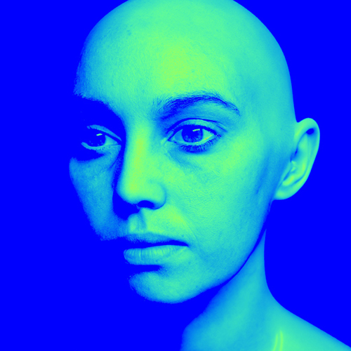

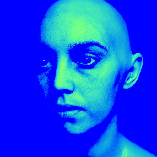

Heatmap Imager Mode
The tonemap imager now has a heatmap mode that creates a spectrum based on a looked-up AOV quantity. The color ranges from blue (at minimum) to red (at maximum). (ARNOLD-15123)
