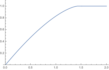

Use the tonemap imager to artistically modify the image's tone mapping using a Filmic or a modified Reinhard curve.
Both the Strength and the Length need to be different from 0, for the Toe and Shoulder to make a difference.

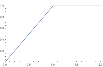

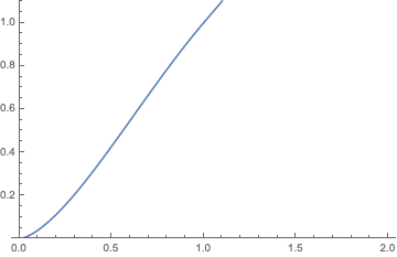

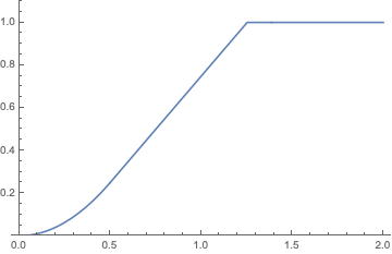

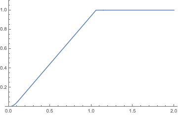

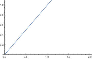

Filmic Toe Strength
Amount of curvature for the tonemap curve in the darker values.
| 0 (default) | 0.5 | 0.9 |
| 0 (default) | 0.5 | 1 |
Filmic Toe Length
Amount of darker values affected by the toe.
| 0 | 0.5 (default) | 1 |
toe strength: 0.5

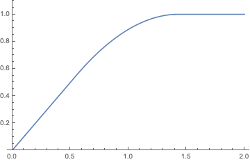

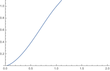

Filmic Shoulder Strength
Amount of curvature for the tonemap curve in the brighter values.
Filmic Shoulder Length
Amount in f-stops of brighter values affected by the shoulder.
Filmic Shoulder Angle
Curve slope when white is reached.
| 0.1 | 0.5 | 1 |

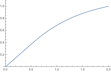

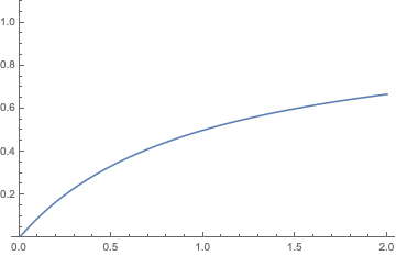

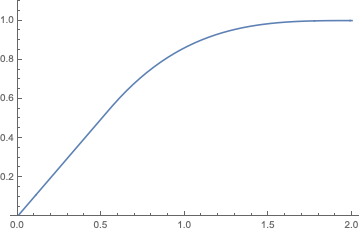

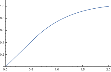

Reinhard Highlights
Reinhard photographic tonemap operator strength.
| 1 (default) | 0.5 | 0 |
Reinhard Shadows
Additional tone mapping control for darker values.

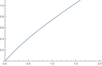

Gamma
Gamma curve exponent for midtones value control.
| 1 (default) | 2.2 | 3 |

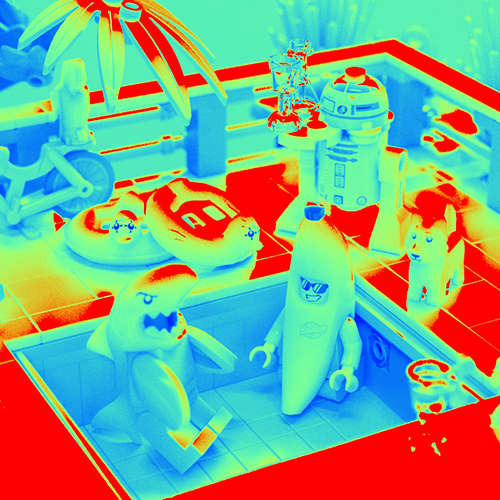

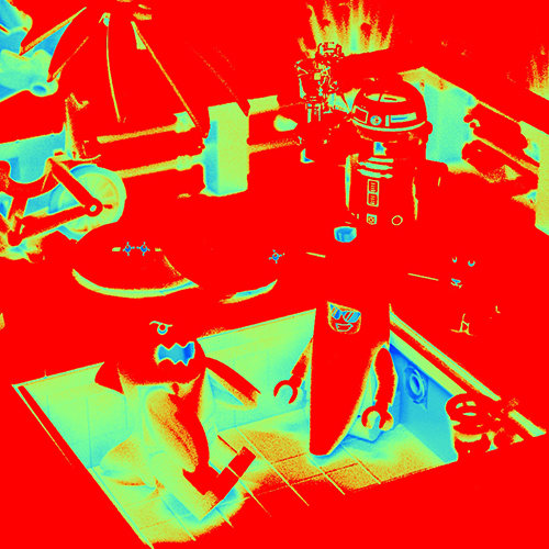

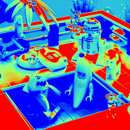

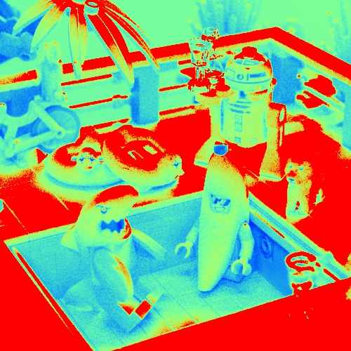

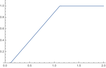

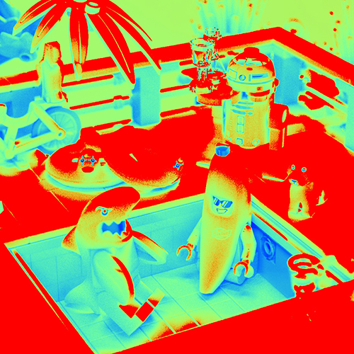

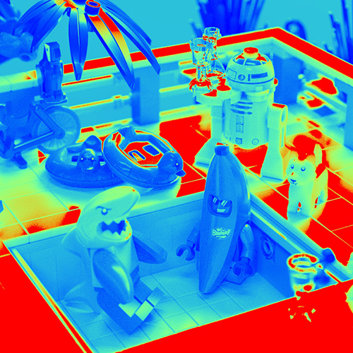

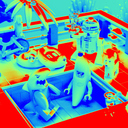

Heatmap
Imager mode that creates a spectrum based on the looked-up AOV quantity. The color ranges from blue (at minimum) to red (at maximum).
Heatmap Min
Heatmap minimum value clamp.
| 0 (default) | 0.1 | 0.2 |
Heatmap Max
Heatmap maximum value clamp.
| 1 (default) | 0.5 | 0.25 |
Heatmap Input Mode
Interpretation of the incoming RGB color value.
- length: vector length of the RGB color values.
- min: minimum value of RGB components.
- max: maximum value of RGB components.
| length | min | max |
