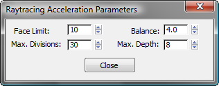

The controls on this dialog let you override the default acceleration values and specify your own requirements. Typically you don't need to use them, but if you are familiar with the requirements of your scene, they can help you optimize raytrace rendering for your specific needs and time constraints.
Raytracing subdivides the scene, organizing it into a tree for raytrace purposes. A node in this tree is known as a "voxel." Voxel trees are dynamic, and you can't explicitly specify the structure of the tree. (If you set Max. Divisions to 2, the tree is an octree, which is possibly a more familiar data structure.)
Interface
- Face Limit
Sets the maximum number of faces allowed in a lattice voxel before it is subdivided. Default=10.
- Balance
Determines the sensitivity of the subdivision algorithm. Increasing this value uses more memory but can increase performance. Default=4.0.
- Max. Divisions
Sets the initial lattice dimension. For example, 4 is a 4 x 4 x 4 lattice. Default=30.
- Max. Depth
Sets the maximum number of lattice subdivisions. Default=8.
