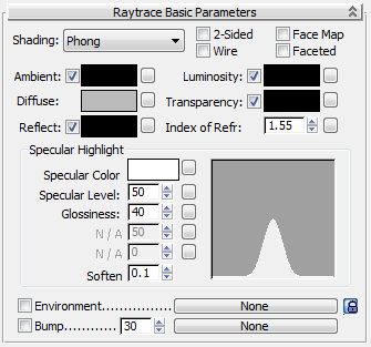

The Raytrace Basic Parameters rollout for a Raytrace material controls the material's shading, color components, reflectivity or refractivity, and bumps.
Interface
The basic parameters in this rollout are similar to the basic parameters for standard materials, but the color components of a Raytrace material behave differently.
As with standard materials, you can use maps for Raytrace color components and various other parameters. The small buttons to the right of the color swatches and parameters take you to the Material/Map Browser, where you select a map of corresponding type. These are shortcuts that also have corresponding buttons in the Maps rollout. If you have assigned a map to one of these colors, the button displays the letter M. An uppercase M means that the corresponding map is assigned and active. A lowercase m means that the map is assigned and inactive (turned off).
- Shading drop-down list
- Chooses a shader. Depending on the shader you choose, the Specular Highlight can change to show the controls for that shader. The alternatives are:
- Anisotropic: For surfaces with elliptical, "anisotropic" highlights
- Blinn: For rounder, softer highlights than Phong shading
- Metal: For metallic highlights
- Oren-Nayar-Blinn: For matte surfaces such as fabric or terra cotta.
- Phong (The default): For surfaces with strong, circular highlights
- 2-Sided
- Same as for standard materials. When on, shades and raytraces both sides of faces. By default, objects are one-sided in order to speed up rendering.
If you have a 2-sided, reflective and refractive object, and you use the raytrace map rather than the material, the raytracer runs until it hits the maximum recursion level. This can be time-consuming.
- Wire
- Same as for standard materials. When on, renders the material in wireframe mode. You can specify the wire size in the Extended Parameters rollout.
With pixels, wires maintains the same apparent thickness regardless of the scale of the geometry or how near or far the object is positioned. With units, the wires appear thinner at a distance and thicker at close range, as if they were modeled in the geometry.
- Face Map
- Applies the material to the faces of the geometry. If the material is a mapped material, it requires no mapping coordinates. The map is automatically applied to each facet of the object.
- Faceted
- Renders each face of a surface as if it were flat.
Note: Raytrace material has the same SuperSampling options as a Standard material.
- Ambient
- This is
not the same as the ambient color for a Standard material. For a Raytrace material, this controls an ambient absorption factor: That is, how much the material absorbs ambient light. Setting Ambient to white is the same as locking the ambient and diffuse colors in a standard material. Default=black.
- Ambient Color checkbox When on, the material uses an ambient color. When off, the material uses a spinner to set a grayscale value only. Default=on.
- Color swatch When on, the color swatch shows the ambient color. To change the color, click the swatch and then use the Color Selector.
- Mono spinner When the checkbox is off, the ambient component is gray, and this spinner lets you adjust the gray value.
Click the map button to assign an Ambient Color map. This button is a shortcut: You can also assign an Ambient map on the Maps rollout.
- Diffuse
- Sets the diffuse color. This is the same as the standard diffuse color. It is the color that the object reflects,
without specular reflection. Reflection and transparency effects are layered on top of the diffuse result. When Reflect is 100% (pure white), the diffuse color isn't visible. (This differs from the standard material.) Default=50% gray.
Click the map button to assign a Diffuse Color map. This button is a shortcut: You can also assign a Diffuse Color map on the Maps rollout.
- Reflect
- Sets the specular reflection color. This is the color that the reflected environment (that is, the rest of the scene) is filtered through. The color's Value controls the amount of reflection. If your reflect color is saturated and the diffuse color is black, the effect is like colored chrome (for example, colored Christmas tree balls). Default=black (no reflection).
If raytracing is off (on the Raytracer Controls rollout), the object still reflects the environment, but ignores other objects in the scene. The environment can be the background color, the environment map, or the map in the Raytrace material's Environment component.
Tip: If you turn off raytraced reflections, set the Reflect color to a color other than black, and use a Reflect/Refract map for the local environment (see the Environment parameter, below), you get the same effect as a reflection map in a standard material. This can improve rendering time.Note: Raytrace reflects and transmits the IDs in material ID channel (G-buffer), so it can create glowing reflections, and so on.- Reflect Color checkbox When on, the material uses a reflection color. When off, the material uses a spinner to set a grayscale value only. Default=on.
- Color swatch When the checkbox is on, the color swatch shows the reflection color. To change the color, click the swatch and then use the Color Selector.
- Mono spinner When the checkbox is off, the reflection color component is gray, and this spinner lets you adjust the gray value.
- Fresnel Clicking the checkbox a second time displays this option. When active, applies a Fresnel effect to the reflection. This can add a bit of refraction to the reflecting object, depending on the viewing angle of the object.
Click the map button to assign a Reflection map. This button is a shortcut: You can also assign a Reflection map on the Maps rollout.
- Luminosity
- Similar to the Standard material's self-illumination component, except that it does not depend on the diffuse color. You can have a blue diffuse object with red luminosity. Default=black.
Note: When Luminosity is off, the name of this control changes to Self-Illum (Self-Illumination).
- Luminosity checkbox When on, the material uses a luminosity color. When off, the material uses a spinner to set a grayscale value only for self-illumination. Default=on.
- Color swatch When the checkbox is on, the color swatch shows the luminosity color. To change the color, click the swatch and then use the Color Selector.
- Mono spinner When the checkbox is off, the luminosity color component is gray, and this spinner lets you adjust the gray value.
Click the map button to assign a Self-Illumination map. This button is a shortcut: You can also assign a Self-Illumination map on the Maps rollout.
- Transparency
- Similar to the standard material's filter color for transmitted light, combined with the standard material's opacity controls. This color filters scene elements that are behind the object with Raytrace material. Black is opaque, white is fully transparent, and any value in between filters objects behind the raytraced object. A fully saturated color in both the diffuse and transparency components gives the effect of tinted glass. If you want more of an opaque look, pick the color you want as a transparent color, copy it to the diffuse color, make the diffuse color fully saturated, and then adjust the transparency to get the effect you want. Default=black (no transparency).
If raytracing is turned off (in the Raytracer Controls rollout), the object still refracts the environment map, but ignores other objects in the scene.
Note: By separating the diffuse, reflect, and transparency components, Raytrace material gives you a great deal of control over how the object reacts to its environment. For example, an object might diffusely reflect red, specularly reflect green, and transmit blue. This is not a real-world effect, but it can be useful.- Transparency Color checkbox When on, the material uses a transparency color. When off, the material uses a spinner to set a grayscale value only. Default=on.
- Color swatch When the checkbox is on, the color swatch shows the transparency color. To change the color, click the swatch and then use the Color Selector.
- Mono spinner When the checkbox is off, the transparency color component is gray, and this spinner lets you adjust the gray value.
Click the map button to assign a Filter Color map. This button is a shortcut: You can also assign a Filter Color (Transparency) map on the Maps rollout.
- Index of Refr[action]
- The index of refraction (IOR) controls how severely the material refracts transmitted light. At 1.0, the IOR of air, the object behind the transparent object does not distort. At 1.5, the object behind distorts greatly, like a glass marble. At an IOR slightly less than 1.0, the object reflects along its edges, like a bubble seen from under water. Default=1.55.
Click the map button to assign a Refraction map. This button is a shortcut: You can also assign a Refraction map on the Maps rollout.
Common IORs (assuming the camera is in air or a vacuum) are:
Material IOR Value Vacuum 1.0 (exactly) Air 1.0003 Water 1.333 Glass 1.5 to 1.7 Diamond 2.418 In the physical world, the IOR results from the relative speeds of light through the transparent material and the medium the eye or the camera is in. Typically this is related to the object's density, and the higher the IOR, the denser the object.
You can also use a map to control the IOR. IOR maps always interpolate between 1.0 (the IOR of air) and the setting in the IOR parameter. For example, if the IOR is set to 3.55 and you use a black-and-white Noise map to control IOR, the IORs rendered on the object will be set to values between 1.0 and 3.55. The object will appear denser than air. If, on the other hand, your IOR is set to 0.5, then the same map values will render between 0.5 and 1.0, as if the camera were under water and the object was less dense than the water.
Here are some more IOR values for various materials:
Material IOR Value Carbon Dioxide, Liquid 1.200 Ice 1.309 Acetone 1.360 Ethyl Alcohol 1.360 Sugar Solution 30% 1.380 Alcohol 1.329 Flourite 1.434 Quartz, Fused 1.460 Calspar2 1.486 Sugar Solution 80% 1.490 Glass 1.500 Glass, Zinc Crown 1.517 Glass, Crown 1.520 Sodium Chloride 1.530 Sodium Chloride (Salt) 1 1.544 Polystyrene 1.550 Quartz 2 1.553 Emerald 1.570 Glass, Light Flint 1.575 Lapis Lazuli 1.610 Topaz 1.610 Carbon Bisulfide 1.630 Quartz 1 1.644 Sodium Chloride (Salt) 2 1.644 Glass, Heavy Flint 1.650 Methylene Iodide 1.740 Ruby 1.770 Sapphire 1.770 Glass, Heaviest Flint 1.890 Crystal 2.000 Diamond 2.418 Chromium Oxide 2.705 Copper Oxide 2.705 Amorphous Selenium 2.920 Iodine Crystal 3.340

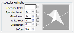

Specular Highlight group
The controls in this group affect the appearance of specular highlights. Specular highlights simulate the surface of the raytraced object reflecting the lights in the scene. Changing the color or intensity of lights in the scene can change the appearance of specular highlights.
As in standard materials, as you adjust the values in this group the highlight curve at the right changes to give you an idea of the effect. The material preview in the sample slot also updates.
- Specular Color
- Sets the specular color, assuming there are white lights in the scene.
Click the color swatch to display the Color Selector and change the highlight color.
Click the map button to assign a Specular Color map. This button is a shortcut: You can also assign a Specular Color map on the Maps rollout.
The remaining controls in the Specular Highlight group depend on the active shader, as shown next to “Shading:” at the top of this rollout. These highlight controls are the same as for the Standard material shaders.
These are the highlight controls available to Raytrace materials:
- Anisotropic highlights
- Blinn, Oren-Nayar-Blinn, and Phong highlights
Metal highlights
Note: Highlight controls that don’t pertain to the current shader are labeled “N/A.”
- Environment
- Click the button to specify an
Environment map that is local to t his Raytrace material. Both Reflect and Transparency use the scene-wide environment map unless you use this button to specify a different map. With this control, you can use different environment maps on a per-object basis, or provide an environment to specified objects when the scene as a whole has none.
This map overrides the scene-wide environment for both reflection and refraction. To override for refraction alone, see the Transparency Environment control in the Extended Parameters rollout.
Use the checkbox to turn this map on or off.
Tip: You can use any map as the Raytrace environment, including the Reflect/Refract map. The Reflect/Refract map is often adequate for getting the required look, and it usually renders more quickly than raytracing the entire scene, especially if the Raytrace material is transparent. If you are using Raytrace a material just to get the glass to look right on a car's headlight or on a light bulb hanging in the middle of a room, turn off the raytracer and use an environment map instead.The
lock button to the right locks the Environment map to the Transparency Environment map (found on the
Extended Parameters rollout). When on, the Transparency Environment map controls are disabled, and a map applied to the Raytrace Environment applies to the Transparency Environment as well. When off, the Transparency Environment map controls are enabled, and the Transparency Environment can have a different map assigned to it. Default=on.
Changing this button’s setting here also changes it on the Extended Parameters rollout and the Maps rollout.
- Bump
- Click the button to assign a
Bump map. This button is a shortcut: You can also assign a Bump map on the
Maps rollout.
Use the spinner to change the bump Amount. Use the checkbox to toggle the map.
