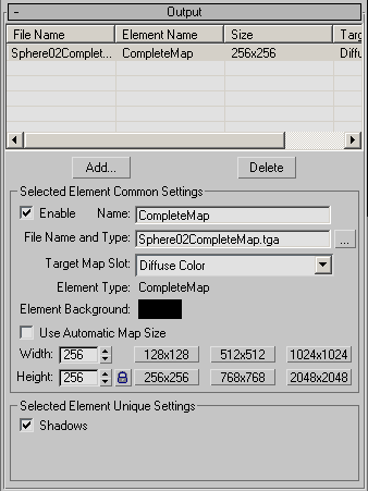

This rollout lets you specify the elements to render and their attributes.
- [output list]
- Shows maps names, element names, map sizes and designated map slots.
- File Name column Lists the name of the map that will be generated.
- Element Name column Shows the element corresponding to the map.
- Size column Displays the map size.
- Target Map Slot column Shows which map slot will be occupied by the baked texture in the material.
The output list can display entries in black, gray and blank. If a group of objects is selected that has already has output assignments, maps that are shared by all will appear black, maps not shared by all will appear gray. If resolutions or target types are shared they will appear black, if not they will be blank.
- Add
- Click to display an Add Texture Elements dialog to choose one or more element types to add to the list.
- Delete
- Click to remove the currently highlighted element from the list.
Selected Element Common Settings group
- Enable
- When on, renders this element. When off, disables rendering of this element. Default=on.
- Name
- Enter the element component of the file name. Default=the name of the element type.
- File Name and Type
- Enter the file name of the rendered texture. Default=the object name followed by the element name, and TGA format.
This field is disabled if All Selected or All Prepared is turned on on the Objects To Bake rollout.
- Click this button to display a file dialog you use to choose a name, directory, and file format for the rendered texture.
Note: The File Name and Type setting specifies the path and filename only for the selected element. To set a folder where all baked textures will be stored, set the path in the Output group on the General Settings rollout.
- Target Map Slot
- Display all Map Types available to the materials assigned to the objects selected minus the ones already slated for output in the current Render To Texture session.
If more than one object is selected the all map types common to all the selected objects will be listed. If you choose to Create New Baked, then the slots for the new baked material type will be displayed.
- Element Type
- This read-only field displays the type of element, such as CompleteMap, that you specified when you added the element.
By default, the element name is the same as its type, but you can change it using the Name field. Element Type remains constant.
- Element Background
- Lets you set the background color of the rendered output for the highlighted element.
- Use Automatic Map Size
- When on, sets the texture size automatically, using the values on the General Settings rollout. When off, the texture is the size specified by the following controls in this rollout. Default=off.
- Width/Height
- Let you specify dimensions for the texture. Range=0 to 8192. Default=256.
Note: Increasing texture resolution increases render time.
To force the texture to be square (often a requirement with real-time 3D rendering engines) click the lock button next to Height.
- Preset resolution buttons (128x128, ...)
- Click a button to specify a preset resolution for the texture.
Selected Element Unique Settings group
The contents of the Selected Element Unique Settings group vary depending on the active element. But controls for an element are always a list of toggles for various components of a scene, and by default, all toggles are on.
The following table shows which components apply to which elements (if the table shows “none,” the Selected Elements Unique settings group is empty):
| Map Type | Components |
| Complete | Shadows |
| Specular | Lighting
Shadows |
| Diffuse | Lighting
Shadows |
| Shadows | (none) |
| Lighting | Shadows
Direct Light On Indirect Light On |
| Normals | Output into Normal Bump
Render Height Map into Alpha Channel |
| Blend | Lighting
Diffuse Specular Reflection Shadows Ambient Self-Illumination Refraction |
| Alpha | (none) |
| Height | (none) |
