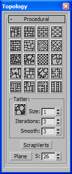

The topology tools rework an object’s mesh subdivision into procedurally generated patterns. You can apply a topology pattern over an entire surface or a selected section.
  • Ribbon > Modeling tab > Polygon Modeling panel [expansion] > Generate Topology
The various topology tools are described following. The descriptions of the tools only suggest how you can use the tools, and you can combine multiple tools to create new patterns. Try experimenting with applying a tool several times to generate a different pattern. A typical use of these tools could be to first generate a topology pattern of some sort, and then extrude or bevel different parts to form a structure.

Tatter
Generates "holes" in the topology, separated by rows of polygons.
The three numeric settings apply to Tatter only, before applying the tool.
  • Size Determines the overall size of the generated holes.
  • Iterations Determines the number of different sizes for the generated holes.
  • Smooth Determines how rounded the generated holes will be.
CUI action: TopoTatter
ScrapVerts
Removes all vertices in the mesh with two edges going from them.
CUI action: TopoScrapV
Plane
Creates a Plane object and converts it to editable poly format for quick testing of the different tools. The value of the "S" parameter determines the number of segments in the plane.
