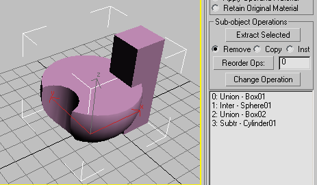

- Set Operation to Subtraction, and then click the cylinder.
The cylinder's intersecting volume is subtracted from the previous Boolean result.
Note that the entire history of operands and operations used to build the Boolean object is listed in the hierarchy view list at the bottom of the Parameters rollout. Box01 starts the Boolean with Union, Sphere01 is then incorporated with Intersection, Box02 is incorporated with Union, and finally Cylinder01 is incorporated with Subtraction.
Note: The operation for the first object in the list has no effect on the Boolean object, but if you move it to another position in the list it does. You'll see an example of this at the end of this exercise.You can use the list and the other controls in the Sub-object Operations group to change the results.

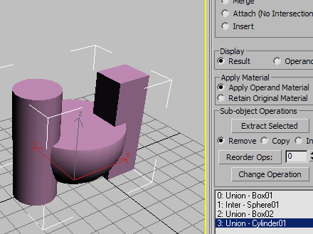

- In the list, highlight the Subtr - Cylinder01 entry, and then set Operation to Union.
- In the Sub-object Operations group, click the Change Operation button.
As a result of the change of operation, the cylinder appears in the Boolean object as an additive volume instead of a subtractive one. Also, its entry in the list changes to “Union - Cylinder01”, showing that the Boolean operation for the cylinder is now Union.
You can also change the order of the operations, which can affect the results.
- In the list, click the Union - Cylinder01 entry to remove the highlighting, and then highlight the entry 1: Inter - Sphere01.
Note that its position in the list, 1, appears in the editable field next to the Reorder Ops button.
- Change the value in the field from 1 to
3, and then click the Reorder Ops button.
The Inter - Sphere01 item jumps to the end of the list.
The Boolean object changes significantly. The new order in the list tells you how this shape was achieved: The two boxes and the cylinder were all combined with Union, adding their volumes together, and then the sphere was incorporated into that result with Intersection, leaving only the volume shared by all four objects.

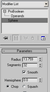

Modifier stack
With an unmodified ProBoolean object selected, the modifier stack shows a single, expandable entry: ProBoolean.
Expanding this entry (by clicking the + icon) reveals a single subsidiary branch: Operands.
To transform operands in the ProBoolean object independent of the entire object, click the Operands branch to highlight it.
You can then select one or more operands, either by using standard selection methods in the viewport, or by highlighting their names in the hierarchy view list at the bottom of the Parameters rollout.
When one, and only one, operand is selected, the object type (not its name) appears as a separate stack entry below the ProBoolean entry. Clicking this entry provides direct access to the operand's parameters on the Modify panel.

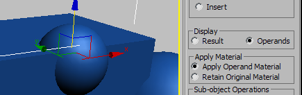

If Parameters rollout
Display is set to Result, selecting an operand displays the operand's axis tripod or transform gizmo in the viewport, although the operand itself is not visible by default.
To view the operand, set Parameters rollout
Display to Operands.
Whether or not the operands are visible, you can transform and animate them at the Operands sub-object level, as with any other object in 3ds Max.

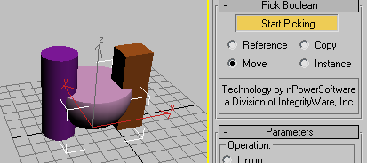

Pick Boolean rollout
- Start Picking
- Click this and then click each operand to transfer to the Boolean object in turn. Before picking each operand, you can change the Reference/Copy/Move/Instance choice, the Operation options, and the Apply Material choice.
Tip: When you're adding many operands to a Boolean object using the default settings, calculating the result each time you pick an object can slow down the process. To maintain optimum feedback, set Parameters rollout
Display to Operands. Then, when you're finished, set it back to Result. Alternatively, on the Advanced Options rollout set Update to Manually, and then click the Update button to view the results after performing the Boolean operations.
Choose a radio button to specify how the next operand you pick is transferred to the Boolean object:
- Reference The Boolean operation uses a reference to the picked operand, so the object remains after being incorporated into the Boolean object. Future modifications to the originally picked object will also modify the Boolean operation. Use Reference to synchronize modifier-induced changes to the original operand with the new operand, but not vice-versa.
- Copy The Boolean operation uses a copy of the picked operand. The selected object is unaffected by the Boolean operation, but a copy of it participates in the Boolean operation.
- Move The picked operand becomes part of the Boolean operation and is no longer available as a separate object in the scene. This is the default choice.
- Instance The Boolean operation makes an instance of the selected object. Future modifications of the selected object will also modify the instanced object participating in the Boolean operation and vice-versa.

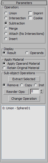

Parameters rollout
Operation group
These settings determine how the Boolean operands interact physically.
- Union
- Combines two or more separate entities into a single Boolean object.
- Intersection
- Creates a "new" object from the physical intersection between the original objects; the non-intersecting volumes are removed.
- Subtraction
- Removes the volume of a selected object from the original object.
- Merge
- Combines objects into a single object without removing any geometry. New edges are created where the objects intersect.
Note: In the following illustration, the display property Backface Cull was turned off so that all edges are visible.
Left: Original object (box) and operand (small box)
Center: Union operation; part of the smaller box is removed.
Right: Merge operation, showing new edges at intersection
- Attach
- Combines two or more separate entities into a single Boolean object without changing their topology. In essence, the operands remain separate elements within the whole.
Box and sphere primitives combined with Attach (left) and Union (right)
- Insert
- First subtracts the second operand’s bounding volume from the first, and then groups the two objects.
In effect, Insert treats the first operand as a liquid volume, so that if there’s a hole in the inserted operand or some other way for the “liquid” to enter its volume, it does. The following illustration shows examples of this effect, with shaded geometry on the left and wireframe equivalents on the right.
A bowl inserted in liquid; if the bowl has a hole in it or is tilted, the liquid enters its cavity.
Note: Insert does not simulate the displacement of liquid; the overall dimensions of the first operand remain constant. - Imprint
- Prints the outline of the shape (or intersection edges) onto the original mesh object.
Left: Original object (box) and operand (text)
Center: Standard Subtraction operation
Right: Subtraction with Imprint
Note: The result of the Imprint operation is always the same; the main Operation choice has no effect on it. - Cookie
- Cuts the faces of the original mesh shape, affecting only those faces. The faces of the selected operand are not added to the Boolean result.
1. Original object (box) and operand (sphere)
2. Standard Subtraction operation
3. Subtraction with Cookie on
4. Standard Intersection operation
5. Intersection with Cookie on
Display group
Choose one of the following display modes:
- Result Displays only the result of the Boolean operations, not the individual operands.
Choosing Result also activates the ProBoolean level in the Modifier stack.
- Operands Displays the operands that define the Boolean result. Use this mode to edit the operands and modify the result.
Choosing Operands also activates the Operands level in the Modifier stack.
Also, when picking many operands, use this mode to avoid having to recalculate the result each time, and then set Display back to Result at the end.
Apply Material group
Choose one of the following material application modes:
- Apply Operand Material New faces created by the Boolean operation acquire the material of the operand.
- Retain Original Material New faces created by the Boolean operation retain the material of the original object.
These functions operate on operands highlighted in the hierarchy view list (see following).
- Extract Selected
- Based on the chosen radio button (Remove, Copy, or Inst; see following), Extract Selected applies the operation to the highlighted operand in the hierarchy view list. Three modes of extraction are available:
- Remove Removes the operand or operands highlighted in the hierarchy view list from the Boolean result. It essentially undoes the addition of the highlighted operand(s) to the Boolean object. Each extracted operand becomes a top-level object again.
- Copy Extracts a copy of the operand or operands highlighted in the hierarchy view list. The original operand remains part of the Boolean result.
- Inst Extracts an instance of the operand or operands highlighted in the hierarchy view list. Subsequent modifications to this extracted operand also modify the original operand, thus affecting the Boolean object.
- Reorder Ops
- Changes the ordering of the highlighted operand in the hierarchy view list. The reordered operand is moved to the position listed in the text field next to the Reorder Ops button.
- Change Operation
- Changes the type of operation (see Operation group) for the highlighted operand. To change the operation type, highlight the operand in the hierarchy view, then choose the operation type radio option, and then click Change Operation.
[hierarchy view]
The hierarchy view, found at the bottom of the Parameters rollout, displays a list of all of the Boolean operations that define the selected mesh. Each time you perform a new Boolean operation, 3ds Max adds an entry to the list.
You can highlight operands for modification by clicking them in the hierarchy view list. To highlight multiple contiguous items in the list, click the first, and then Shift+click the last. To highlight multiple non-contiguous entries, use Ctrl+click. To remove highlighting from a list entry, Alt+click the highlighted item.
At the ProBoolean level in the modifier stack, you can perform only sub-object operations on highlighted items. At the Operands sub-object level, you can transform highlighted operands as well as perform sub-object operations; see Modifier Stack for details.

Planar Edge Removal group
This option determines how the polygons on planar faces are handled. Choose one of the following:
- Remove All Removes all extra coplanar edges on a face such that the face itself will define the polygon.
- Remove Only Invisible Removes invisible edges on each face.
- No Edge Removal No edges are removed.
