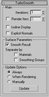

Interface
Main group
Lets you set the basic parameters for TurboSmooth.
- Iterations
Sets the number of times the mesh is subdivided. When you increase this value, each new iteration subdivides the mesh by creating smoothly interpolated vertices for every vertex, edge, and face from the iteration before. The modifier then subdivides the faces to use these new vertices. Default=1. Range=0 to 10.
From right to left, effect of increasing the number of iterations
Note: Be cautious when increasing the number of iterations. The number of vertices and faces in an object (and thus the calculation time) can increase as much as four times for each iteration. Applying four iterations to even a moderately complex object can take a long time to calculate. - Render Iter[ation]s
- Lets you choose a different number of smoothing iterations to be applied to the object at render time. Turn on Render Iters, and then use the field to its right to set the number of render iterations.
- Isoline Display
- When on, 3ds Max displays only isolines: the object's original edges, before smoothing. The benefit of using this option is a less cluttered display. When off, 3ds Max displays all faces added by TurboSmooth; thus, higher Iterations values result in a greater number of lines. Default=off. Warning: If you're going to collapse the model or apply further modifiers after the TurboSmooth, you should first turn off Isoline Display. Unlike in MeshSmooth, isoline display is achieved by making all the edges "invisible," joining large groups of faces together in single "polygons." This can be especially problematic if you apply a PolyObject-based modifier afterwards, because all vertices in the interior of these "polygons" will be lost.
- Explicit Normals
- Lets the TurboSmooth modifier compute normals for its output, which is faster than the standard method 3ds Max uses to compute normals from the mesh object's smoothing groups. Default=off.
Consequently, if the TurboSmooth result is used directly for display or rendering, it will generally be faster with this option turned on. Also, the quality of the normals will be slightly higher. However, if you apply any topology-affecting modifiers, such as Edit Mesh, above the TurboSmooth modifier, these normals will be lost and new ones computed, potentially affecting performance adversely. So it's important to remember to turn on Explicit Normals only if no modifiers change the object topology after TurboSmooth takes effect.
Surface Parameters group
Lets you apply smoothing groups to the object and restrict the smoothing effect by surface properties.
- Smooth Result
- Applies the same smoothing group to all faces.
- Separate by Materials
- Prevents the creation of new faces for edges between faces that do not share Material IDs.
- Separate by Smoothing Groups
- Prevents the creation of new faces at edges between faces that don't share at least one smoothing group.
Update Options group
Sets manual or render-time update options, for situations where the complexity of the smoothed object is too high for automatic updates. Note that you can also set a greater degree of smoothing to be applied only at render time, in the Main group.
- Always Updates the object automatically whenever you change any TurboSmooth settings.
- When Rendering Updates the viewport display of the object only at render time.
- Manually Updates the object only when you click Update.
- Update
Updates the object in the viewport to match the current TurboSmooth settings. Works only when you choose When Rendering or Manually.
