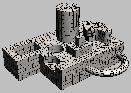

ProBoolean of an object containing several primitives
To make a quadrilateral mesh, apply the Quadify Mesh modifier, or select a ProBoolean or ProCutter object, go to the Modify panel, and expand the Advanced Options panel as shown following.
To get a result similar to the following illustration, turn on Make Quadrilaterals checkbox:
Result of a quad mesh with Quad Size %=3.0

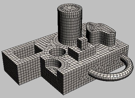

To change the size of the individual quadrilaterals, adjust the Quad Size % parameter. Typically a value between 1 and 4 percent achieves the desired results. The smaller the quad size, the smaller the resulting fillets or blends between the surfaces when the mesh is smoothed. The default Quad Size value is 3.0 percent. A Quad Size value of 2.0 percent produces the following result:
Quad meshing with Quad Size %=2.0

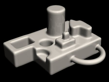

If you know that you have the desired result and don't plan to go back and change the quad size or the original primitives, you can convert the object to Editable Poly format and apply smoothing with the Subdivision Surface settings. If this is not the case, however, and you plan to make further adjustments, use the MeshSmooth or TurboSmooth modifier to retain the history of the ProBoolean object. The following illustration shows the result of a MeshSmooth modifier with Subdivision Amount
Iterations=1 applied to a ProBoolean object with Quad Size % set to 3.0.
MeshSmooth modifier with NURMS and Iterations=1
Rendered image after MeshSmooth modifier applied

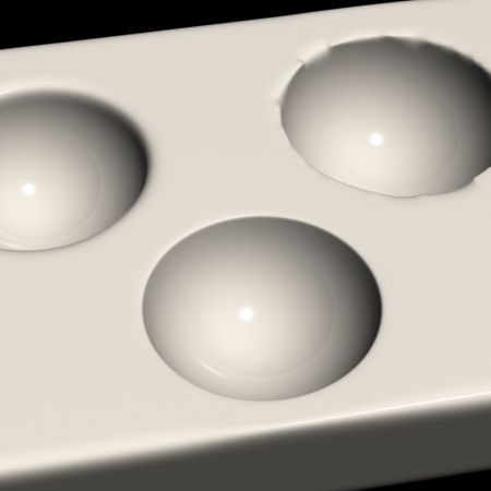

The following illustration shows the result of subtracting three spheres of the same size from a box. The left-hand sphere is aligned properly so that there are good quads along both boundaries. This should produce a good result when smoothed. The middle sphere was lifted so that there is a strip of very thin quads near the boundary. This produces very little smoothing along that edge, as you can see in the rendered image. The right-hand sphere was rotated, producing poor alignment and many triangles on the sphere as well as small quads on the plane of the box. You can see the undesirable results in the rendered image.
Quads produced by three spheres with different rotations and translations
Rendered image of smoothed three-sphere example
