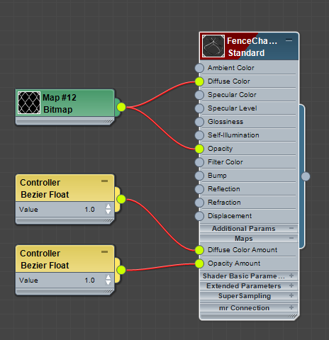

When you map the components of a Standard material, the Slate Material Editor automatically adds appropriate controller nodes. For example, when you wire a Bitmap to the material’s Diffuse Color component, a Bezier Float controller for the Diffuse Color Amount parameter is also present. To see these controllers, you need to display the Additional Parameters (right-click the material node, then choose Show All Additional Params).
Controller nodes wired to (nonmappable) scalar parameters

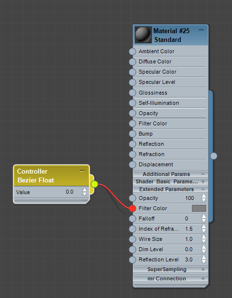

When you wire nodes, and the input socket you choose isn’t appropriate for the output being wired, 3ds Max displays the socket in red and doesn’t complete the wiring. This can happen with maps as well, but it happens more often for controllers. In the illustration, for example, the controller generates a single scalar value, so you can’t use it to control a three-value setting such as a color.
Attempting to wire a 1-value output to a 3-value input
