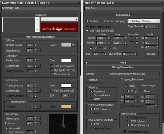

Materials and maps have various parameters you can adjust. To see the parameters for a material or a map, double-click the node. The parameters appear in the Parameter Editor.
The parameters appear on rollouts in the Parameter Editor.
Left: Controls for a material node in the Parameter Editor
Right: Controls for a Bitmap node in the Parameter Editor

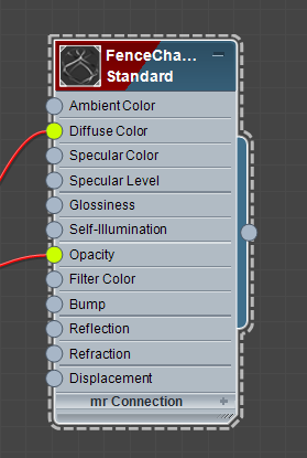

Another way to see the parameters of a child node is to double-click the input socket to which the child node is wired.
While a node's parameters are displayed in the Parameter Editor, in the active View it appears with a dashed border.
Highlight for a node displayed in the Parameter Editor
