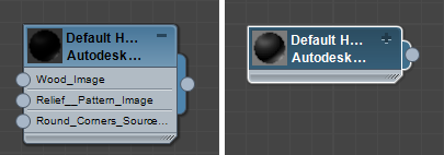

You can collapse a node to hide its slots, or expand it to show the slots. You can also resize a node horizontally, so the slot names are easier to read.
Node display controls
1. Collapse/expand the node.
2. Resize the node.
Left: An expanded node (the expand/collapse icon is a minus sign)
Right: The same node after collapsing it (the expand/collapse icon changes to a plus sign)
Right: The same node after resizing it by dragging the resize icon

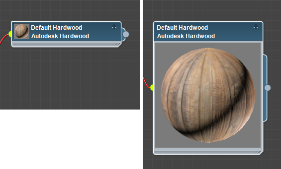

You can enlarge the preview in a node’s title bar by double-clicking the preview. To reduce the preview, double-click the preview again.
Left: A node with the default preview size
Right: The preview has been enlarged by double-clicking it. (A second double-click returns to the small size.)
