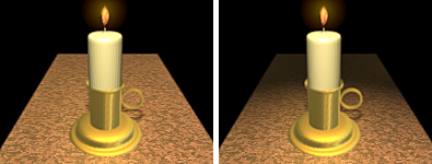

Attenuation settings cause distant objects to be dimmer.
Attenuation is the effect of light diminishing over distance. In 3ds Max, you can set attenuation values explicitly. The effects can vary from real-world lights, giving you more direct control over how lights fade in or fade out.
Note: With no attenuation, an object can paradoxically appear to grow brighter as it moves away from the light source. This is because the angle of incidence more closely approaches 0 degrees for more of the object's faces.

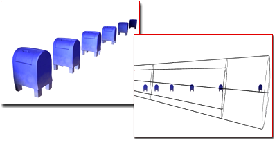

Adding attenuation to a scene
When Use is set for Near attenuation, the light value remains at zero up to the distance specified by Start. From Start to the distance specified by End, its value increases. Beyond End, the light remains at the value specified by the color and multiplier controls, unless far attenuation is also active.
You can't set the Near and Far attenuation distances so they overlap.
