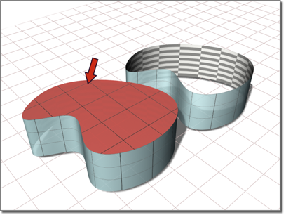

To create a cap surface:
- In the NURBS toolbox, turn on
(Create Cap Surface). - Move the mouse over the closed curve or the closed edge of a closed surface.
If the cap can be created, the curve or edge is highlighted in blue.
- Click the highlighted curve or edge.
The Flip Normals control lets you flip the surface normals at creation time. (After creation, you can flip normals using controls on the Surface Common rollout.)
