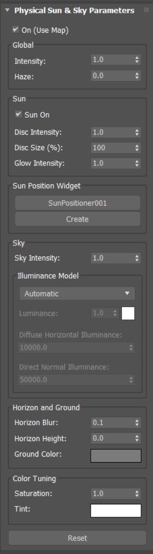

The Physical Sun and Sky Parameters Rollout sets parameters on the Physical Sun & Sky environment map. This is the same rollout as displayed for the Physical Sun & Sky environment map in the Slate Material Editor.
On
Specifies whether to use the environment map.
Global
Intensity
A multiplier for the combined sun and sky intensity.
Haze
The haze value.
Sun
Sun On
Turns the sun on or off.
Disc Intensity
Sets the intensity of the sun.
Disc Size
Sets the size of the sun.
Glow Intensity
Sets the intensity of the sun's glow.
Sun Position Widget
[SunPositionerNNN]
Selectors appear in this section for sun positioners in the scene, with an additional button for creating a new sun positioner.
Sky
Sky Intensity
Sets the intensity of the sky.
Illuminance Model
Allows you to select the model to use, where the default is Automatic. The Pysical and Measured models allow you to set additional parameters.
Horizon and Ground
Horizon Blur
Sets the blur amount applied to the horizon.
Horizon Height
Sets the height of the horizon.
Ground Color
Sets the color of the ground.
Color Tuning
Saturation
Sets the amount of colour saturation, with values above 1 increasing saturation and values below 1 decreasing it.
Tint
Sets a tint value to apply to the color.
